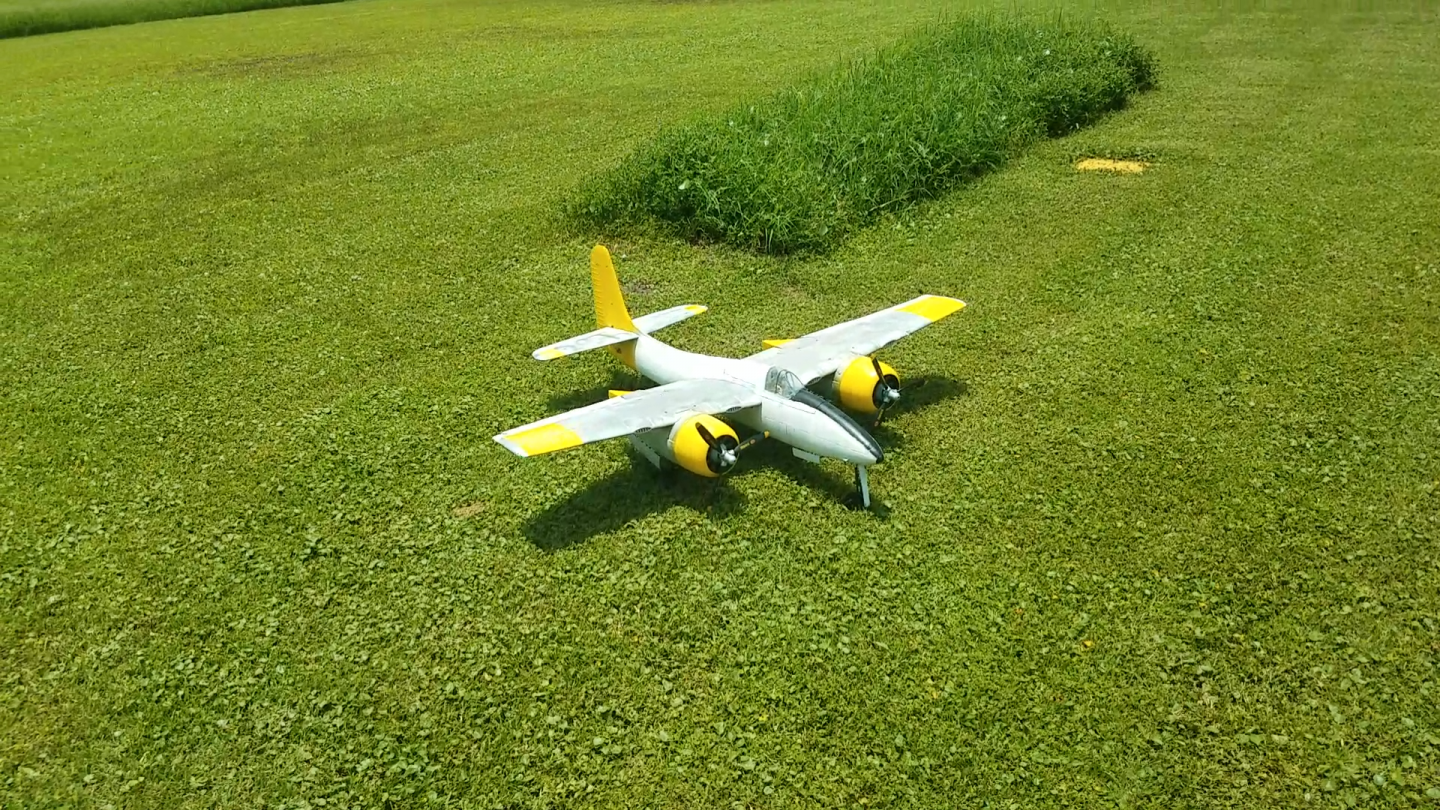

                      Despite the heat and humidity I got six flights on the FLRC Tigercat. This is a sweet flying plane!
