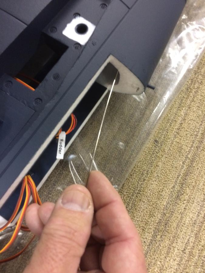

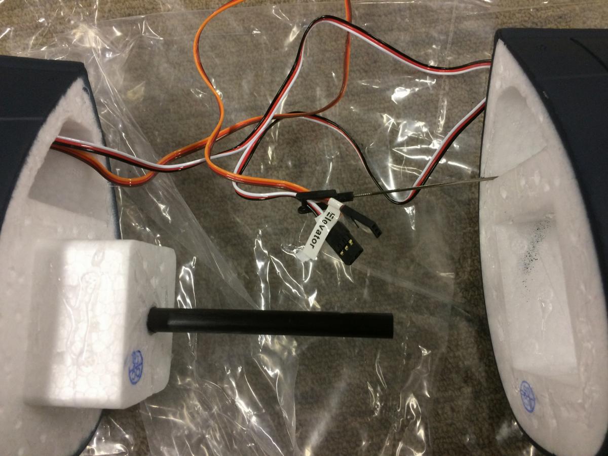

        ...I used a control rod to pull the rear servo wires through the fuse.
