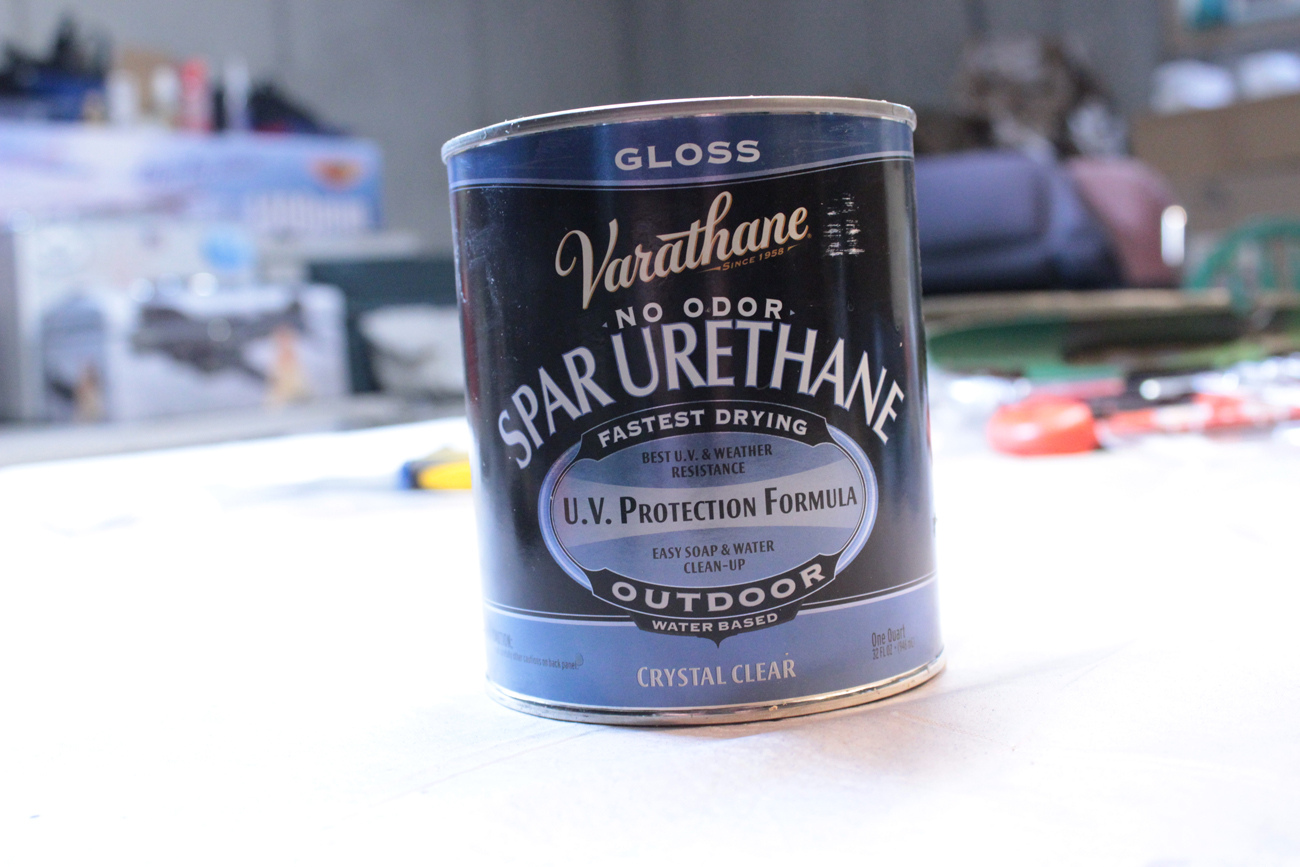

    I found the Varathane didn't take as many coats.  I put new wings on my F/W Mustang and one coat of Varathane covered as well as 4 coats of Mnwax, plus the Varathane has a UV protectant in it as well
