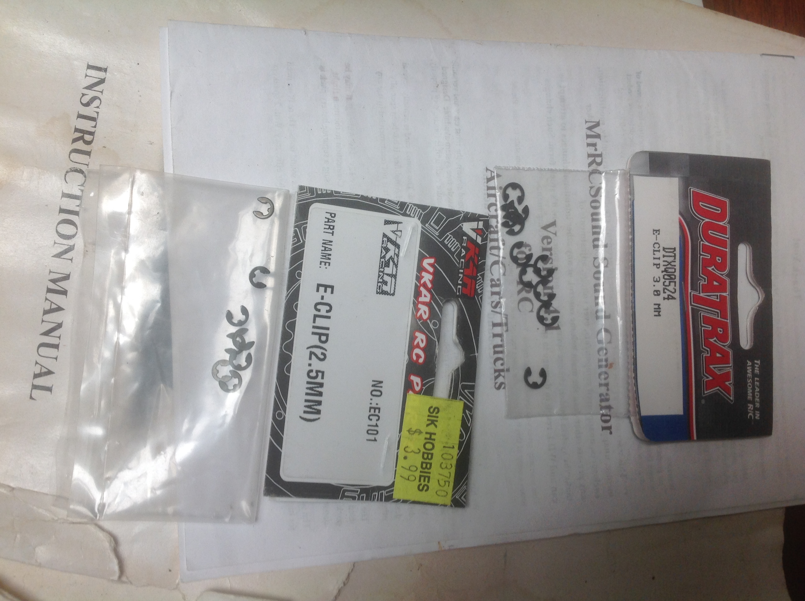

                            • hello guys, i have a quick question. I have the BBD V8 mustang, and the other day i came in for a landing and the wheel assembly came off. Apparently there is suppose to be a set screw in there to keep it from coming apart and i had no clue.....any tips?
                              • Originally posted by heliboy View Post
                                Compare it to the other side to see what's gone missing. It's likely that it's the set screw that acts as a guide for the suspension to slide along and to prevent the suspension from coming apart. You can use the one from the good side to get another set screw to match it. When you put it back in, use a little Loctite on the threads only. If you can't find a similar screw from your LHS or from Home Depot, then you'll have to buy a complete retract strut.
                                • Or, if you are just talking about the wheel itself, it's held on with an e-clip. You can get these at any hardware store. I think (I'm not 100%), but I think it's the 3mm ones you need. Could be 2.5mm, it's one of these two anyway. You can get a box of assorted sizes for a few dollars, but better to pull one off the other wheel and get a packet of the size you need. If you fly off grass, chances are one day a eclip will come off.
                                  Edit: just checked my flight box, I've got both 2.5mm and 3mm in there, (probably because I wasn't sure what size so bought both, but it's the 2.5mm that's opened so I'm going with 2.5mm). If it's not just the wheel, likely is the screw in the strut that viper is talking about. Hope it helps. :)
