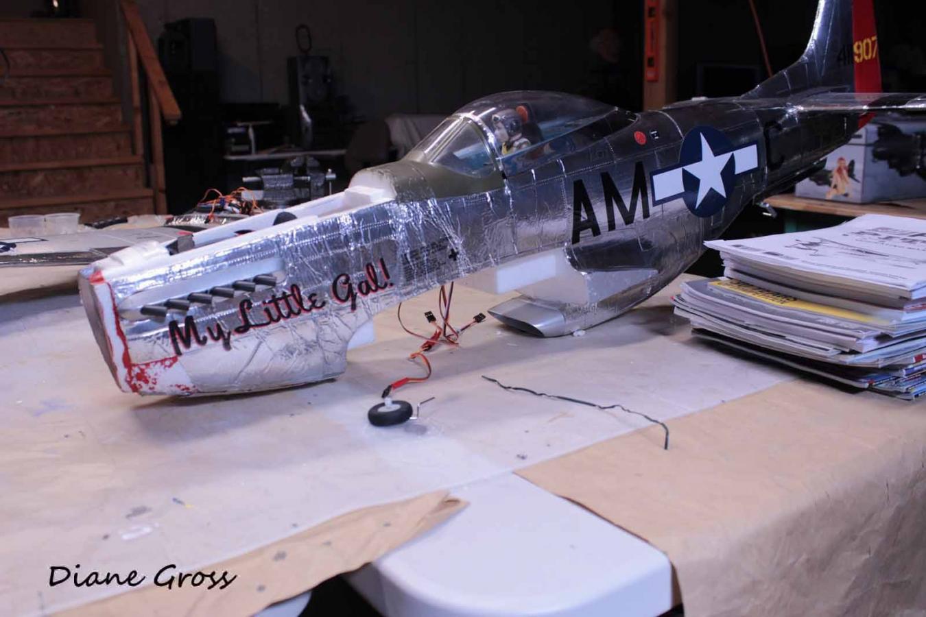

                    Nothing says challenging like rebuilding a crashed bird, I've done it before...…
                    Click image for larger version  Name:	IMG_4046.JPG Views:	0 Size:	118.0 KB ID:	189873
                    And I can do it again!!

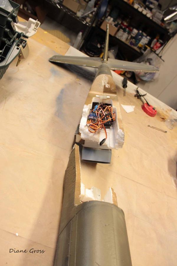

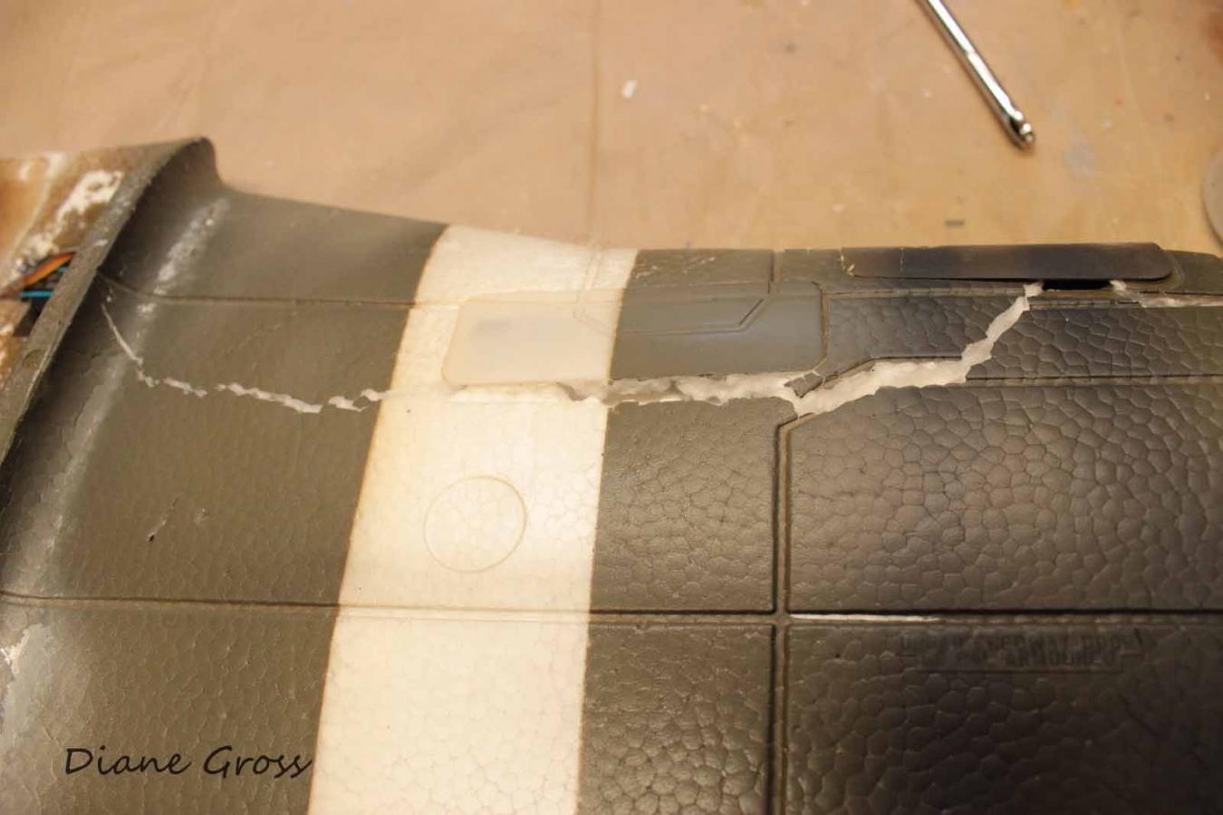

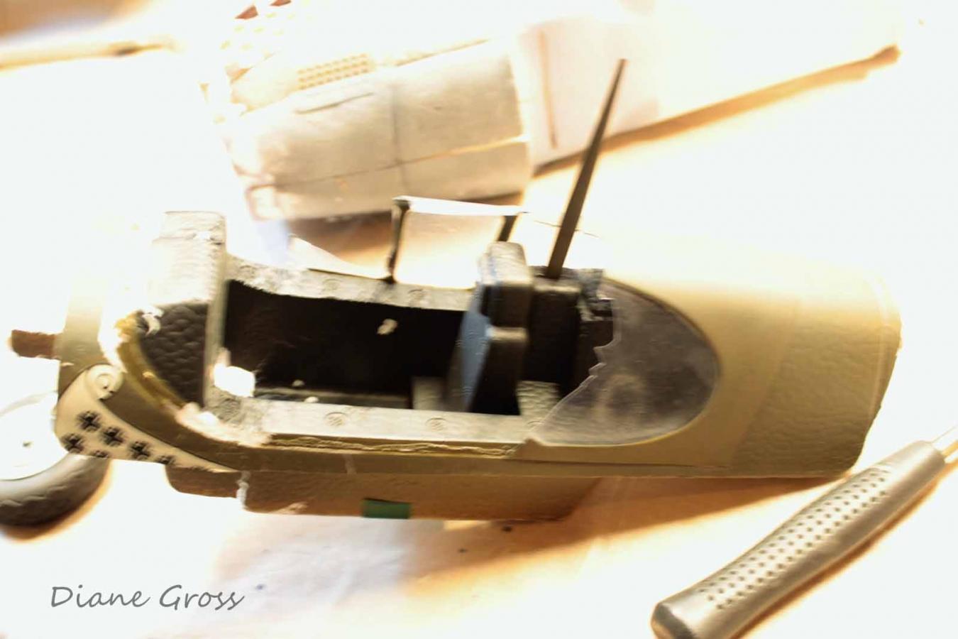

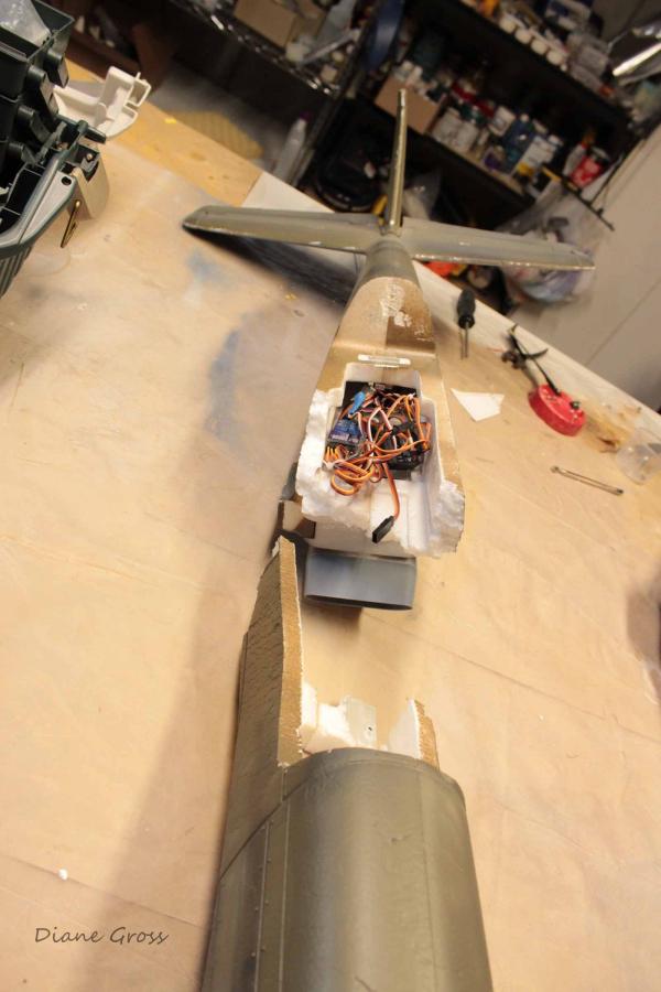

                    Assessing the damage, I found that there isn't a whole lot of damage, other than the split fuse...
                    Click image for larger version  Name:	IMG_4309.JPG Views:	0 Size:	54.8 KB ID:	189874
                    and believe it or not, it was a clean break. The nose came through with some compression wrinkles and some splits along the factory glue line, no big deal...…
                    Click image for larger version  Name:	IMG_4315.JPG Views:	0 Size:	96.2 KB ID:	189875

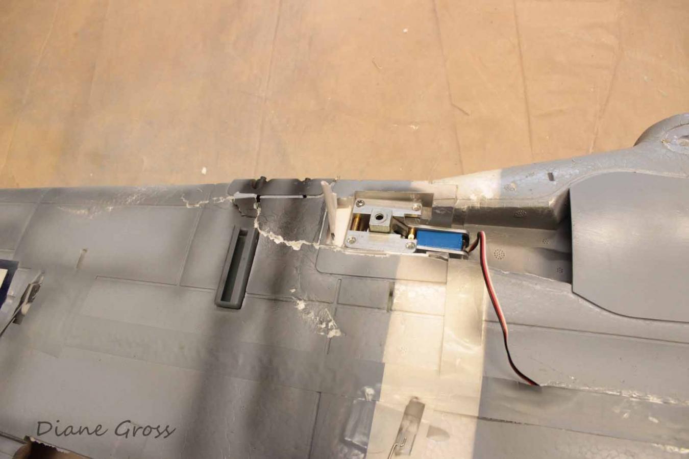

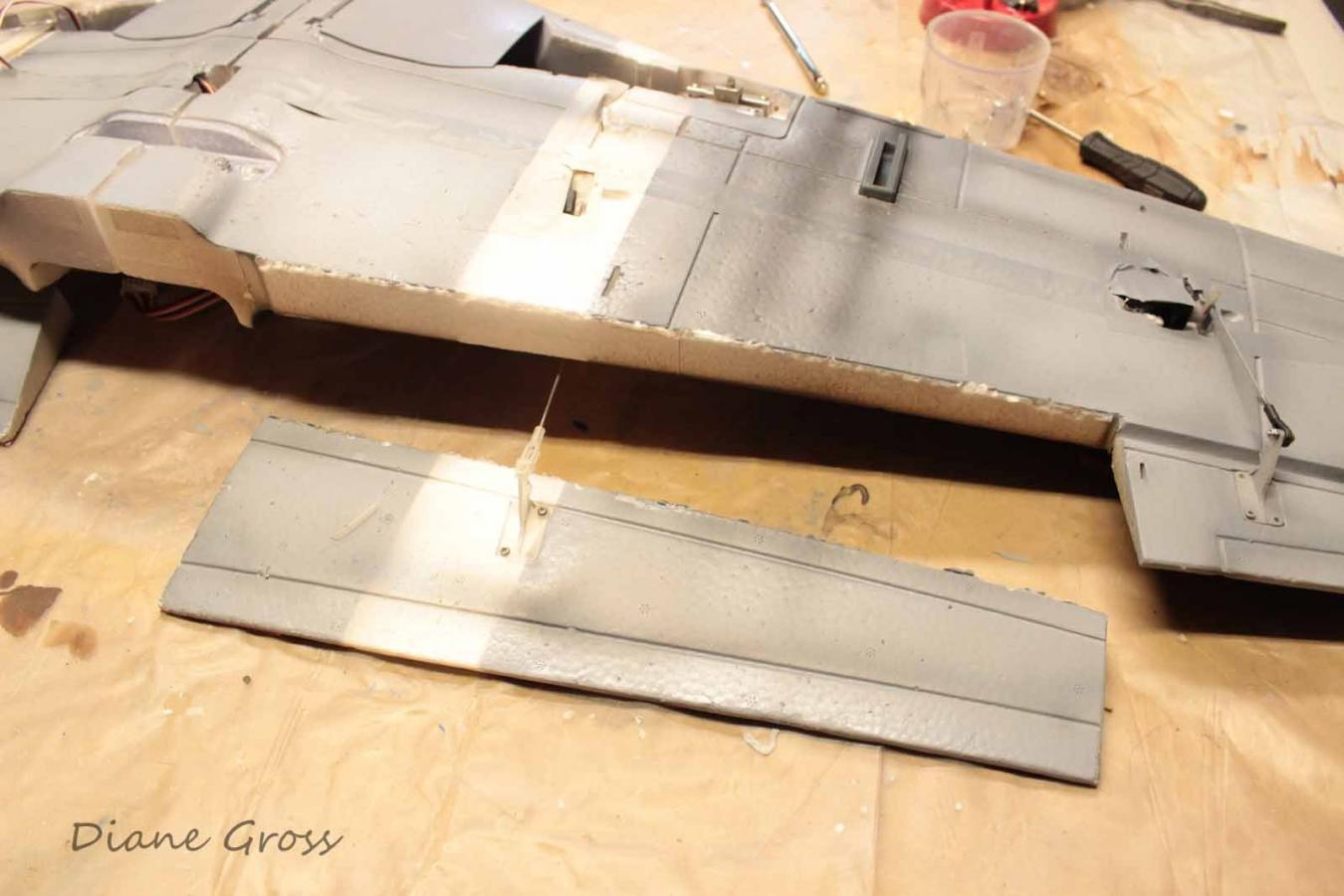

                    The wings sustained some damage on the starboard side but the port wing came through in good shape....
                    Click image for larger version  Name:	IMG_4308.JPG Views:	0 Size:	137.6 KB ID:	189876Click image for larger version  Name:	IMG_4310.JPG Views:	0 Size:	80.1 KB ID:	189877Click image for larger version  Name:	IMG_4312.JPG Views:	0 Size:	99.8 KB ID:	189878Click image for larger version  Name:	IMG_4313.JPG Views:	0 Size:	93.8 KB ID:	189879
                    So, all in all, she could very well see the air again :Cool::Cool::Cool:
                    I may have to order some graphics from Callie to match up the nose art that will have to be removed, but short of a few new parts and a lot of Foam-Tac, some body putty and some sanding and painting, she should be good. I'll run all the servos through the tester to ensure there's nothing wrong there and I'll replace the retracts if needed. Note: the Small Parts CNC retract sides lived up to their reputation!!

                      You know what the hardest thing to find will be??
                      The canopy..
ID:	189881 So if anyone has one laying around, let me know if you want to sell it.

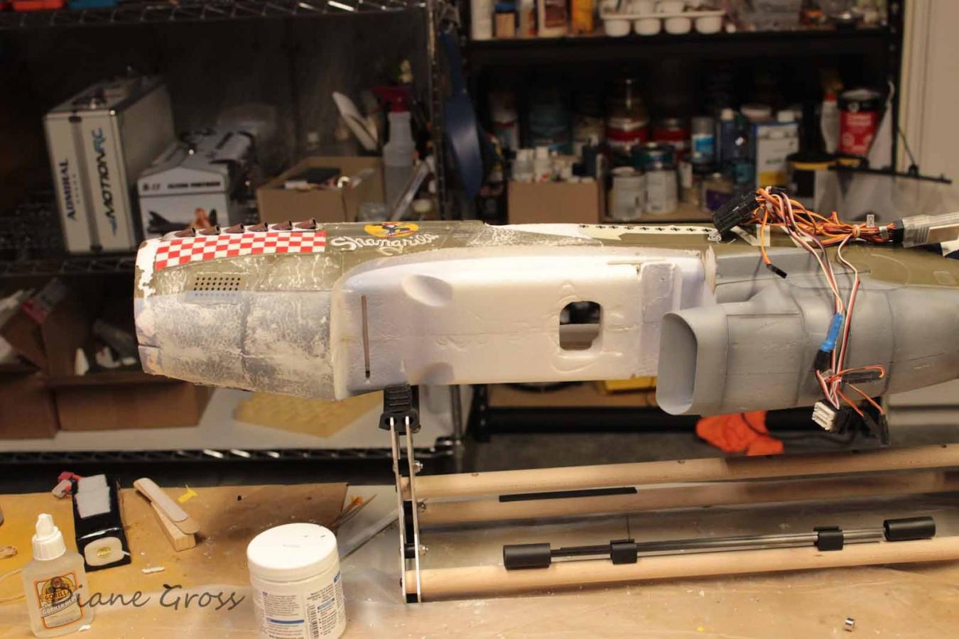

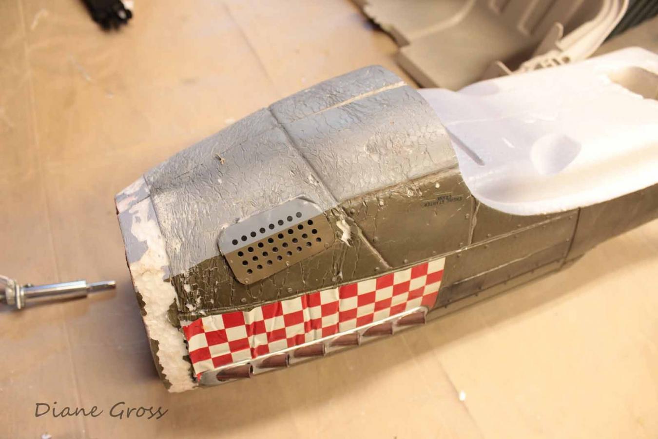

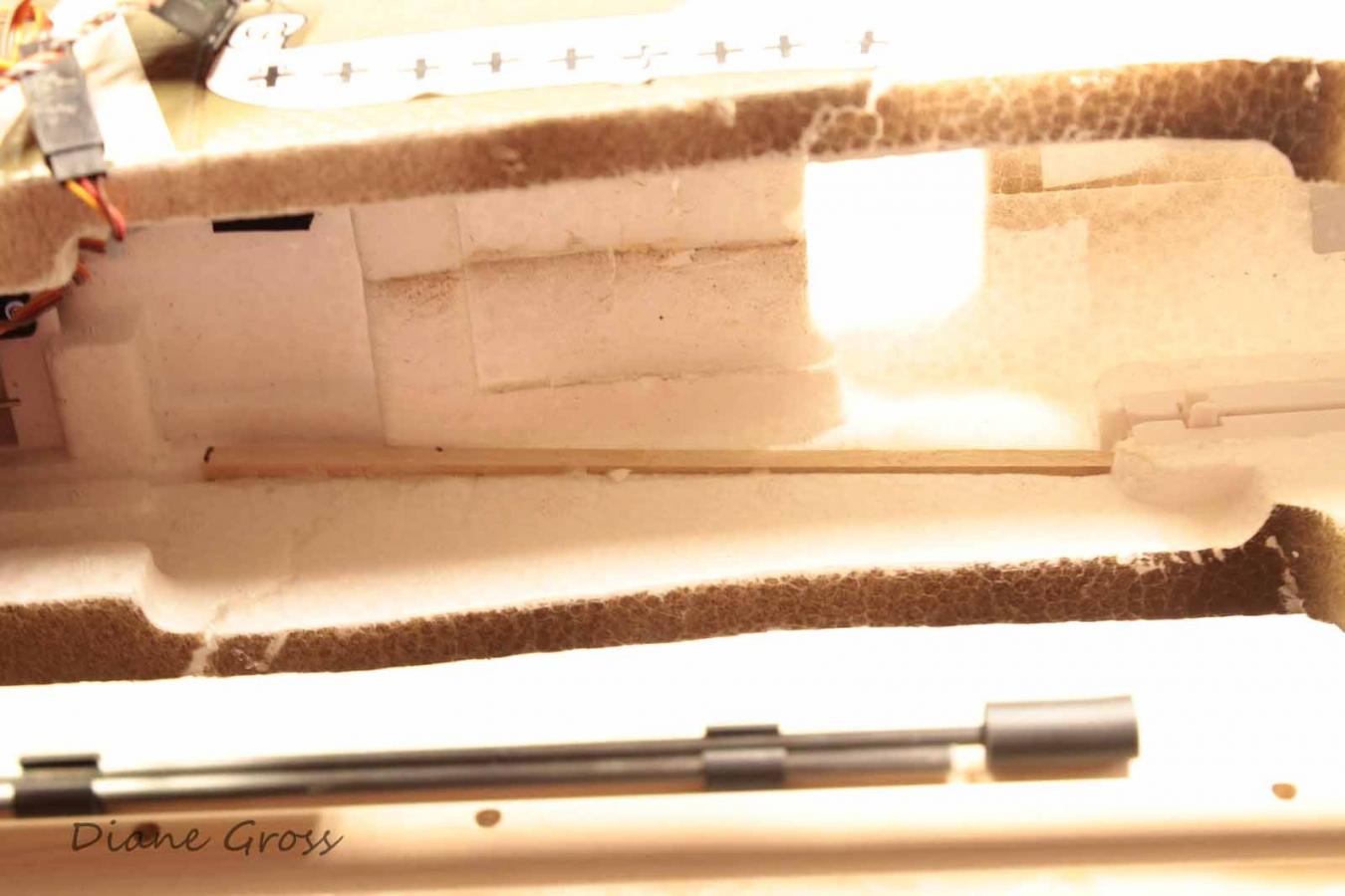

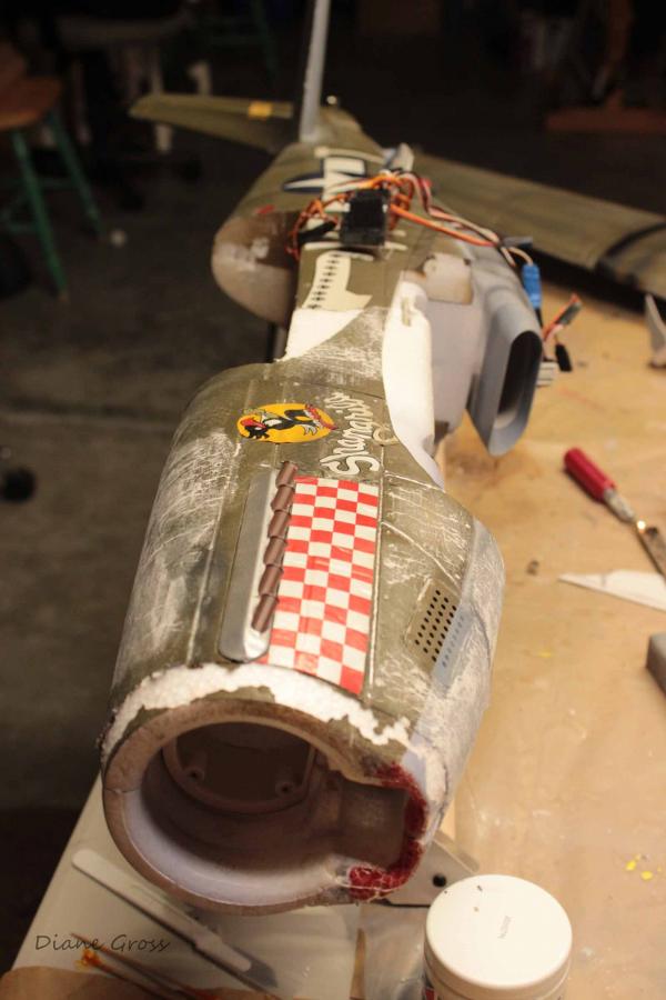

                                  Update on Shangrila, fuselage and wing repair started and filling on the nose started. The Fuselage is now one piece again and the wing crack is, at present drying while in traction.
                                  There is a convenient slot on either side of the fuse that I took full advantage of by running a square piece of balsa through, helping to connect both sides, this combined with liberal amounts of Foam-Tac produced an almost perfect remate.
                                  Click image for larger version  Name:	IMG_4321.JPG Views:	0 Size:	89.4 KB ID:	190829Click image for larger version  Name:	IMG_4322.JPG Views:	0 Size:	125.0 KB ID:	190830
                                  Also, what is handy, for all you Denny's burger fans, is to keep the skewer sticks, they can be run into one piece and through to the other, which really helps to hold the piece together, afterwards, you have the option of either removing them or sawing the end off flush and leaving them in.
                                  So, we went from this
                                  Click image for larger version  Name:	IMG_4309.JPG Views:	0 Size:	55.0 KB ID:	190831
                                  To this
                                  Click image for larger version  Name:	IMG_4323.JPG Views:	0 Size:	55.2 KB ID:	190832

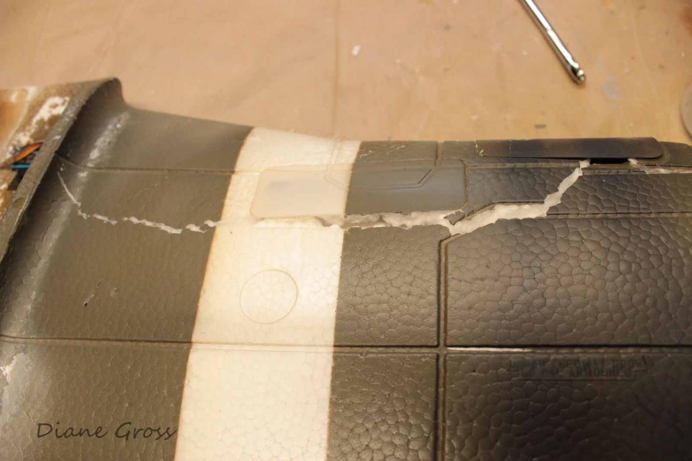

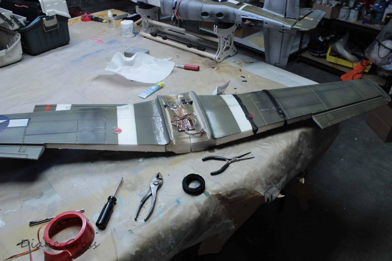

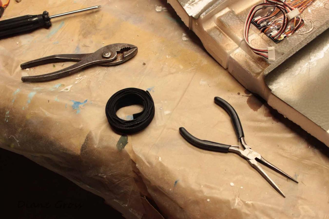

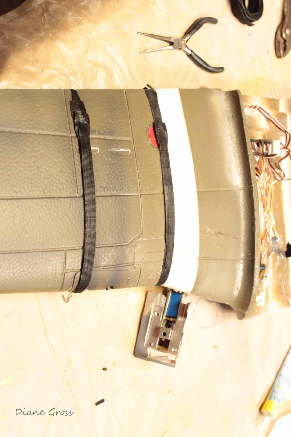

                                  The wings had a major crack on the port side, if you recall, so I utilized Velcro straps that I picked up from Wallyworld. These are so much better than trying to use elastic bands as they come in a roll and you simply break them off at whatever length you need. Being Velcro, you can tighten them up to whatever tension you want, no more trying to find the proper elastic band size.
                                  So, we went from this...
                                  Click image for larger version  Name:	IMG_4313.JPG Views:	0 Size:	94.1 KB ID:	190833
                                  To this...
                                  Click image for larger version  Name:	IMG_4324.JPG Views:	0 Size:	59.3 KB ID:	190834Click image for larger version  Name:	IMG_4332.JPG Views:	0 Size:	117.2 KB ID:	190836Click image for larger version  Name:	IMG_4325.JPG Views:	0 Size:	120.6 KB ID:	190835
                                  So now I'm at the stage where I can sit back and let her dry for a day and start some more body work. Right now the nose is ready for a light coat of paint to see where it may need some more sanding, but it feels pretty good. The only thing that hasn't arrived yet is the new battery hatch which is the only piece I've replaced, not counting the 10 channel Lemon receiver that I'm swapping out so I can have the gyro gain on the roller knob. As for the gyro, its getting glued in this time, but I plan to fly without it if the winds are down. So far so good

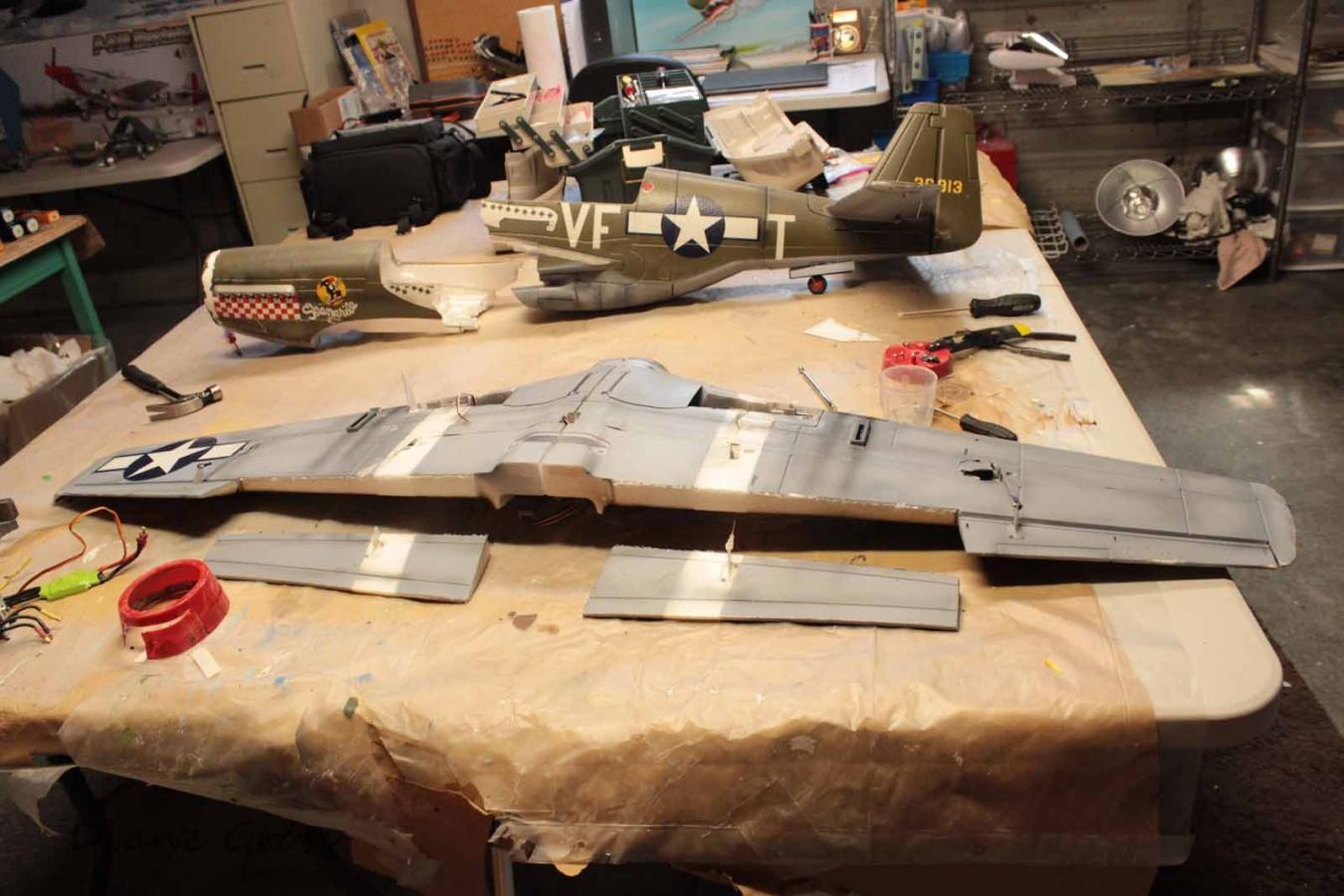

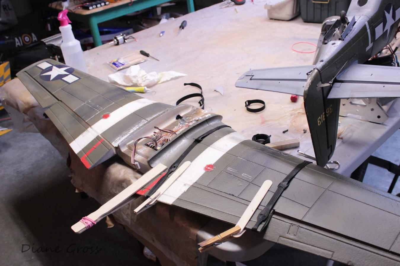

                                        Flaps are on!
                                        Came up with a way to center them onto the wing, it's undoubtedly not a new method, but its a great method...
                                        popsicle sticks under and over the wing and I also made good use of the stir sticks you get with every can of paint, worked great!
