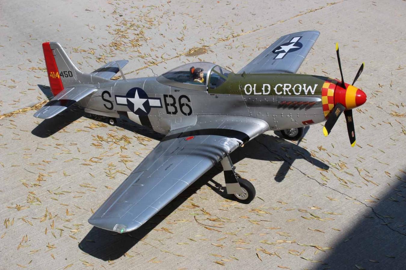

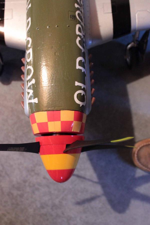

                                Regarding the Gap from the spinner to the fuse, here's the before and after on Old Crow...
ID:	185068Click image for larger version
                                Makes a big difference if your looking for the scale look.
