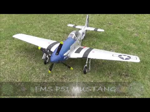

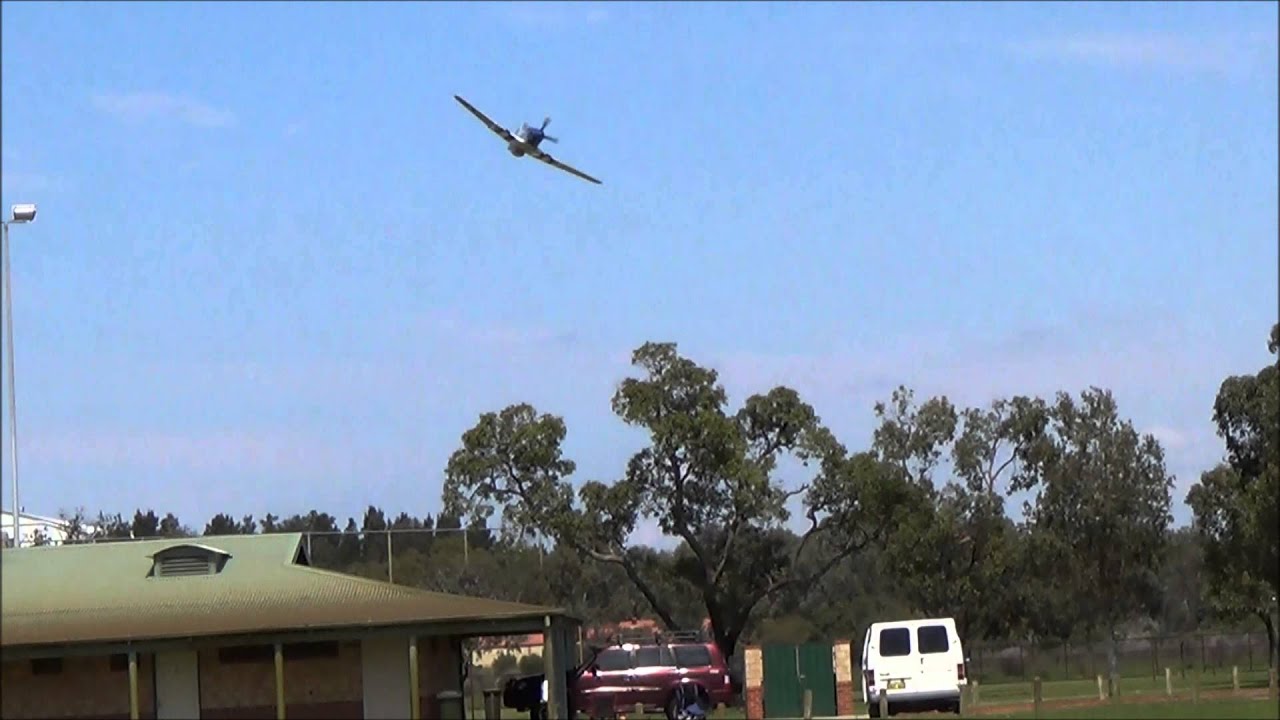

                            • Time for a bit more viewing entertainment. ;) Part 2 of the petie in stock form.
