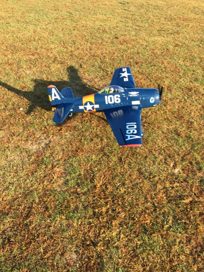

          The airplane is the famous "Ding Hao!', shown here when she still had the stock canopy. I would love to see a line of airplanes depicted in the CMH recipients colors, it would be a cool tribute.
            version 6, wow, that's a keeper in that its probably getting rare!
            Mine is a V-8. I didn't glue the wings together but in hindsight it's probably a good idea although if you have to replace a servo, it may be easier if you can pull the wings apart, can't remember, it's been a while since I had mine apart. Mine has the stock wing setup and I have never had any problems (touch wood) with just the stock carbon fiber rod. After the first year, I replaced all the control surface servos (except the rudder) with metal gear servos and did the power upgrade to a 580, it was a bit better so I eventually went the 650kv when it came out with the P-40 and that was a great match. Since then, I've flown her for 5 years and never a lick of trouble doing sport aerobatics. I did lose my P-51B after the major rebuild, but she just didn't feel right and I suspect something in the wiring as she just wasn't happy in the air as she used to be. Still hoping for a Freewing P-51B with a Malcom hood, maybe in the colors of Major James Howard, CMH winner as well as ex Flying Tiger member
