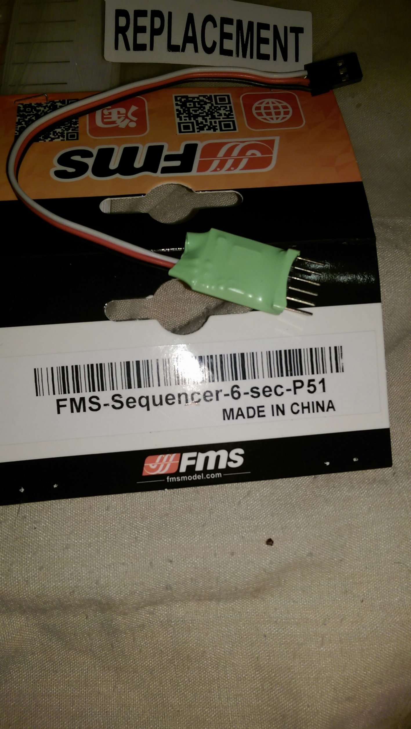

    Thank-you OV10 for jumping in on this. I have taken pictures of the sequencers that I have. The blue one came in the plane. It is the one that cycles the doors only. The light green one is the one I ordered for a spare. The picture is taken on the original package it came in. It is also the one that does nothing. Matt had sent me the wing connection board thinking that there could be solder flash somewhere in the board causing the problem. After installing the board the retracts operated fine that evening. I put everything up because it was getting late and have not been able to get back to it until recently. I powered the plane up to make sure the servos were still centered so I could finish the plane and tried the retracts and it was doing the same thing it was doing before the board replacement. The plane had set for almost a month with no one touching it. I really hope you can lead me in the right direction. Thank-you again.
