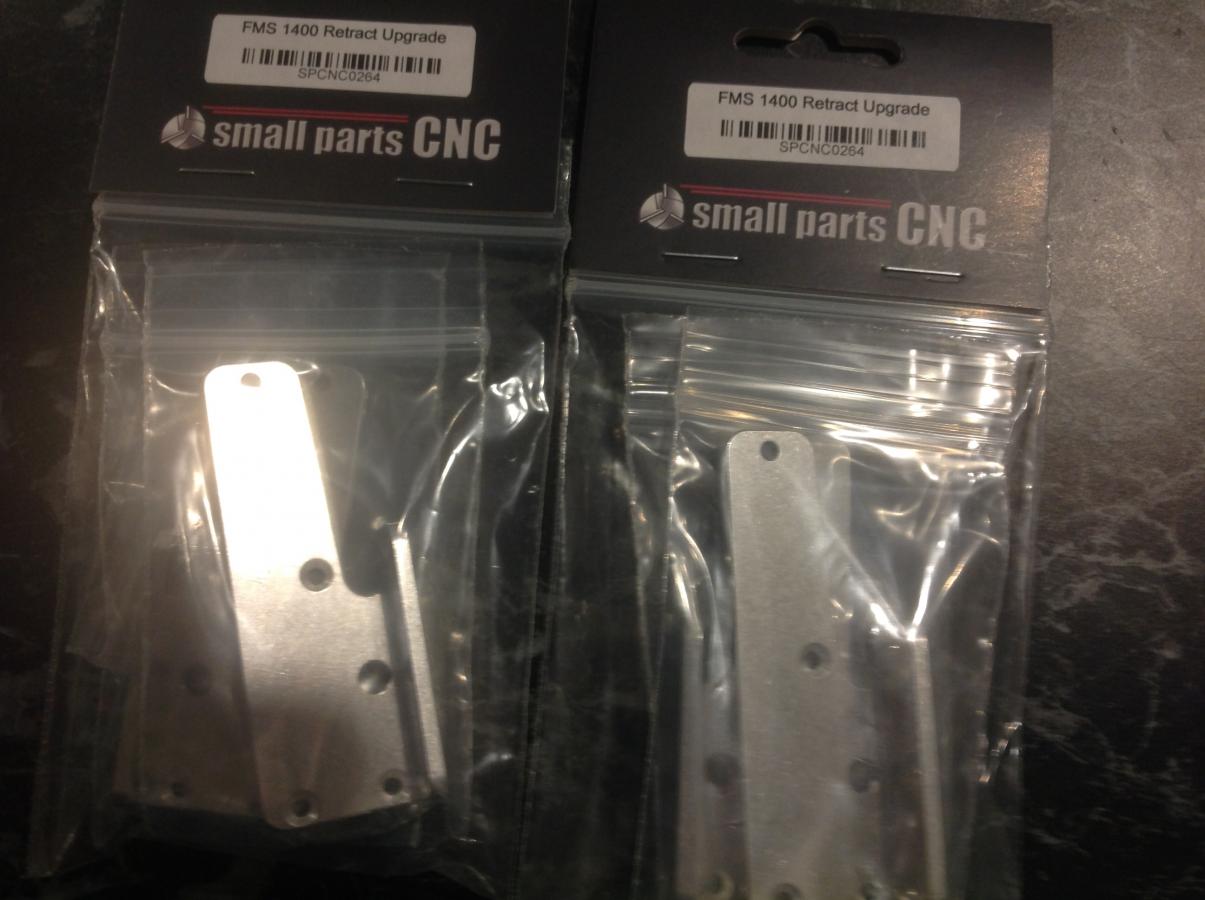

    Agreed. The cnc plates are worthwhile. My Dallas darling has them, but they wouldn't fit in my petie D model because the retracts are different. (All fms gear, don't know why the petie has a different type, they were bought only a few months apart two years ago). Whilst I haven't cracked the sides on the D, I'd still fit them if my retracts would take them. For a few dollars, it's a bit of good insurance. I bought a whole heap of them thinking I coukd put them in my corsair, 190 and zero as well, but they only fit the mustang retracts so I've got a few spare if I get another mustang ;)
    Click image for larger version Name:	IMG_0963.JPG Views:	1 Size:	91.2 KB ID:	67224
    You know he makes the 90 degree rotation plates for the Corsair/Warhawk and any of us(like me) that has the discontinued Hellcat with the 004 retract mod
    I have not seen the need to do an en masse replace of the trunion's. As they wear in the u-fork area and start to get unacceptable play is when I'll replace one. Have a couple that are getting to that stage.

    I can comment on the CNC side plates cause I'm the one that introduced both of the styles to this forum.
    Primary reason for getting the plates is for longevity. No matter how good a pilot you are on landings there is always the lateral stresses induced to the dog ear mounting tabs where they sooner or later fracture at the 90 degree bend and or the metal pivot pin on the trunion pulls out of the plastic side plate hole. All my FMS retracts have been upgraded with the CNC Small Parts side plates and have not had a single issue in 2+ years.
    Regarding the 4mm "malleable" strut pin, it is actually not a bad weak link with regards to bending before tearing up the plastic framed retract.
    Your decision on investing on an upgrade of metal sideplates/hardened strut pin for longevity is a gonna come down to how long you want to deal with the marginal strength of a stock retract and it's subsequent frustration of frequent tweaking.
    Hope I've given you a reasonable foundation to consider about using these excellent aluminum parts from Small Parts CNC.
    Some good points, OV. Side plates it is. What about the CNC trunion kit. Have you used that or do you think it is necessary?
