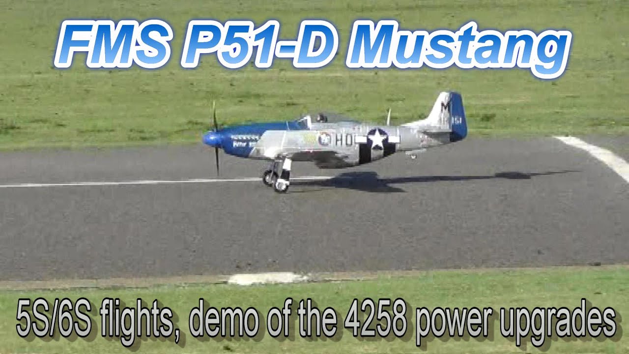

          After talking to my buddy about the mods he made to his plane I will be doing the following. There used to be a larger 550kv motor in the larger birds. The larger diameter will not only help with torque but the rpms will be slightly higher since it is easier for it to spin. He did this mod with his Snoots Sniper and it is a rocket ship. The draw is low too which I like!. Bigger motor also means slightly more nose heavy which I prefer as well. I will add the zip tie mod if needed after this but I think it will work just fine.... Let me find the video...
          If you are talking the 4258-550kv, it's from the fms Olympus. Myself, licobra and xviper were the first to do it several years ago, and it's basically a drop in fit. Note if you're going to run 4s, you're better off with the 650kv. The 550kv is designed for 5s and 6s.

              Hey mate.
              Yes, it's the stock prop. Ive done nothing to stop it blowing apart. There was only 4 guys who reported on the rcg thread their prop couldn't handle the extra rpms, though whether they had a unbalanced prop, or had a previous ground strike etc and whether that contributed to the prop exploding, no one knows for sure.
              I've done this conversion on the fw 190, my Dallas darling and both peties. Just on the three Mustangs, I've got well over 500 flights on this set up, as I did this conversion 3 years ago. Watt tests by myself and a couple of others early on, showed the 4258 on 4s, actually puts out less power than the stock 540kv, or the 580kv. (No zip tie mod),but less amp draw obviously. Hence me saying it's not really worth it on 4s, as it's less power AND more weight. (Though the prop mod might make up a bit of this lack of watts, I don't know, I never tested the prop mod).

                  #748
                  Yeah he did the prop mod on his too. I am gonna fly mine stock with prop mod first and then move over to the other set up. I am a climb and dive type of a pilot and like the extra weight for that sort of flying. I want it more nose heavy too. And I can even go 5 or 6s if I feel the need but back off the throttle to keep it from blowing up the prop... Also I am more into thrust and instant torque instead of the watts. Less battery draw is always awesome too... bigger motors tend to help with that... I am weird like that too!!
                  You'll love it mate, it's just what the doctor ordered on this one. 5s no need to manage the throttle, you're safe as houses buddy. I haven't heard or seen anything that anyone had an issue with this setup on 5s, and once you try it, I'll bet ya a beer you don't go back... ;)

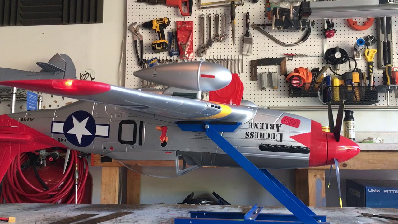

                          #752
                          Thought I would post a short clip of balancing my red tail. Love this balancer. The great planes balancer is well " lacking"

                            #753
                            You're going to love her!! BBD is still in the top of my favorite airplanes.
