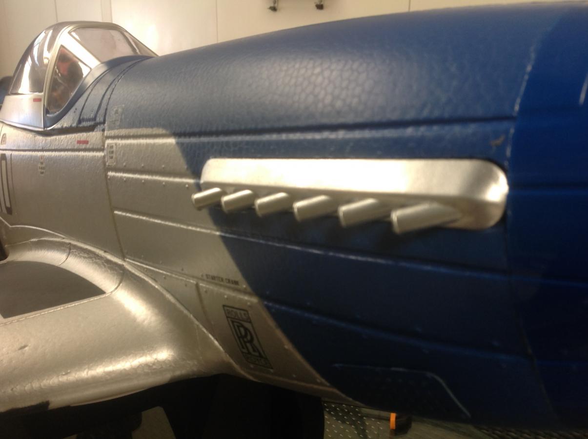

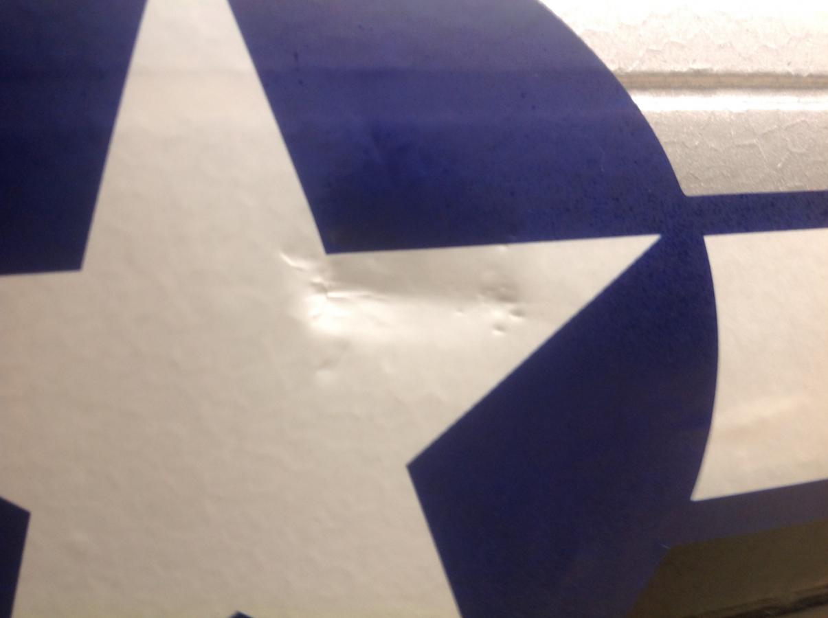

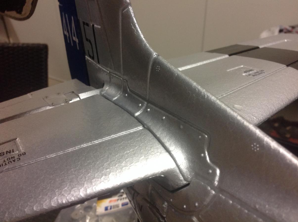

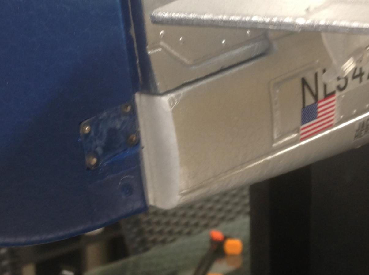

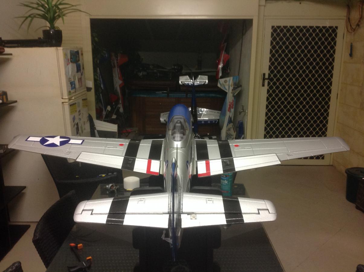

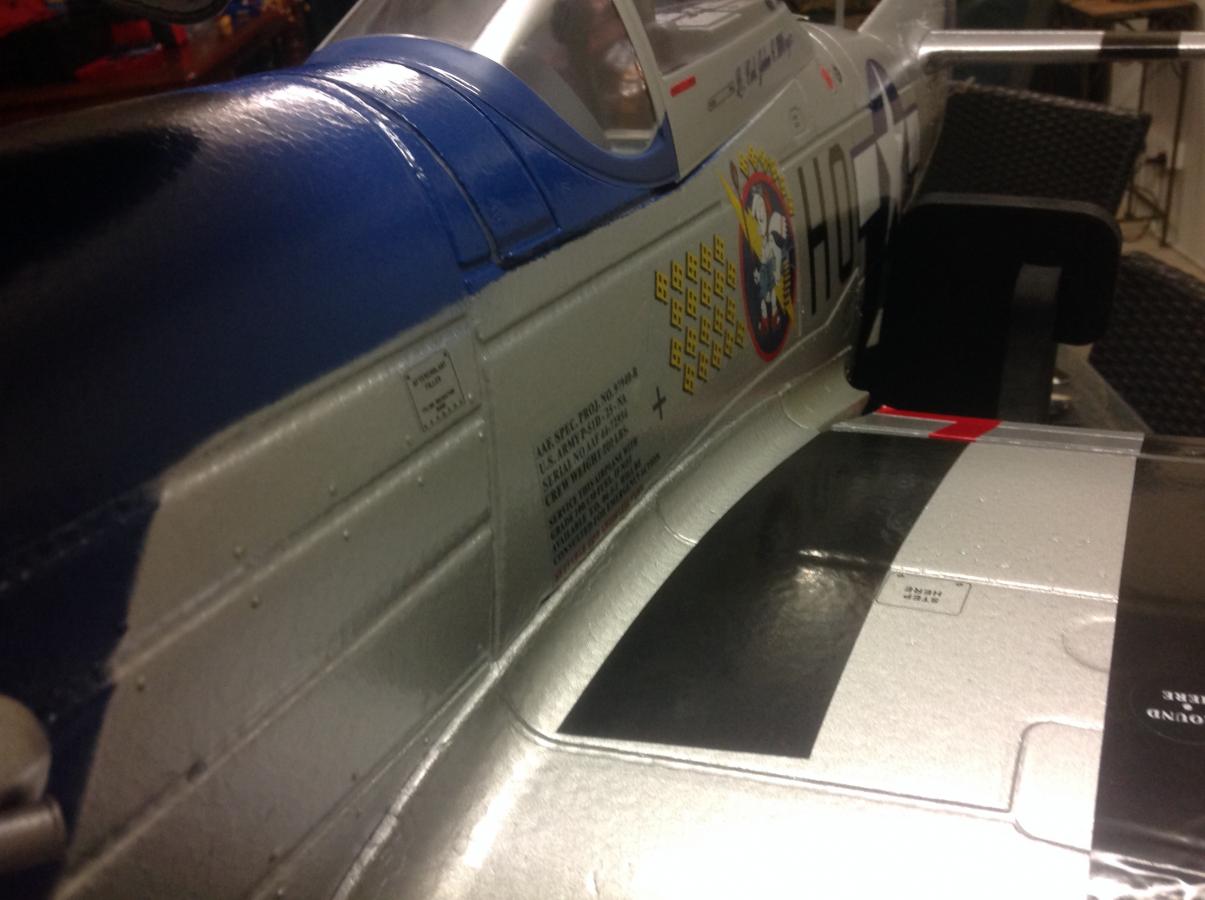

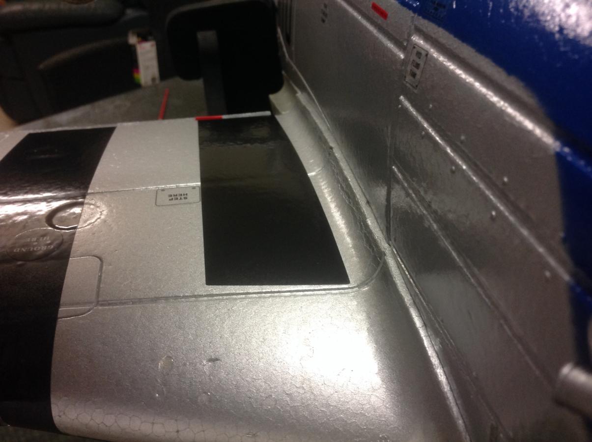

                          Ok, did some work on my new one today and just thought about a couple of things when I was doing it that might help you as well mate.
                          First, check the elevator/horizontal stab for any side to side movement. One thing that all my mates and my mustangs show is they have a bit of side to side movement here. As part of my build on these I glue this stab in along the joins to reduce any flex or just loose fitting movement. All my mates with these have done this as well. It varies model to model, this one wasnt too bad but my mate Alan's redtail was terrible until we glued it. If it flexes or moves side to side, it'll make your tail wobble all over the place (esp at speed), and maybe this will help.
                          Second, check your wings are aligned. As I've noted before, it's my experience that these mustangs are still a great plane to own and fly, but there's a lot more qc issues slipping through of late with FMS I've noticed on all the different threads and forums - and my new one is a good example. You can see my wings don't fit properly, one side hangs out a bit more than the other, and doesn't run evenly with the fuse for its width either. The other side isn't too bad, but still not a nice aerodynamic fit. Wind passing over these will create a lot of little vortices, and I might get a little yaw like feel from it again, more so in the high speed stuff. (Especially since this will be a 5s/6s setup). Anyway, worth looking at yours mate hope it helps.
                          Other little qc things Ive noted about my new one before in this thread: wing screws wouldn't fit, end of the tail isn't painted, I've got a big dent in the fuse and they put the sticker over it anyway, missing a prop nut etc. All little things that aren't deal breakers, but a little frustrating all the same. Did a bit of final painting and detailing today, silver stacks (a must for a blue nose imho), and silver radio mast, painted the servo horn plate thingys black and silver to match the wing and elevator so they don't stick out like dogs balls, and a coat of minwax gloss for a nice finish and to help protect the foam from transport and finger marks in the foam etc when I carry it. Shiny! Lol. :)

                            My wings do stick out from the fuse like that on both sides and I have never been able to correct the issue. I did just glue my stab down as it was loose as well.

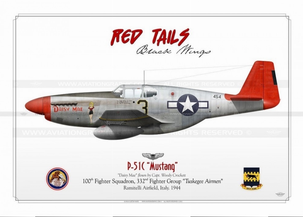

                                    Here are my 2 possible red tail schemes
