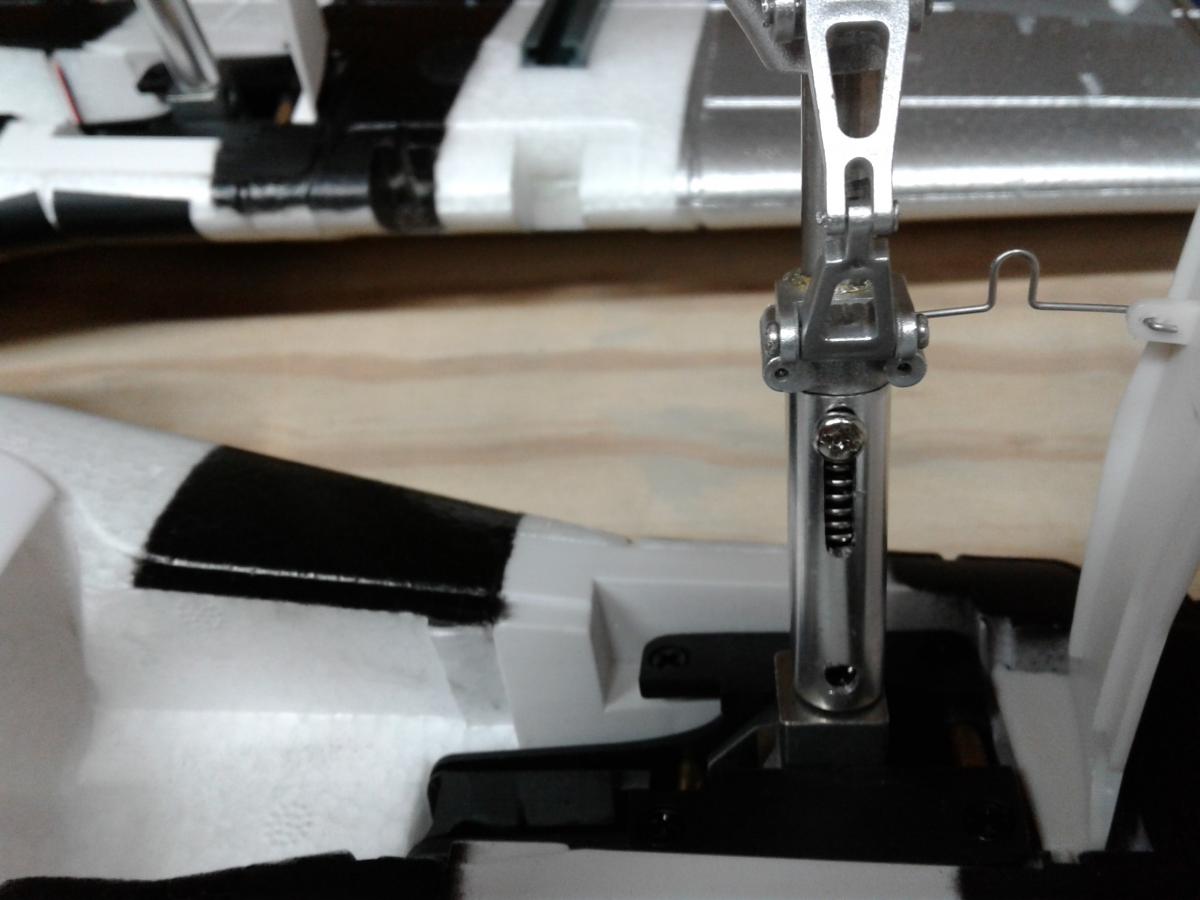

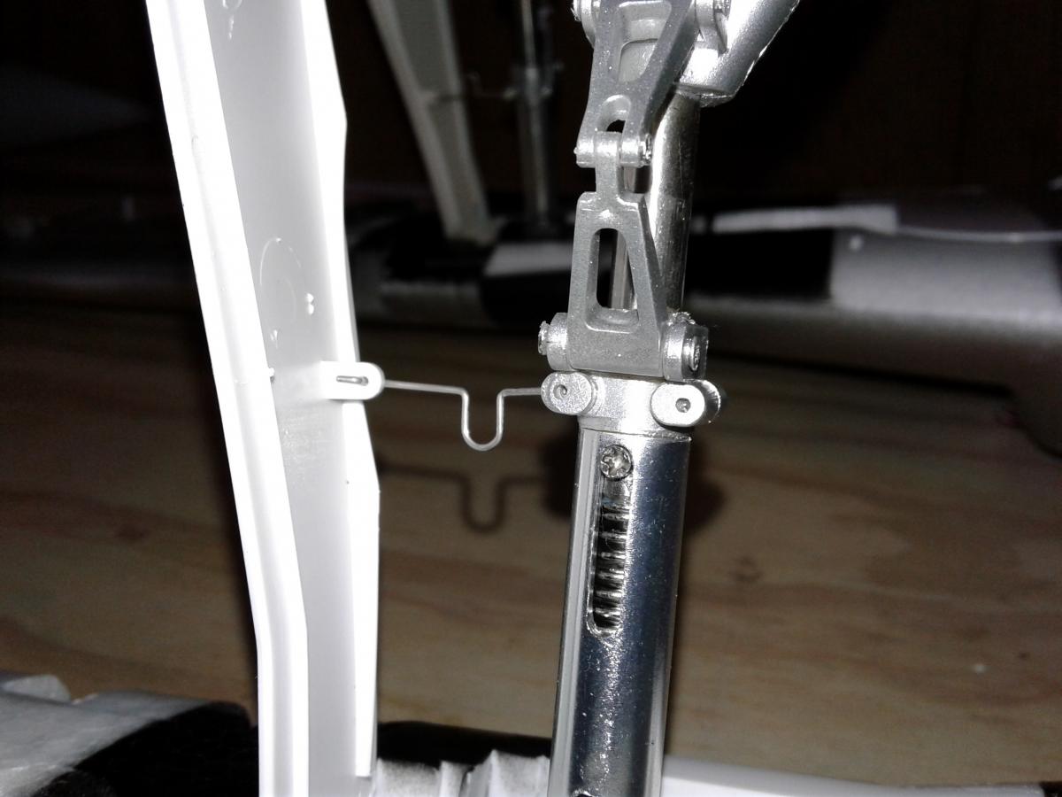

      • While building the P-51, I noticed that the retracts struts have these fully threaded screws acting as followers for the compression action. Mine were both loose (because the threads were biting into the channel) and the compression was not smooth.

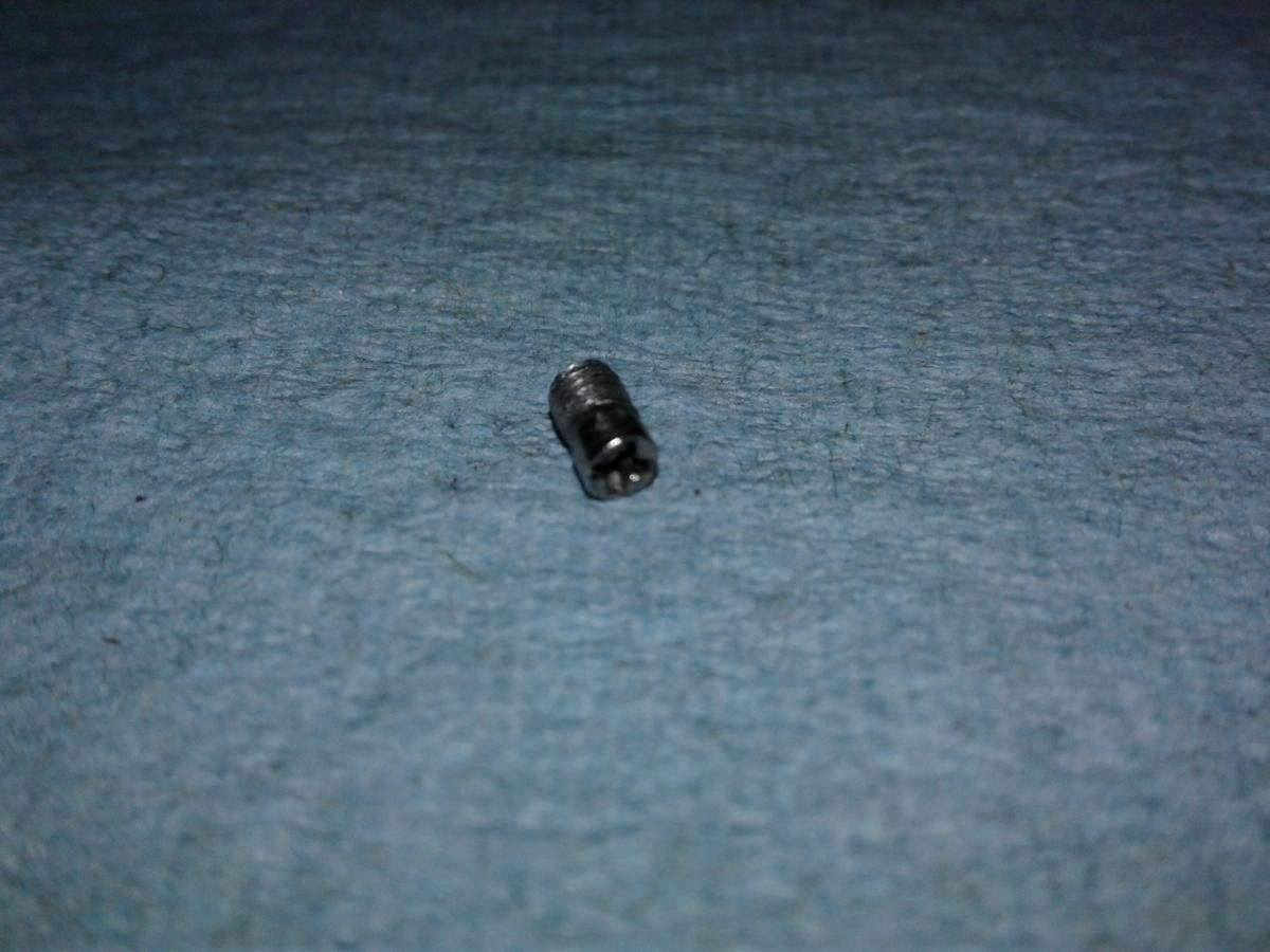

        I replaced them with these smaller smooth-headed screws from a Freewing T-45 nose gear strut. These work much better.

        Does anyone know where I can get more of these little screws? Maybe someone from Motion can chime in?
        I also added a small bead of Foam Tac to the foam hinges. And, I went ahead and glued the tail components with Foam Tac since the screw attachment didn't seem so secure. Overall though, I like the plane. Can't wait to fly her.
        • I recently replaced the main struts on my Stinger 90 because they were worn out and those were the parts I kept from the old set and added to the new ones to give double the support. Your best bet is to find a M3 (I think) shoulder screw and cut it down. Leave the shoulder part a little long so it protrudes past the edge of the strut and you can tighten or loosen them with pliers if need be.

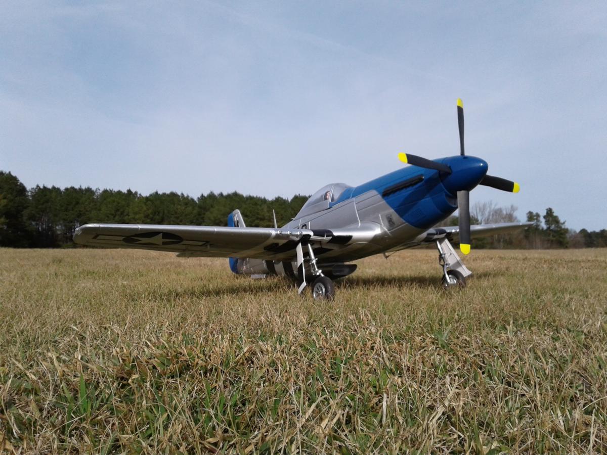

              • Maidened my FMS P-51 today, Christmas day. The weather was indeed frightful...for a maiden anyway. Constant wind at 10-15kts and temps around 40F. My wife gave me the P-51 for Christmas and went with me to take photos.
                Flight 1: easy takeoff with a howling crosswind. But I soon realized the bird was acting tail heavy. Got her under control and landed. It turns out that I had forgot to re-adjust the tail linkage after doing the Z-bend mod and gluing in the pushrod guide tubes. Pilot error....
                Flight 2. same battery, no recharge, elevator properly aligned to stab. She flew and handled the wind with no problem. Stock power, Admiral 4s 3600.
                I am sure I will put many hours of flight time on this bird. What surprises me most about the P-51 is how well she penetrates the wind. Landings and takeoffs are really easy even under pretty good crosswind conditions. Good ship.

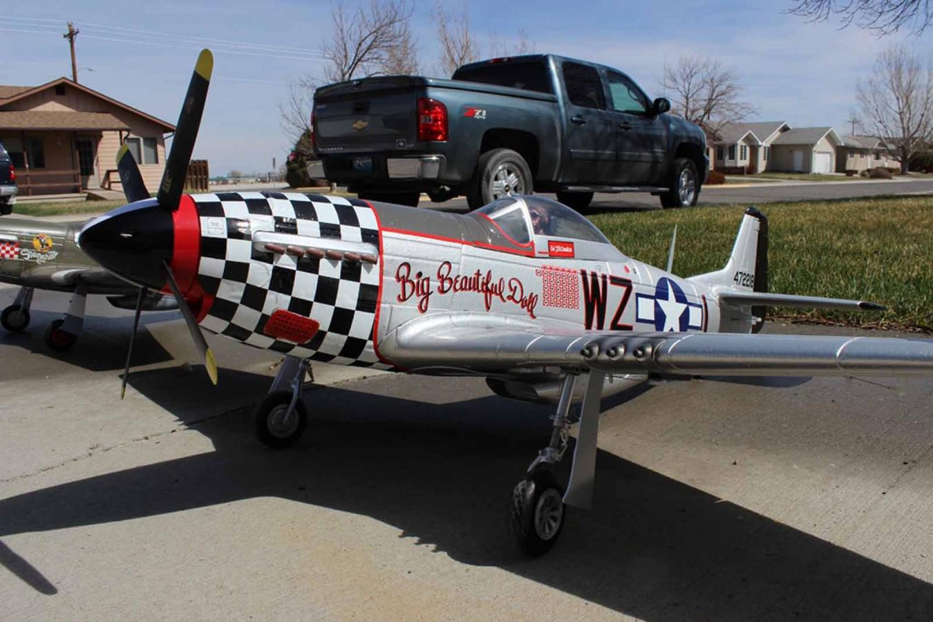

                            Speaking of which, she's about to get an upgrade from her 580kv to a 650 kv that came out of the P-40 because I've gone 6s on the P-40. Got the motor and ESC from Pilot Ryan's P-47 that got totaled at Nefi. (BTW, guys, the easiest motor conversion I've done to date)
                            To mount the 650 takes a bit of drilling as the motor mount has a different bolt pattern, but not a big deal, I've done it on my FW P-51D, Flightline Bearcat and the FMS P-51B, helps quite a bit.

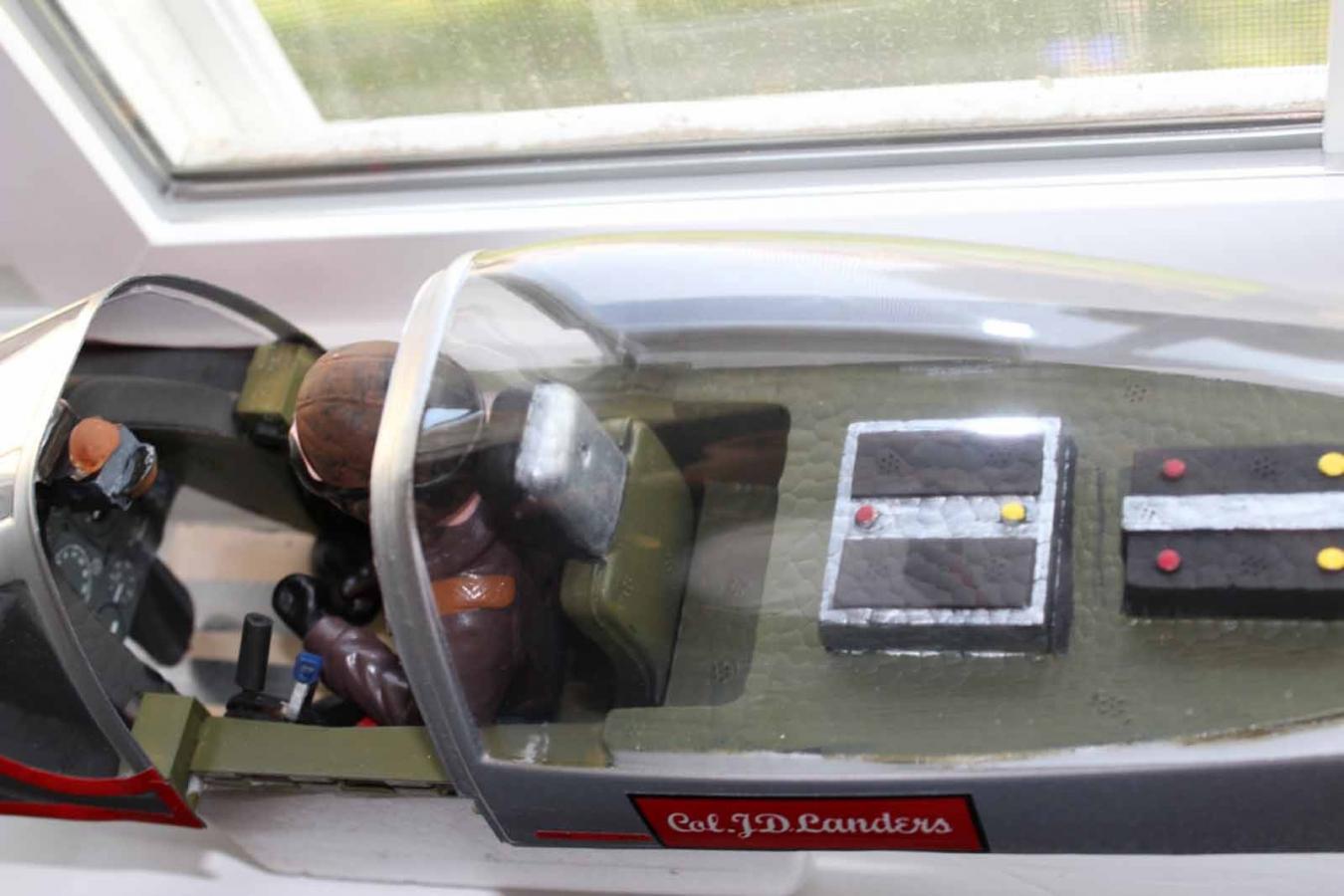

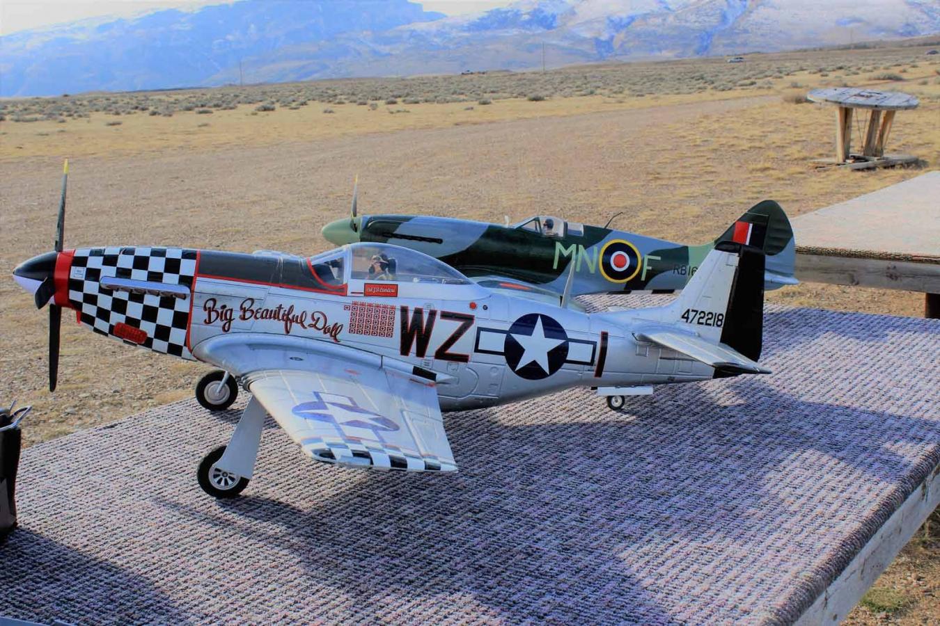

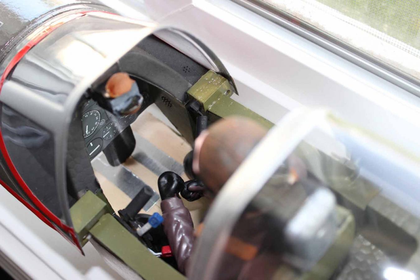

                            Here's how she looks, did some cockpit mods aw well. Believe it or not, the first RC plane I ever bought....
                            Click image for larger version  Name:	IMG_4407.JPG Views:	1 Size:	98.8 KB ID:	110352Click image for larger version  Name:	IMG_3231.jpg Views:	1 Size:	143.1 KB ID:	110353Click image for larger version  Name:	IMG_4408.JPG Views:	1 Size:	99.3 KB ID:	110354Click image for larger version  Name:	IMG_8996.JPG Views:	1 Size:	244.0 KB ID:	110355
