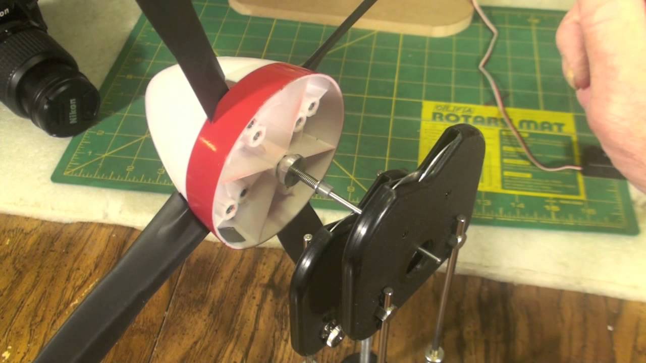

                                    • Hey Shirty. Since getting back into flying and learning to fly electrics my biggest problem has been balancing this prop. I always weigh each blade and then try to balance the spinner useing tape as best i can. They come out good on the dubro balancer when im done but i still get a little more vibration than i like. There have been hundreds of requests from people wanting a video of the procedure but have only found one that really doesn't cover the spinner very well. Ive tried the killer planes vesion but the results were worse. Do you think you could post a video of your method from a to z. I would even be willing to pay to see it. Please consider. There's alot of people that have requested but never gotten. A video is worth a 1000 words. Explaining is sometimes confusing. Please consider my request.:Straight-Face:
                                      Dewey l
                                      • G'day Dewey. I'll put something together for you guys, though it may take a little while, sorry. I've got some video projects for my club on the go, and a couple more for mates, and work is a little busy - but I'll see if I can knock one up when I do the new blue nose. There's a couple vids I've seen that are pretty good on this, I'll try and see if I can find them on YouTube again. A couple of the guys here on the squawk have done one I'm sure, but I can't remember who and I may be getting mixed up with rcg. Do my best mate. :)
                                        • Found the one I was looking for, this is by sandancer, who pretty much wrote the book when the fms mustang came out. This is pretty much exactly what I do, however I don't have the dyno, so once I think it's pretty much on the mark on the Dubro balancer, I chuck it on the plane and check that way. Note I never used to bother balancing the props on my foamies, but after the 190 started getting a bad vibration I've started doing it for all my birds. That's just me being lazy rather than anything else...
                                          I do the blades first. If there variance, I usually just add a drop or two of glue, rather than tape as some do, I don't know if ones better than the other, I've always just added a drop of glue on mine. I don't recommend sanding or removing weight from the blades with a dremmal or whatever, you can weaken the blades if over zealous here. Much safer to add weight via a bit of tape, or drop of glue. Then, I do the same as the video. I start with the blades on the backplate, and balance again. Then when I'm happy with that, add the spinner and do again. Note no matter how pedantic I've been about this, I've found a tiny bit of vibration once assembled on the model, but nothing drastic that would stop me flying it.
                                          I've often wondered if it's the way they mount the plastic backing plate that the motor screws into inside the model, and if this is moving in the foam over time (ie, compressing the foam), and the rpms from the motor cause this movement. I know for a fact this was the issue on my 190. The plastic plate had definitely moved in the foam fuse, and had a little play. Once straightened and reinforced with some epoxy, (and re-balanced), I still had a small amount of vibration, but it was tiny. Note my 190 used the old aluminium stand off type mount, and NOT the xmount that later versions came with. I think this was one of the issues (the foam compressing), which made fms change the mount to a xmount system.
                                          If you go to the fms p51 thread on rcg, you'll see it was started by this bloke sandancer. Click on his first post, and go to his blog. There's a ton of good info here. Don't know what happened to the dude, (he's not be on the forums for years), but I've found his blog mighty helpful when I first got these models.
                                          Heres the link to sandancers blog on rcg. https://www.rcgroups.com/forums/member.php?u=293994
                                          hope this is what you were looking for Dewey. ;)
