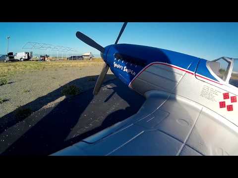

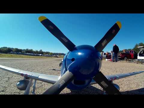

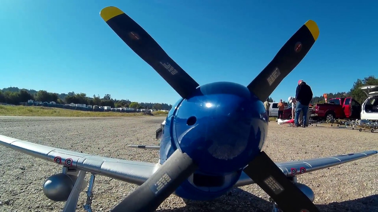

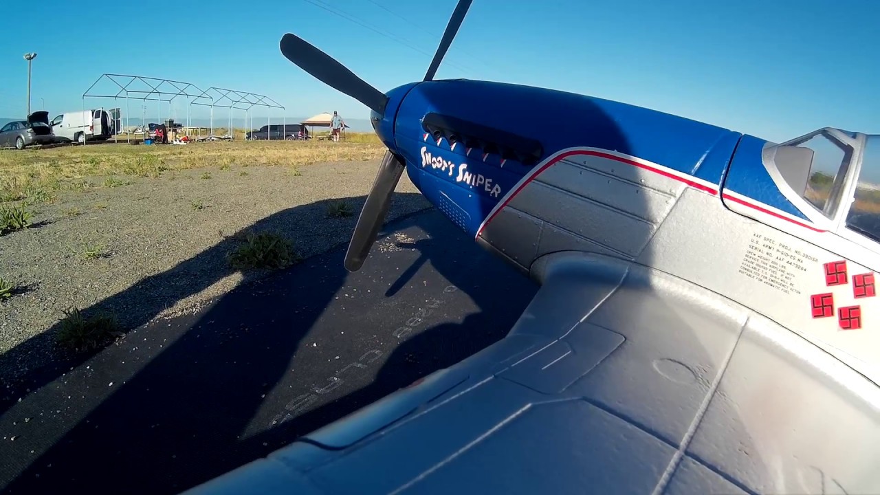

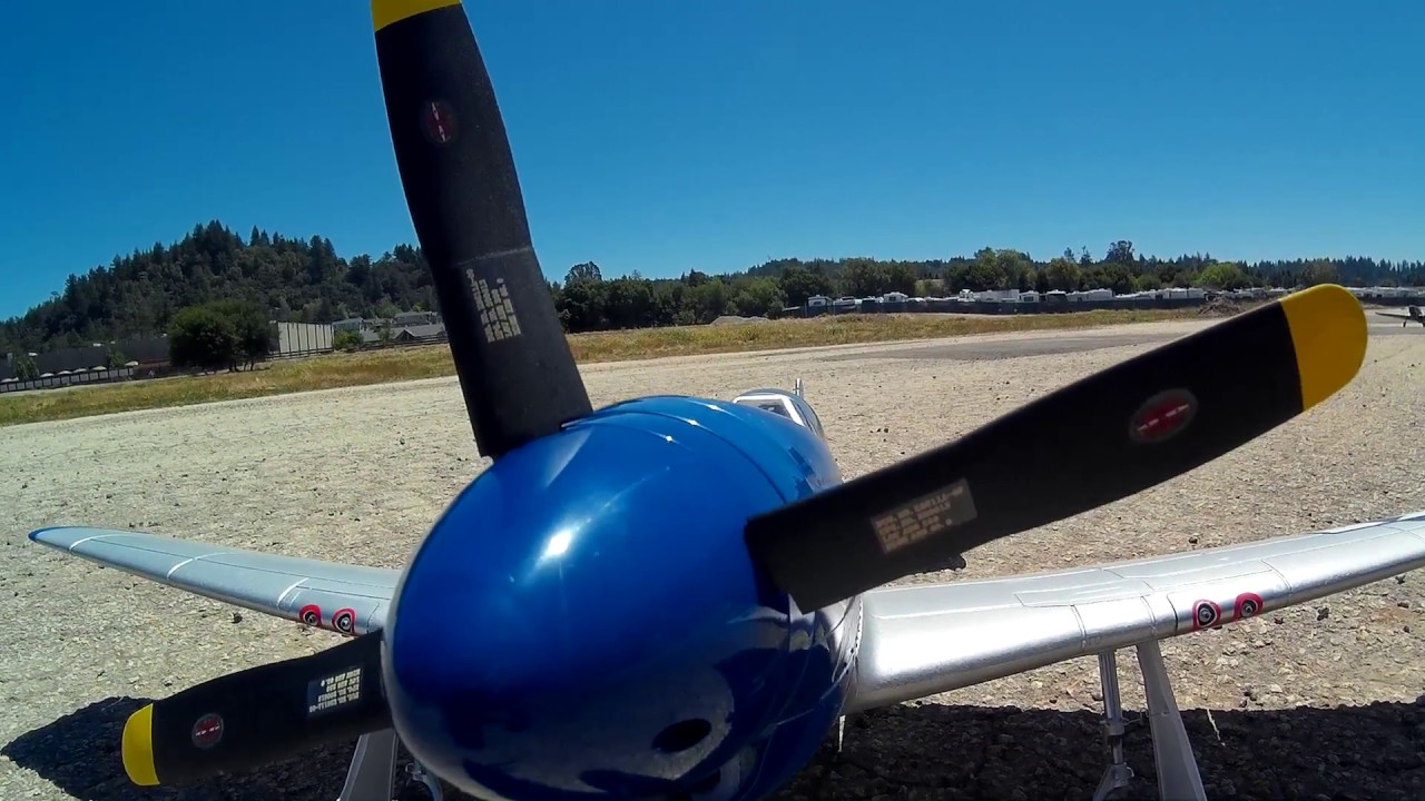

                  • I maidened mine on saturday and was instantly in love with it!! This thing is awesome! I am using stock 540kv motor with zip tie mod, stock esc, Added a ZTW UBEC and a 4s 35c 6000mah battery. I am getting 10 min flight times with this thing and love it as it is!!! I have a 4258 550kv motor ready to swap into it but not sure if I will bother. It suits me just fine as it is stock! Here are a couple of the videos and the playlist if you want to look at the rest.
                    • Awesome!
                      • What rifleman said ;)
                        • Looks great, just got to remember that prop torque pull and add that right rudder.
                          • Excellent Vids!!! Love the flying field. Like proximity of the pilots to the flight line a lot. I have the 560 Kv, No Prop mod.
                            Prop mod seems to work very well!
                              Look at the later videos and you will see it getting straighter. Basically I have to hold right just as I throttle up and it will go straight...
                              Also stay tuned... I was able to get the 1700mm 17x10 prop to fit on the spinner... I still need more parts but will be trying this out. it may only be a 3s configuration but it is for sure worth a try...
                              • Also.... the 560... blew the prop stickers off the prop. :-)

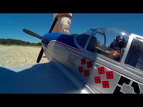

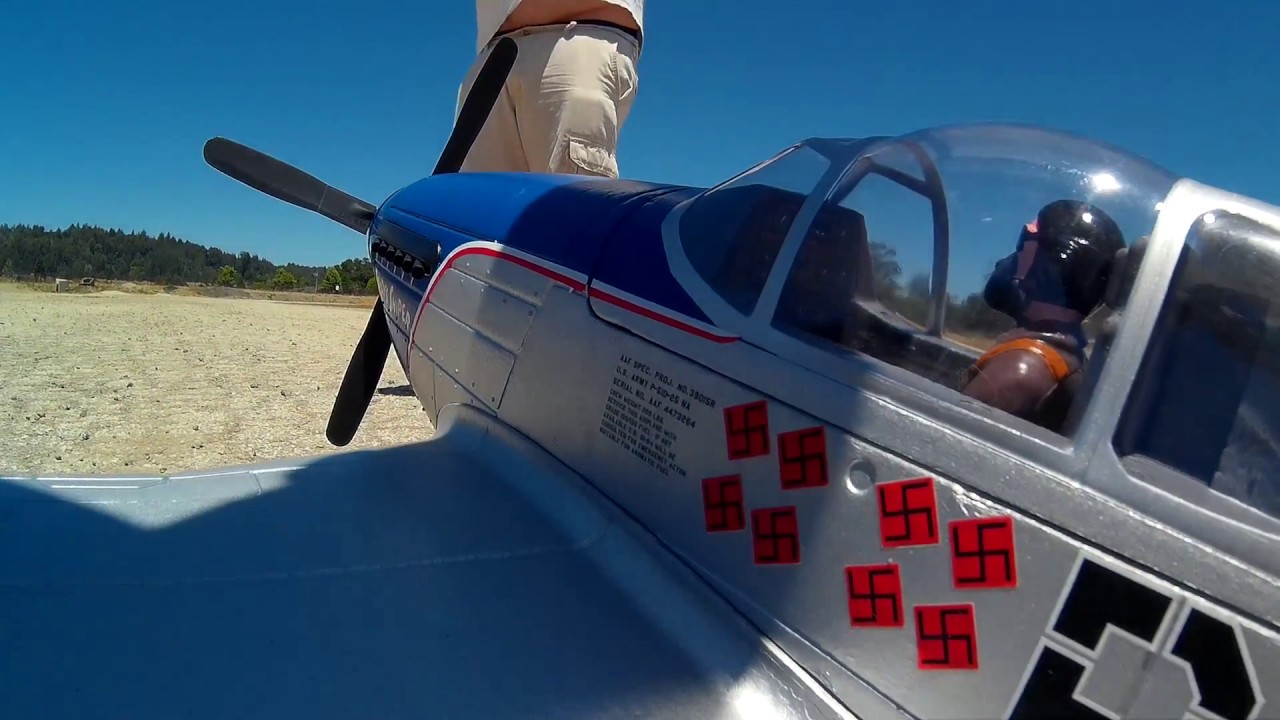

                                        I did ditch the tanks for the last couple flights at Skypark... Here take a look..
