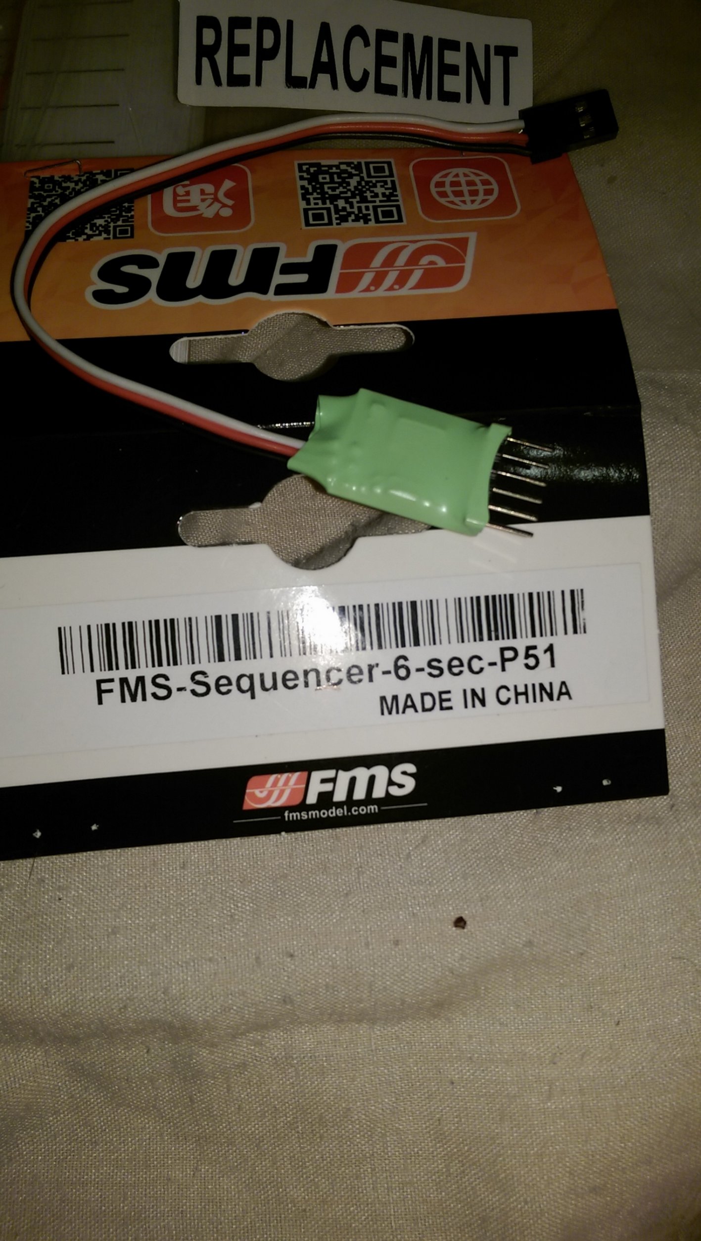

            Hey guys. Noticed not much going on here lately so I decided to bring this to the table. I've got a problem that I have not been able to get solved. I purchased the 1450 snoots sniper from motion a few months back and have yet to get a problem with the retracts straightened out. I've changed receivers tx and the single point connector for the wings and it might work a couple of times or not at all. At first the doors would open and time out and then close. I have changed out the sequencer. The blue one one came in the plane and I have since tried the green one. The green one does not work at all. It was ordered for spare parts. I am certain that the sequencer is plugged in correctly and that all polarity is correct. With the blue one when you flip the gear switch the doors open and then close after 6 seconds and the gear never deploys. This will only happen once. Repeated efforts cause nothing to happen at all. I can then unplug the battery and then plug it back in and the gear doors will function again as before just one time. HOWEVER I CAN HOOK THE GEAR LEAD TO A SERVO TESTER AND THEY PREFORM PERFECTLY. I'm starting to go bald here. Pulling my hair out. It sure would be nice to finally fly this plane. Any help would be greatly appreciated.

              Dewey,
              You got me baffled when you talk about a 'green' sequencer. I can find none and the only ones that may be the green one might be B and/or C listed below because Motion put this note on its product description of: "NOTE: The photo above(I see it is blue) shows the OLD sequencer. We will update the photo soon".
              Which of the 3 referenced links is the sequencer(s) that you have?
              A https://www.motionrc.com/products/fm...-p-51-6-second
              B https://www.motionrc.com/products/fm...-p-51-3-second
              C https://www.motionrc.com/products/fm...encer-3-second
              A is a 6 sec sequencer used with 003 retracts https://www.motionrc.com/products/fm...tract-fmmre003
              B is a 3 sec sequencer used with 1400mm FMS P-51D V7, V7.5, and 1400mm P-51B with stock retracts (not the 003)
              C is a 3 sec sequencer used with ParkZone retracts
              My guess on this is: You have the latest rev Sniper with the 6 sec sequencer and the slower 003 etract and your blue 6 sec sequencer is intermittently functional.
              When you bought the "spare parts green", it was the incorrect sequencer(most likely a 3 sec) and which also happened to be DOA.
              Your best option is to order the first sequencer(A) I listed above.
              Good luck and best regards,

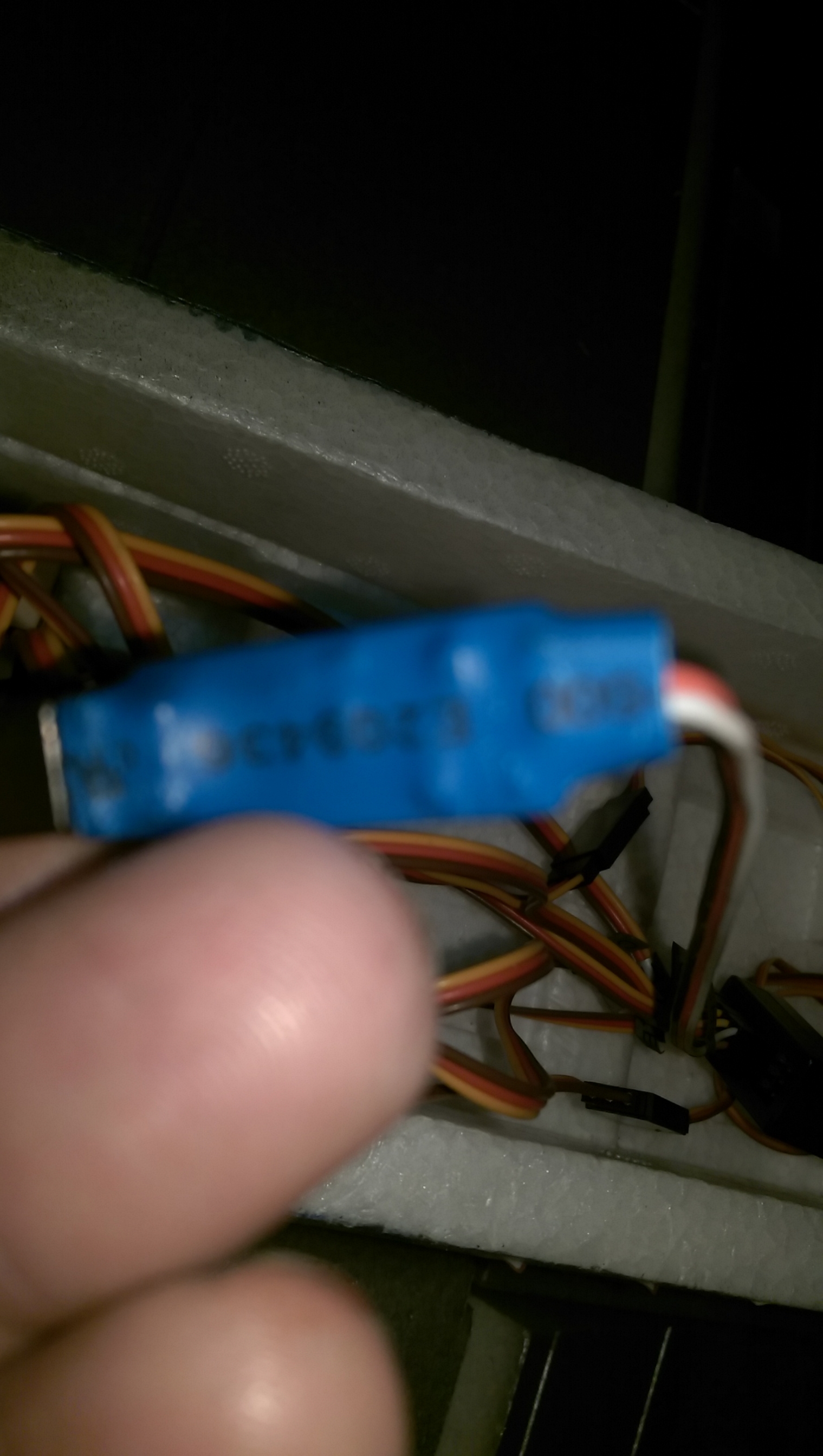

                Thank-you OV10 for jumping in on this. I have taken pictures of the sequencers that I have. The blue one came in the plane. It is the one that cycles the doors only. The light green one is the one I ordered for a spare. The picture is taken on the original package it came in. It is also the one that does nothing. Matt had sent me the wing connection board thinking that there could be solder flash somewhere in the board causing the problem. After installing the board the retracts operated fine that evening. I put everything up because it was getting late and have not been able to get back to it until recently. I powered the plane up to make sure the servos were still centered so I could finish the plane and tried the retracts and it was doing the same thing it was doing before the board replacement. The plane had set for almost a month with no one touching it. I really hope you can lead me in the right direction. Thank-you again.

                  Something happened and my pictures didn't load. I'll try again.
                  Dewey l

                          Shangrila came with this....thing that I never did figure out, I posted it and asked the guys if they could explain. In the end, I opened up Big Beautiful Doll and copied what I had in her and relegated this to the spare parts bin, the gear on Shangrila works great
                            • 8834
                            #593
                            That's the very thing that's still in my BBD and working as it should. I believe the blue thing is the sequencer. The rest is some sort of mult-connector. Mult-connectors use common grounds for several servos and when testing individual servos on the bench via a tester, some or all of the other servos (ones not being tested) will act very strangely, so one must ignore what they are doing. It's when everything is hooked up and running together via the TX and RX, that it all sorts itself out. I think the trouble with these kinds of common ground multi-plugs, all it takes is for one solder to be a bit "off" and it can become a nightmare. I had to by-pass the multi-connector on another plane as the one servo simply didn't work at all.
                            Best thing is to eliminate the multi-plug, isolate the sequencer and the two retracts and doors and test them alone. That will weed out a bad sequencer or a bad multi-plug.

                              #594
                              Yes I've seen that many times. I think I've looked at every video on YouTube on the connectors. I have the one that is plywood mounted. It came already glued to the floor of the plane and really don't like the crimp that it puts on the wires that are plugged on top when removing and installing the battery tray. Also the sequencer is stuffed underneath where the sharp edges of the pins in the board can pierce the heat shrink on the sequencer. That just seems wrong. Extreme bends in wires top and bottom right at the plugs.

                                Thank-you for the input XViper. I'll take the board totally out of the picture and see what happens. It just seems funny that when I remove the gear lead from the rx with the other leads still in the board I can hook a servo tester to the gear lead that was hooked to the rx and it never misses a cycle. Both doors open and the gear deploys and then the doors close. I've even thought that maybe the pins sticking out of the bottom of the board might be piercing the heat shrink on the sequencer because it is a tight fit under the board and the ends of the pins are quite sharp. I'm sure that after awhile there would have to be penetration after a while. No matter how well the prop is balanced to prevent vibration.

                                          #600
                                          Thanks Dan. I really appreciate it. Just got finished messing with this thing some more. Double checking everything and still no go. It still works with a servo tester perfect but not on the rx. Had it hooked up to 2 different new spectrum reciever and 2 new tactic receivers and still no joy. Tomorrow I guess I'll try to figure out how to do away with the connector all together. Just too frustrated tonight and tired thanks again I'll review the vid again tomorrow when I'm not wore out and see again what you did.
