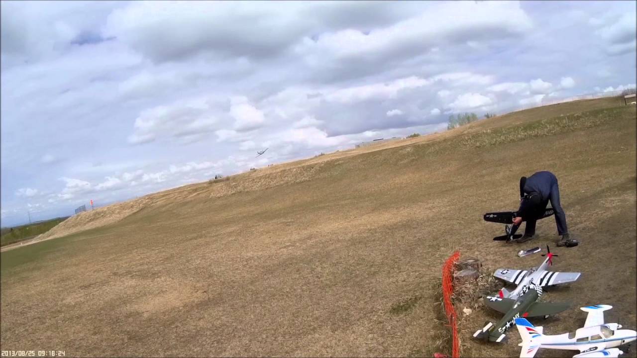

          Finally got a chance to fly my 1450mm P-51 V8 with the 4258 650Kv motor from the latest FMS 1400mm P-40. I'm using the stock prop but kept the ZTW 120A ESC from the 6s application (550kv Olympus motor + prop). I must say that this is the way the plane should have come.
          In stock form (540kv motor), it was barely adequate in speed and power. (You just know when people say it flies very well "scale", they're secretly saying it needs more power but just being polite about it.) It would not do a good loop from level flight. It had to be started with a full throttle dive. Sudden banked turns were dangerous with no power in reserve to get out of trouble. If you weren't "2 mistakes" high, it's headed for dirt. I always like my planes with that little extra on reserve.
          With the 580kv motor and zip tie mod, the plane came alive but could still only be called "adequate".
          Now, with the 550kv motor on 6s and the 2-blade prop, it became a speed demon (for such a large plane) and it sounded mean. I recall I clocked it once using GPS onboard at between 90 to 100 mph. Unfortunately, using the stock 4-blade prop, something overheated or over-amped and the motor cut out at the most inopportune moment (like trying to accelerate to come around for a second landing attempt). I prefer the looks of the stock 4-blader.
          With the P-40 motor on 4s, this plane can be called very fast and very competent. Loops are easy from level flight and the sound is almost too quiet, although it looks really nice as it whooshes by, just not quite as eerie or spooky as my 1700mm FMS Corsair with the 360kv motor. When I get too used to this set up, I can easily throw the 6s system back in to get my speed fix.
          Here's the video. View in full screen at YouTube as it was taken by a Mobius standard lens "hat cam".

            Looks great Viper, and a perfect landing, just to round out the flight, some days are just like that!
            Stormy and windy here today so no flying, BBD is all set to go. I have a 580 and a 85A Mantis in her. Got a brief flight before season end last year. Needed some control throw adjustments, but the wind got up to bad for more flights. From what I did see though, she looked pretty good. Now I can see a path forward from that motor.
            I did put the 650 in Old Crow, but haven't had a chance to try her yet.
              Let us know what you think of the comparison (580 in the BBD vs 640 in the OC).
              Today was the first day of a bunch of beautiful days to come, after a few days of wind, doom and gloom.
