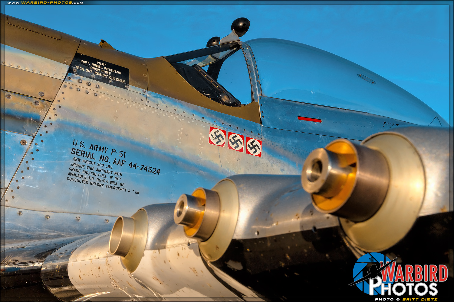

            Gman looking forward to seeing what you do..I have been wanting to try that and hoping to get this look Click image for larger version
