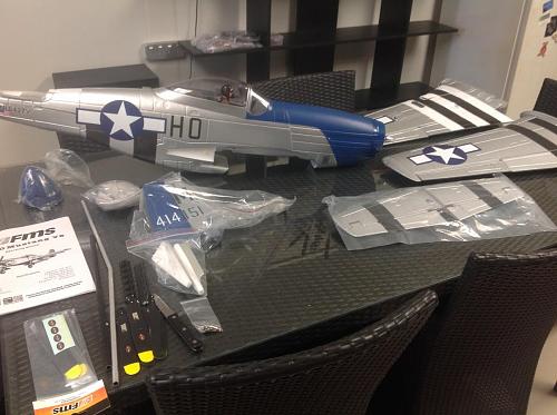

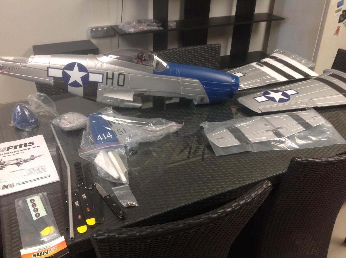

    Ok... extremely frustrated ATM. Started building my new mustang today,
    The glass rod that connects the wings simply will not fit. One side only goes in about a quarter of its length, and now it won't budge and is stuck. (The other wing slides in about half the distance, and stops. I can't see anything blocking the hole). I got the rod back out of this wing, but the one that's only a quarter in I can't move, its stuck solid. (Won't even rotate or anything). I've already used waaaaay more force than I'd like trying to get it to come back out, that the plastic tube it goes into has cracked. Any more I'm scared I'll break the wing, the tube or the rod.
    Any suggestions???
    Motion staff - what's the go? Do I need to make a warranty claim somehow with you guys, do you want to send me two new wings and the glass wing tube? Or is there some way I can get the rod out and maybe sand it to make it fit? Would this compromise the strength of it?

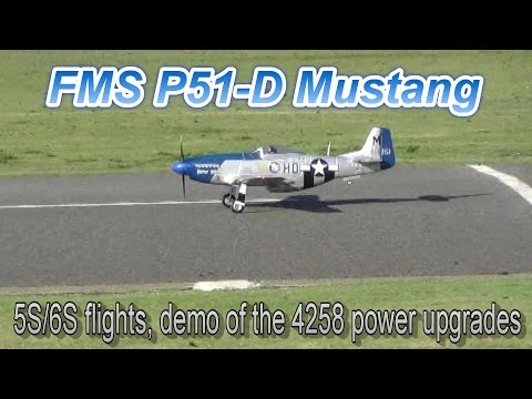

    And here's my DD on 5s, if it helps. 5s is the safe option, but I seem to fly mine as much on 6s as 5s these days. There's not much nice flying in this one, as the vid was made from my 3 flights on maiden day, and I took it pretty easy being a new bird and all. Again, hope these help buddy. ;)

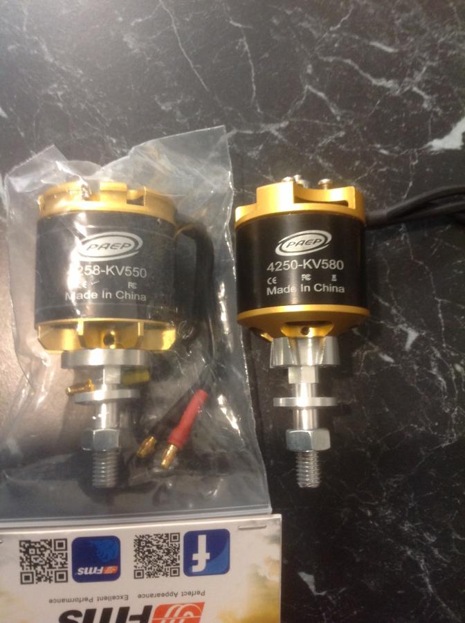

    Here's the 4258-550, next to the stock 580kv that comes in the fw190. (The 580kv is the exact same size as the 540kv that comes stock with the Mustangs). as you can see, it's much bigger.

    Hey mate, you've got a few options with power upgrades. I also found the stock motor pretty lacking. Myself, xviper and licobra were the first to experiment with some other options, and they've proven to be a good match. Now with the p40 motor, you have a couple to choose from. But back when we upgraded ours, the p40 didn't exist. So, here's your options:
    1. Get the 650kv motor from the p40. This is about the best motor to stay on 4S. You will need to upgrade the esc to a 80amp one to be safe. You'll get a noticeable increase in performance with this one, and can stay on 4s if that's better suited to your battery options.
    2. Get the 4258-550kv from the fms Olympus. You'll need the x mount as well, and the prop adapter if you want to reduce the gap between the spinner and nose with this motor. (It's only a 2-3mm saving, it doesn't stick out much at all, but some people don't like a very small gap). You can see on my old one it's hardly noticeable, but the prop adapter for the 4258-550kv will reduce this gap if it bugs you. I didn't bother, the gaps tiny imho.
    The 4258-550kv is a much bigger, heavier motor as it's designed to run both 5s and 6s. If you want to run 5s only, you'll need a 85 amp speedy. If 6s, 100 amp speedy. (I run both 5s and 6s, so 100 amp for me). But please note: 6s is at your own risk: a couple people had the prop and spinner explode on 6s with this motor. (Only a couple, most of us who have gone this way have had no issues). Whether their props expoloded in flight because they weren't balanced, the people did no maintenance like checking the blades are tight regularly, or the much higher rpm on 6s, (or a combination of these), I don't know. Most of us have had no issues on 6s but I mention it so you are aware it has happened.
    The conversion is very simple, and the 4258-550 is a drop in fit. Only thing you'll need to do is trim a tiny amount of foam for the bigger xmount. (And upgrade your esc). There's full details on my blog at RCG with pictures on how to do it here: https://www.rcgroups.com/forums/member.php?u=439930
    i also did this conversion on my Dallas darling b version, and my fw190. No issues to date and both those have over 150!flights as well. Here a vid I made of the performance upgrade, I tried to show the differences with some aerobatics, wot passes, verticals etc, I condensed both flights (one on 5s, one on 6s), to keep the vid short. But I think it's a good vid that shows the bigger envelope and power increases you can expect if you do this upgrade. Note I pulled out of the verticals in the vids, was getting a bit too high to see, though I did push the 6s up further. You'll find the vertical performance with the 4258 is pretty much only limited by your eyesight, though on 5s I was wot, 6s about 80%.
    If you have any any further questions, don't hesitate to ask. Hope it helps mate. :)
