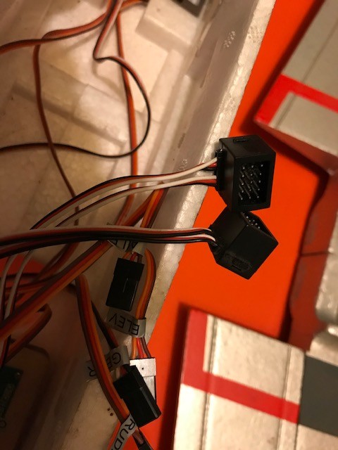

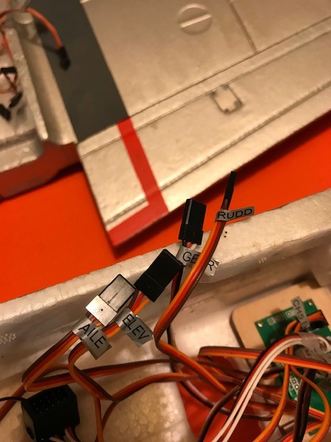

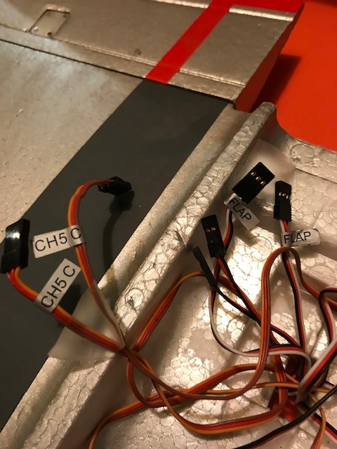

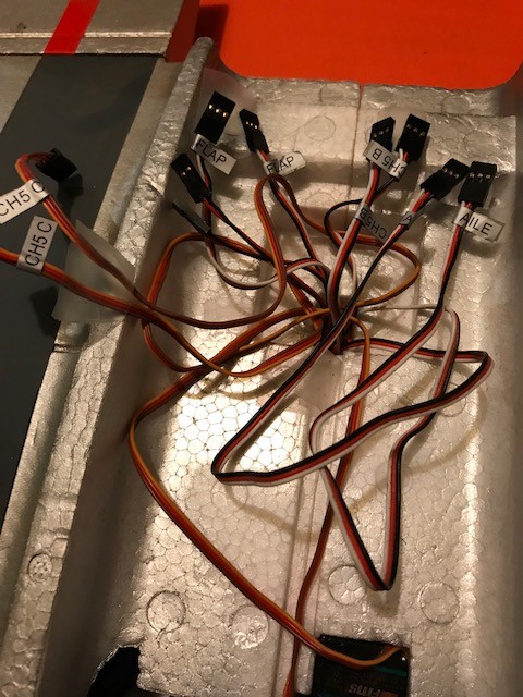

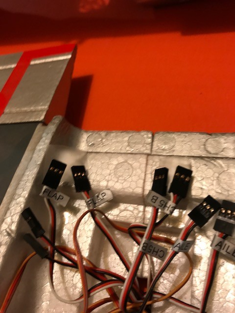

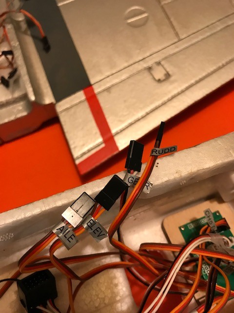

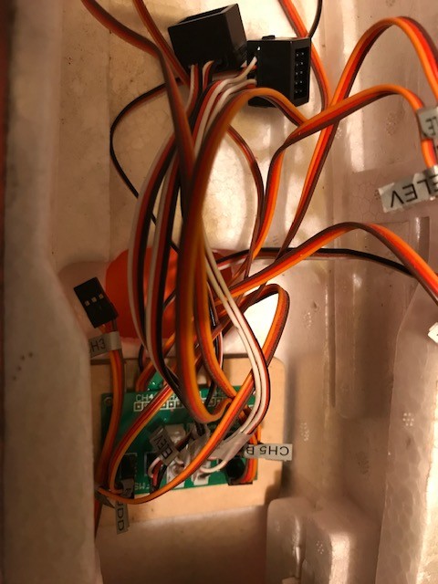

Sometimes, a little digging around can resolve your problems for you. In this case, a bit of digging revealed an online manual for your plane:Originally posted by ICM View PostNot sure if this is the right thread, but I just got an FMS P51D Big Beautiful Doll from an estate sale. No Manual or rx. Don't know which version, but likely not v8 checking against the online v8 manual. Guessing v7 but can't find earlier version manuals online. For purposes of version id, it has a gold and black 540 motor, slide-in battery tray, and just rear of the battery tray a green multi-function board screwed to a piece of wood with what looks like a sequencer partially visible under the board. Also, the interlocking tail assembly is secured to the fuse in the rear by a single screw from the bottom of the fuse going through the horizontal and vertical stabs, and in the front by 2 small plastic dowels fit into matching holes in the fuse. Any help on which version this is would be appreciated.
More importantly, I'm not sure how to connect the wiring. I plan to use a 6ch Spektrum or compatible rx. Coming from the green multi-function board are 3 wire leads with connectors marked Ail, Ele, Rud, Flaps. 3 wire leads marked Thro and Gear come from the esc and sequencer respectively. I assume these connect to rx normally- Thro 1, Ail 2, Ele 3, Rud 4, Gear 5, Flaps 6. However, also coming from the middle of the green multi-function board are two 6 wire leads connected to two relatively large black plastic male connectors, each with five 3 wire pins. These obviously connect to the wiring from the wings, but there is no marking indicating what goes to which pin. The wings have eight 3 wire leads with female connectors- 2 marked Ch5C, 2 marked Ch5B, 2 marked Ch1Ail, 2 marked Ch6Flaps. There are also two unmarked 2 wire leads with female connectors (lights?). No idea which set of wing wires get plugged into which set of pins in the black plastic connectors coming from the green multi-function board. Sorry if this is lengthy but I tried to be as descriptive as possible. Can anyone help or provide a diagram? Many thanks in advance.
https://www.horizonhobby.com/on/dema...PRT_Manual.pdf
Page 11 tells you everything you need to know. You are dealing with FMS's "Multi Connector System":
https://www.horizonhobby.com/product...FMMCON001.html
These days, you can find almost anything on the internet if you only know where to look.
Originally posted by starcop View Post
Yes, Black & red (Two) wires are lights. There should be an indication of which one is the polarity side. Also, if they are labelled (Aileron) Channel 2. (gear) channel 5. ETC. Respectively. You may have to test fit those connections. Being that the Red positive is always in the middle, you should be fine for testing purposes. Hard to tell without seeing a visual. Best I can come up with at this time.
Yes, Black & red (Two) wires are lights. There should be an indication of which one is the polarity side. Also, if they are labelled (Aileron) Channel 2. (gear) channel 5. ETC. Respectively. You may have to test fit those connections. Being that the Red positive is always in the middle, you should be fine for testing purposes. Hard to tell without seeing a visual. Best I can come up with at this time.Originally posted by ICM View PostNot sure if this is the right thread, but I just got an FMS P51D Big Beautiful Doll from an estate sale. No Manual or rx. Don't know which version, but likely not v8 checking against the online v8 manual. Guessing v7 but can't find earlier version manuals online. For purposes of version id, it has a gold and black 540 motor, slide-in battery tray, and just rear of the battery tray a green multi-function board screwed to a piece of wood with what looks like a sequencer partially visible under the board. Also, the interlocking tail assembly is secured to the fuse in the rear by a single screw from the bottom of the fuse going through the horizontal and vertical stabs, and in the front by 2 small plastic dowels fit into matching holes in the fuse. Any help on which version this is would be appreciated.
