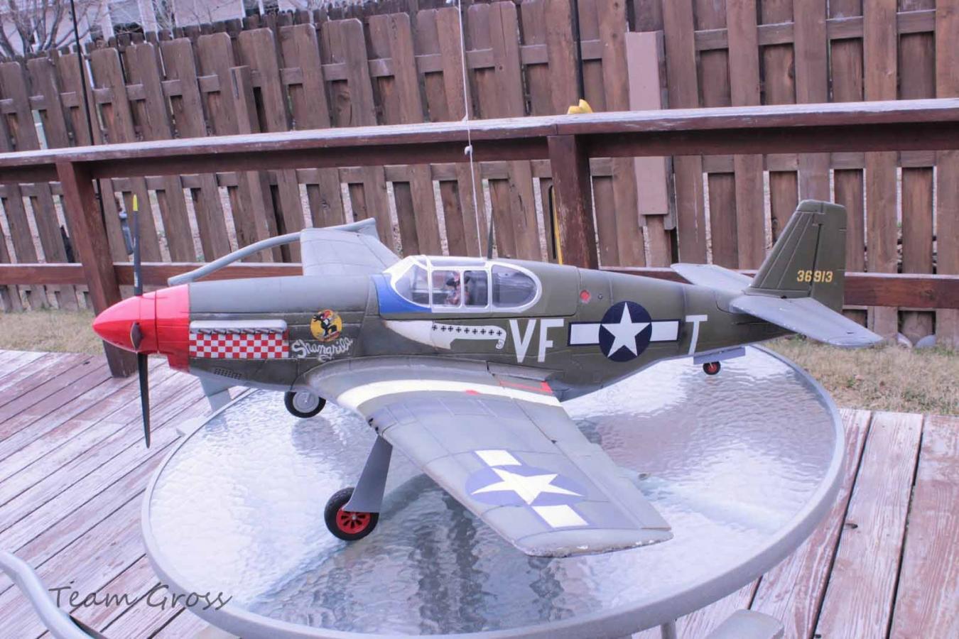

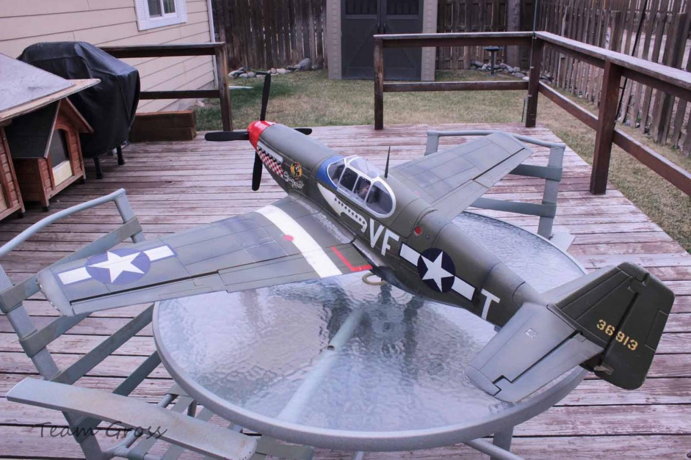

    My P-51B lawn darted earlier this season, but I rebuilt her and she's flying again. From this...
    Click image for larger version Name:	IMG_4308.JPG Views:	0 Size:	137.7 KB ID:	205084
    Back to this Click image for larger version Name:	IMG_4371.JPG Views:	0 Size:	109.8 KB ID:	205085
    Yep, it can be done!!
