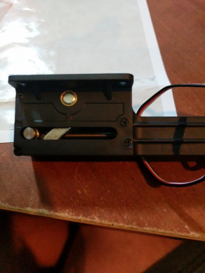

    Well, I am disappointed.. Apparently Visual aids, leads to the correct information and concern about the rest of the customers getting a product that they know what they are getting is not in the best interest....
    Response from Horizon:
    Hello Michael,
    So I was able to verify with someone regarding this part. The retract is the same as what you see on the picture on our website. We were not able to find a difference from your pictures you sent us. If the retract will not work out for you, pleas contact our customer service department so we can further assist you. Thank you for your recent contact with Horizon Hobby.
    Now we have all seen the pictures I put up, and sent to them, along with leading the person on the phone to Ali- who already had the updated pics and information while I was on the phone, walking them to the website...So below is my response. Maybe I should have been a little nicer, but it irk's me that they are blowing me off, when I told them I want nothing other than for them to get the updated information on their site for the rest of people..... I did ask if they were able to get an original unit to exchange it on the phone, but if that was not possible, no problem...
    1st let me reitterate that at no time have I been trying to get anything for free, I purchased the part, disassembled the part and own the part.. that is not in question, so there is no reason for me to contact your customer service dept.
    Next, I also started that the part will work as an o.e. replacement just fine with a little foam cutting. That also has never been in question.
    Not being able to see a difference however is a complete farse. You can look up the retract by application on FMS website.... Right there they discuss the change....
    The entire purpose of this had been to try and get you the correct information to provide to your customers.. apparently this is of no value.. anybody ordering these with the intention of repairing an o.e. Retract will be out of luck.
    Maybe I sound a little bitchy, sorry for that. Just rubs me the wrong way.
  • putput
    Honestly not completely sure. The package I received still says re003 right from FMS.
    I haven't called motion to have them check their stock and part numbers. When I talk to Horizon all are there current stock is re003 on the package. It appears FMS made a rolling change as of March. All they are releasing now is the new units.
    At this point I'm going to keep the retract lesson learned... I am now waiting on a retract controller as as the only failure in the original is with the board
    Originally posted by putput View Post
    The trunion looks decent, but the legs are longer to accommodate it. Unfortunately ipaid full retail to Horizon of 37.99 because they got them back in before motion at 29.99.. they're both still listing them as re003. Both are still showing the original pictures as well.
    Again again I think it's a perfectly good retract and will will work just just fine as an or replacement
    You sure Motion has the new RE042?? They are usually right on top of document changes when they receive upgraded or new hardware. WHITE CORTESY PHONE FOR AROS PLEASE
