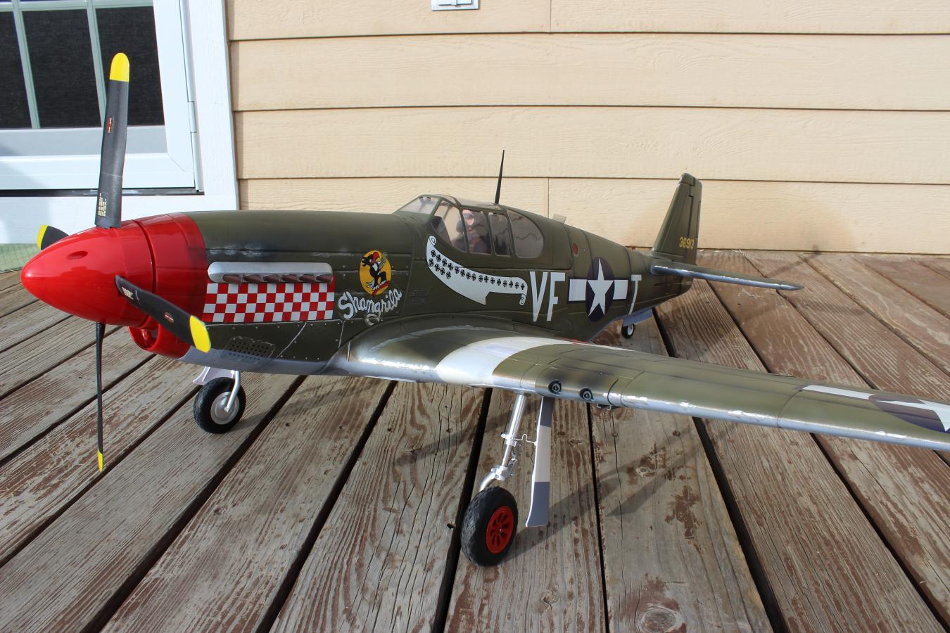

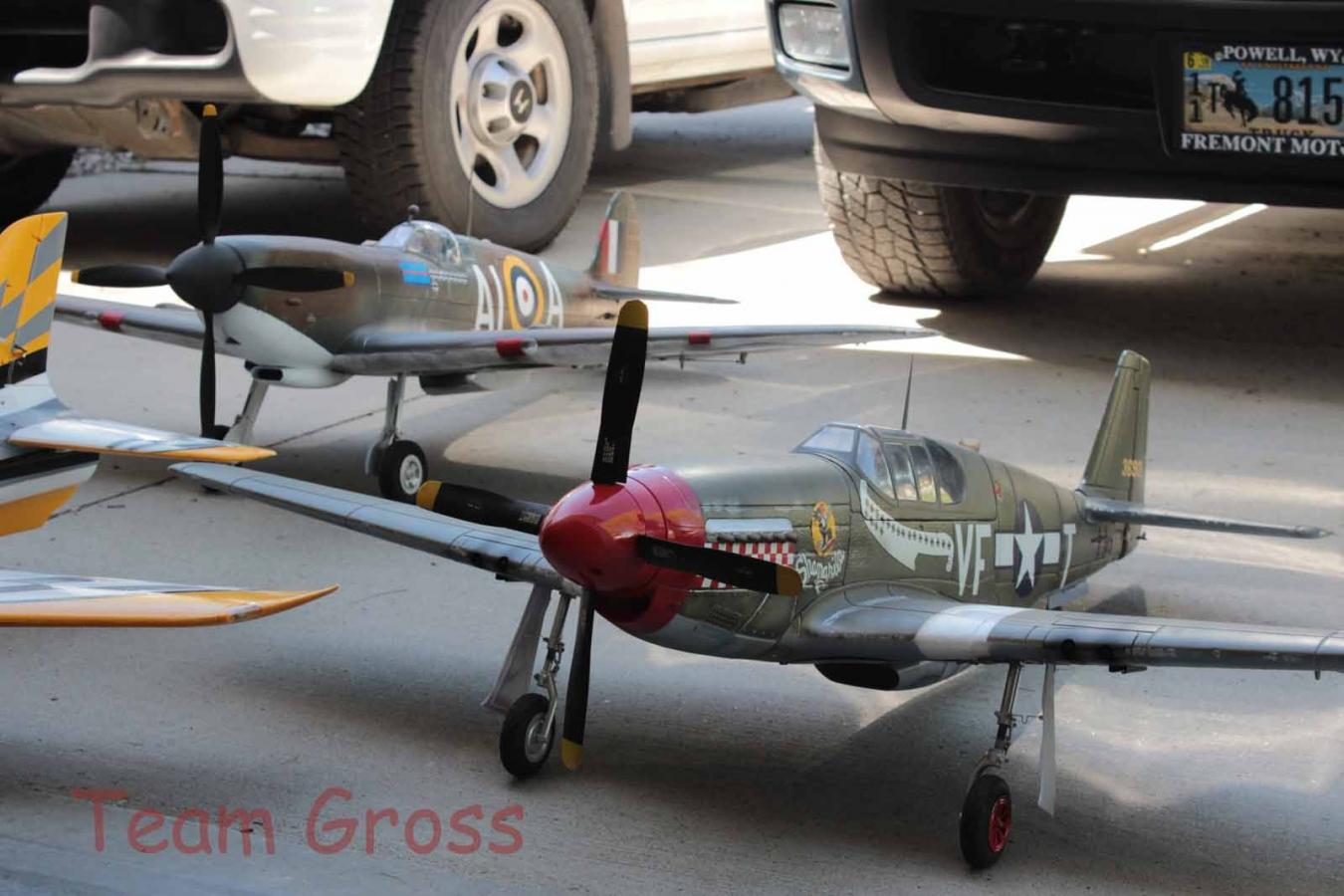

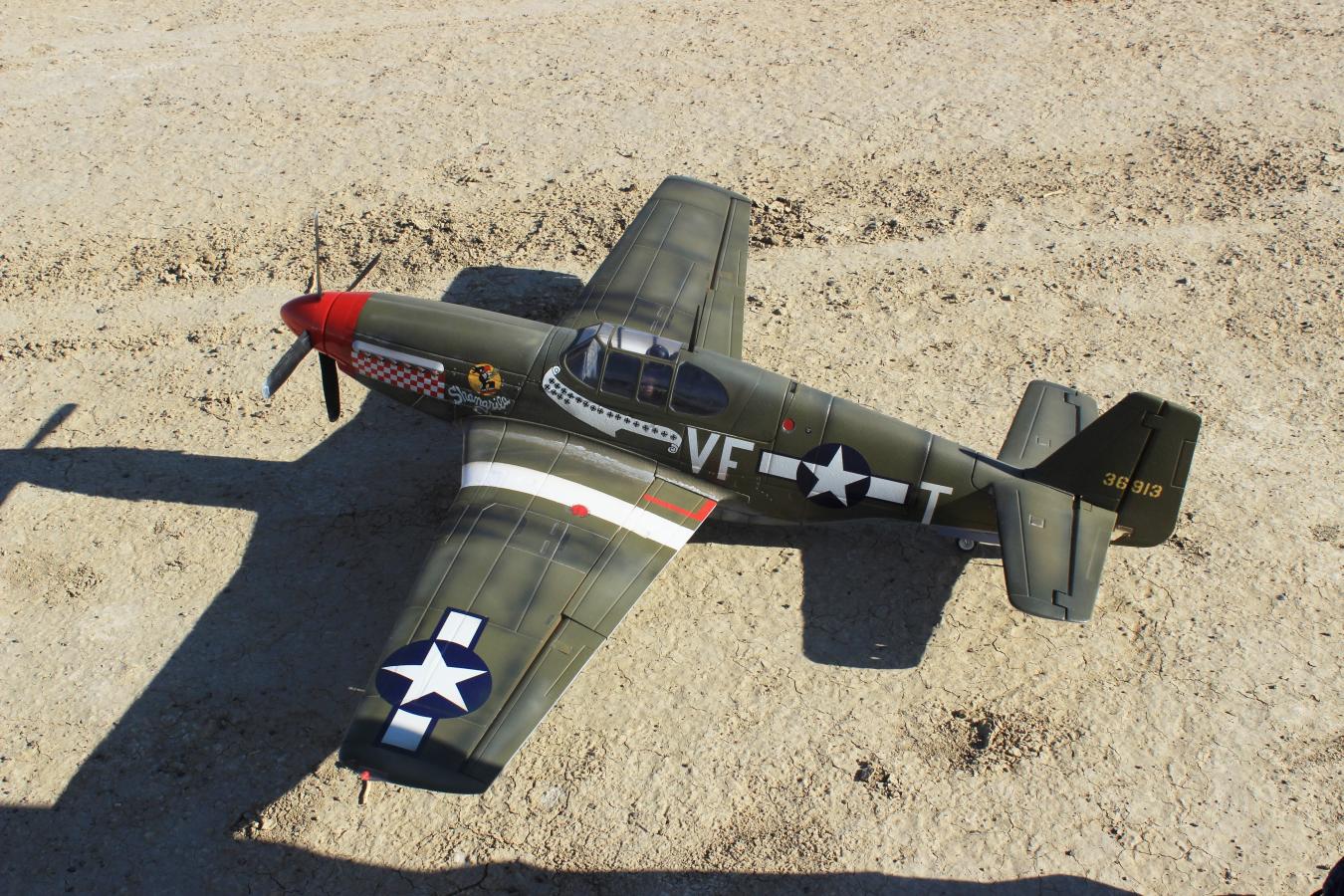

    This pains me to say it, but on Tuesday I lost my P-51B Shangrila:(...
    She was flying in her usual great way, I came out of a loop and was bringing her around to drop gear and land when all of a sudden, she was bucking and extremely difficult to control, totally not her. Got the gear and flaps down and tried to line her up with the runway, but man I was fighting her to try to level out, almost like a near stall, but she had plenty of speed. Before I could get her under control, she lawn darted, spun right into the ground a total right off:Crying::Crying:...
    This is a bird that I've flown steadily for the past 4 years, the first warbird I ever flew and the first spray paint job I ever did. She meant a lot to me, the most I've replaced on her was the tires last year, talk about a great airplane!!
    God knows how many flights I have on her and worse, they don't make them any more!!!
    Post crash analysis revealed that the gyro had come loose, explaining why the poor control. I installed that gyro 4 years ago when I originally built her and never paid that much attention to that aspect of preflight checks, but in hindsight, tape does tend to lose its grip over time, so I went through the whole fleet to ensure that this doesn't happen again. Rotten way to lose such a great plane, so I'm passing this on hoping it saves one of you guys from having to lose a great airplane....
    Click image for larger version  Name:	2014 009.JPG Views:	0 Size:	112.6 KB ID:	188371Click image for larger version  Name:	Cowley Fly In Day 2 153.JPG Views:	0 Size:	272.7 KB ID:	188372Click image for larger version  Name:	IMG_3045.JPG Views:	0 Size:	189.1 KB ID:	188373Click image for larger version  Name:	IMG_2376.JPG Views:	0 Size:	106.5 KB ID:	188374Click image for larger version  Name:	IMG_2281.JPG Views:	0 Size:	123.3 KB ID:	188375
    By Old Girl, you'll be missed...…
