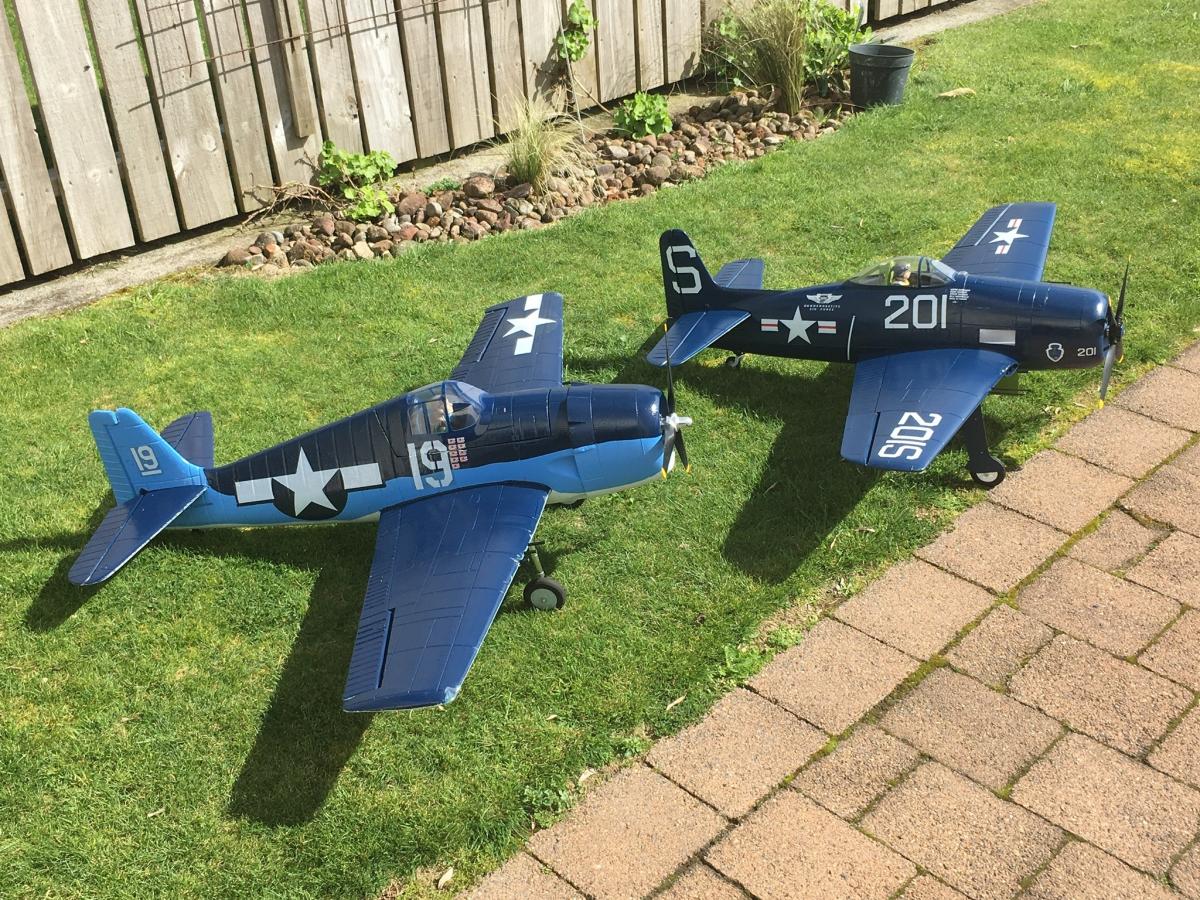

      Great Minsi III represented here! Dave M. was the man in the carrier wars, and you are the man in painting this model to look just like his fighter! I've got the version 1 without flaps...and this makes me want to copy yours! Nicely done sir!
      • #43
        Thank You!
        Current Fleet: Flightline Tigercat, Flightline Bearcat, Eflite Corsair, ESM Skyraider, Pilot RC Yak-54 30%:corsair
