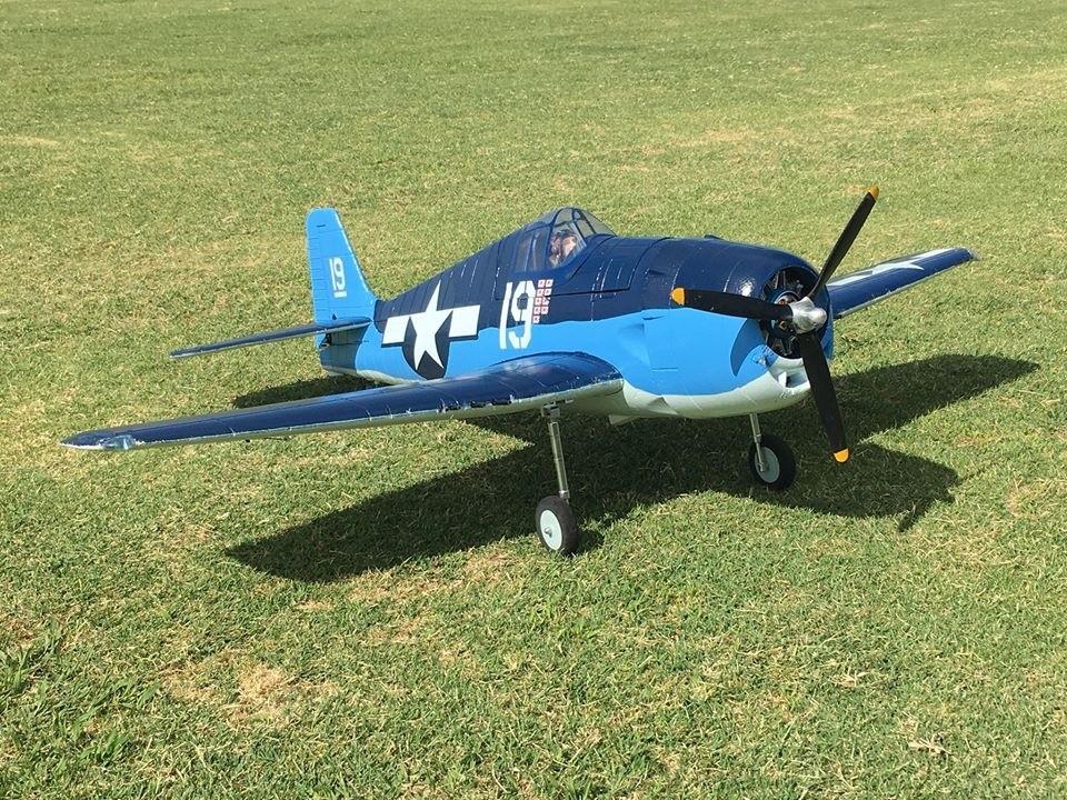

                              Here's my Dynam Hellcat. She has the power system I mentioned before, the retracts are FMS out of a P40B and the legs are indeed oleos. I've 3D printed some 4° shims or "wedges" that I have inserted between the retract and the retract mount with the thick end at the rear in order to push the wheels just a shade further forwards so it's not so easy for it to do the "stink bug" when landing on grass. It took me a while to get this plane to fly and land how I like it to but it's worth it now it's done. The 740kv SK3 motor and MAS 13x8x3 prop work awesome on this plane, it looks "in proportion" and it will handle a "full throttle" flight with ease-the only thing being warm at the end is the lipo. Definitely a fantastic airframe but (IMO) woefully underpowered in stock form.
