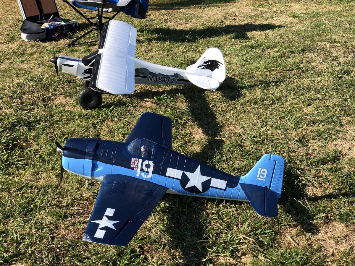

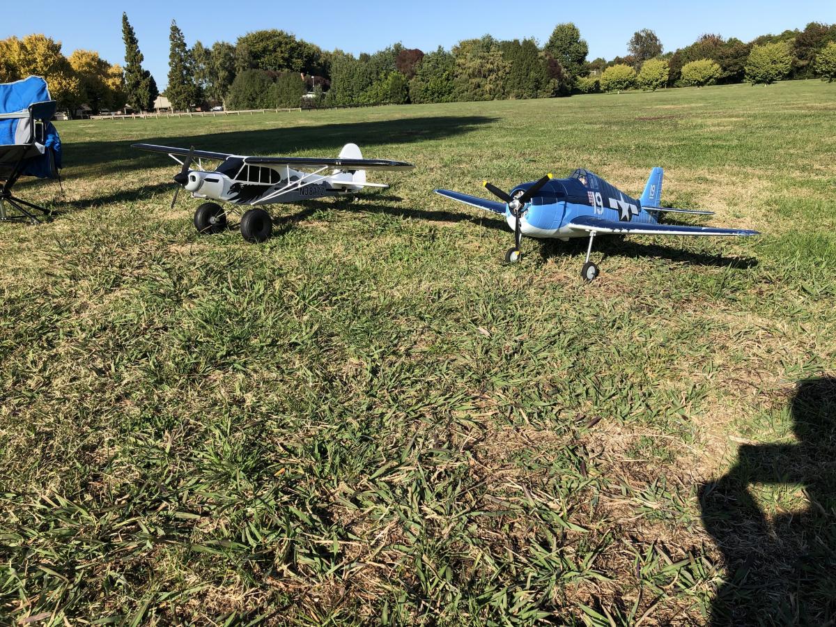

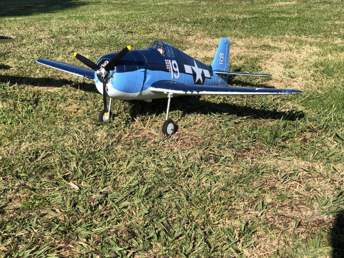

Decided it was about time I got my Hellcat out for a blast this week as it's been about 10 months since I last flew it. I generally use 4s 3000 or 4000 70c lipos in her as the power setup isn't stock so she really hauls the mail-forgot just how much fun this bird is to fly-plus she looks fantastic in the air. The retracts/oleo setup isn't stock either, hence the absent gear doors etc. Deffo gotta get this bird out more often!
Finally swapped out the retracts on the Hellcat. Used the Eflites for the Corsair. Swappedcout the gear legs as the Corsairs are to short. Dropped right in and now work flawlessly. Also added a GT power sound system. Sounds ok but not great. Now I just have to get a calm day to fly it.1 Photo
