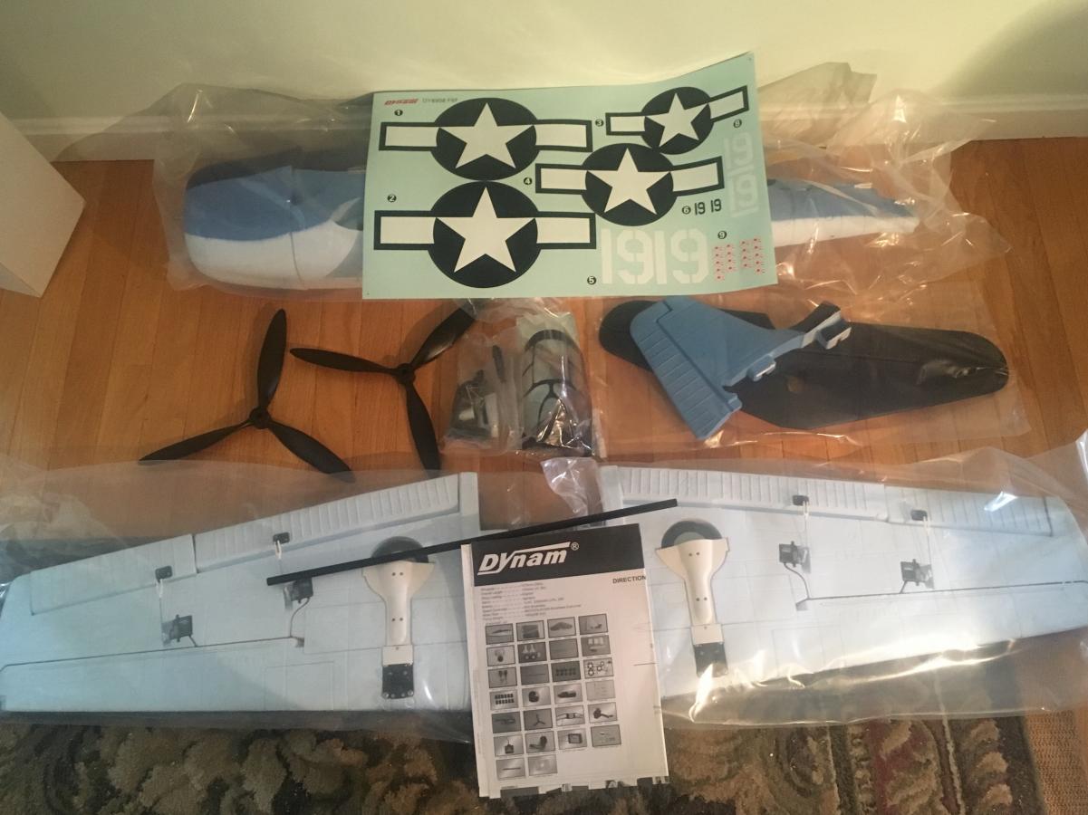

        This arrived today from MRC:
        Can't wait to put this one together. Being old and a noob you know I'll put at least one decal on upside down or backwards. It is how I roll...:wacky
        Building these planes is a lot more fun than building out a pedal board. Cost a whole lot less to boot!
          #64
          And probably the best flying dynam warbird of the bunch
            #65
            Cool, just too bad you cant ship some stuff out this way, ive heard how 2A unfriendly they are up there with alot of thinge. But yes the way they have them set up, the flaps do crease in the wings.
              #66
              Also almost forgot, dynam retracts are not reliable or durable, i would replace with eflite 1.2m corsair retracts. I did for this one and the dynam corsair. Much better durability and reliability.
