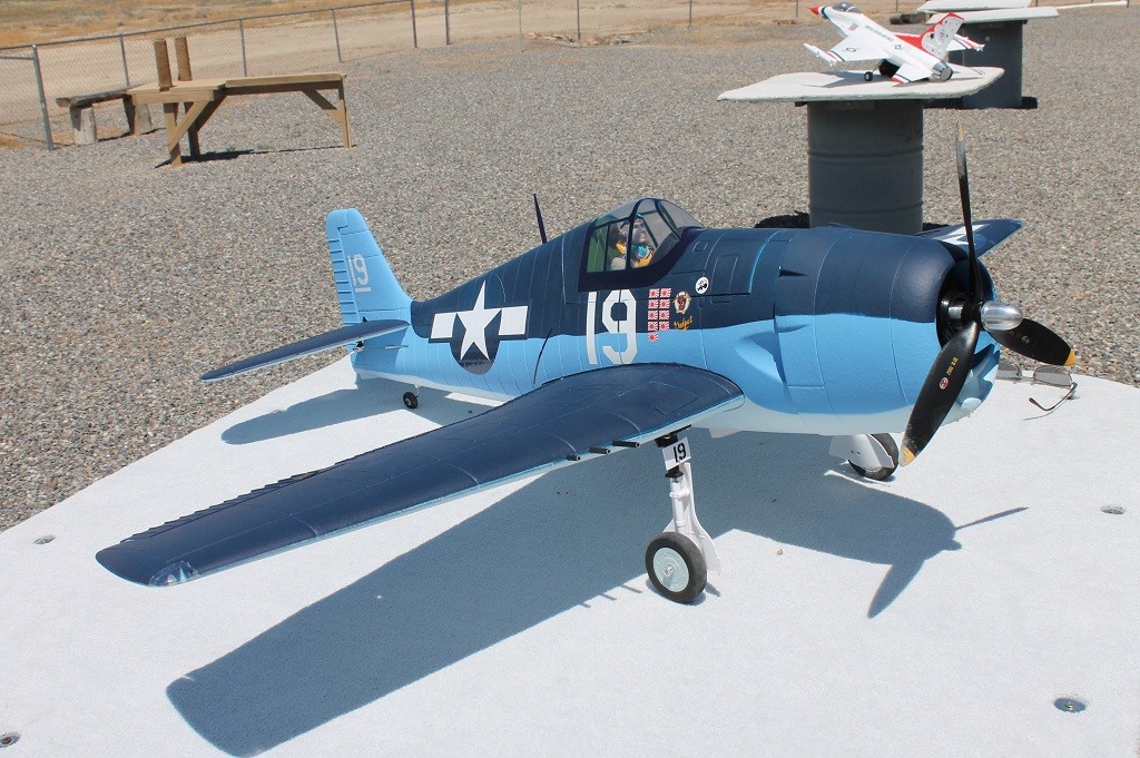

      Which Eflite retracts did you use? Any tips on installing them? I had my maiden flight yesterday. And, the landing killed these Dynam retracts. I'm happy with the plane overall. It looks and flies really nice.
      Click image for larger version  Name:	Dynam_F6F_001.jpg Views:	0 Size:	228.0 KB ID:	208891
      Edit: I found Atesvn's detailed post on the retracts and flap mods.

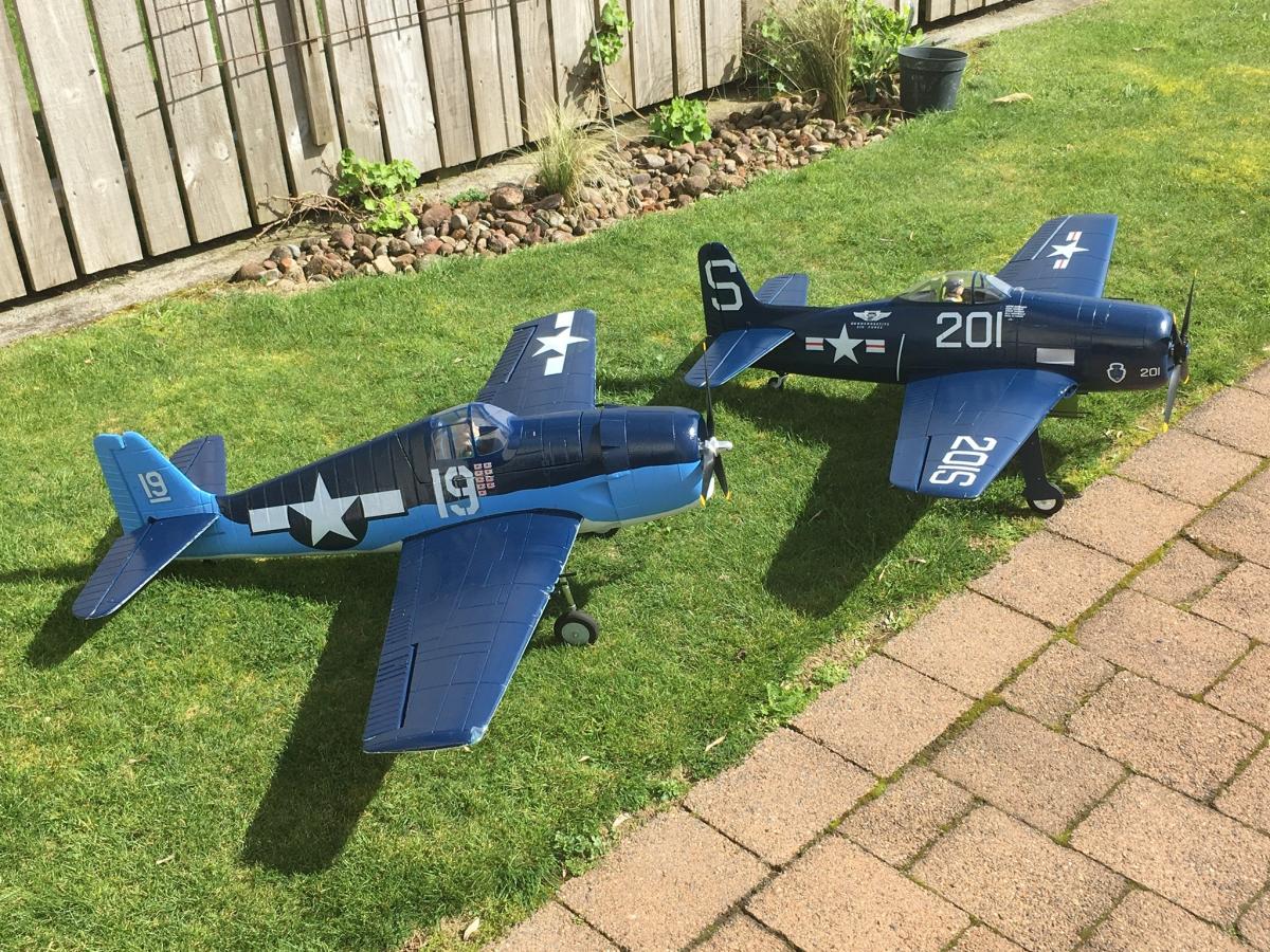

                I used the FMS P40B retracts on mine and also added some Hobbyking sourced sprung oleo struts. After that I 3D printed some 4° wedges and put them between the retract and the retract mount (to push the wheels forward when the gear is down). Best thing I ever did, plane has awesome landing gear now.
                Power setup wise I used a turnigy SK3 740kv motor (they only do one)-it's rated 65a and 880W. I put a 13x8 MAS prop on (same as stock but smaller chord length),and a hobbywing 60a ESC. I had to use the dynam Geebee dome nut to hold the prop on the SK3 adapter. All of this is a direct bolt in fit with no mods required-when run up the plane pulls 800W-815W and 60-65a WOT Static (depending on esc timing setting). If you try to use the stock prop it pulls about 1300w (lots of heat) hence I went MAS prop the same size. Really nice power upgrade for anyone looking for a RELIABLE and proven setup that won't set fire to your plane. I had to learn the hard way when some dufus told me to stick the dynam beaver motor in "cause everyone does"...yea right-just about set my plane on fire it got so hot!
                Heres a video of mine with the above mods:
                Last edited by Builda; Sep 1, 2019, 05:40 AM. Reason: corrected spelling, added ESC

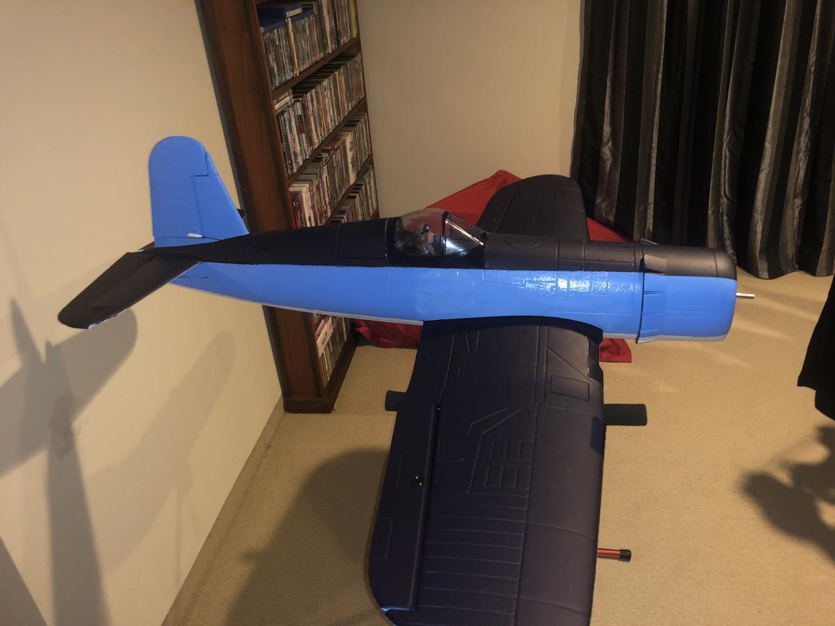

                            Thanks to Motion's usual quick shipping, I have mine and have started the repaint. I had seen some horror stories regarding fit and finish on these, but mine seems pretty good. I'm am replacing the less than spectacular Dynam LEDs with some from Lighthouse LED and I'm adding a white tail light.
                            Has anyone here added a center line drop tank? If so, did you uses something already available or did you have to make it from scratch?
