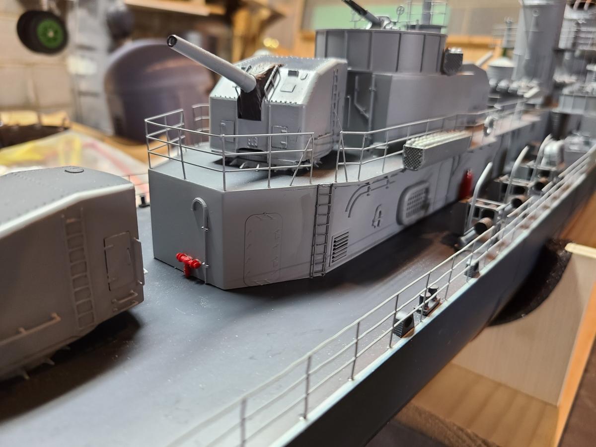

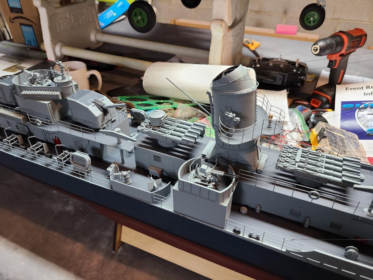

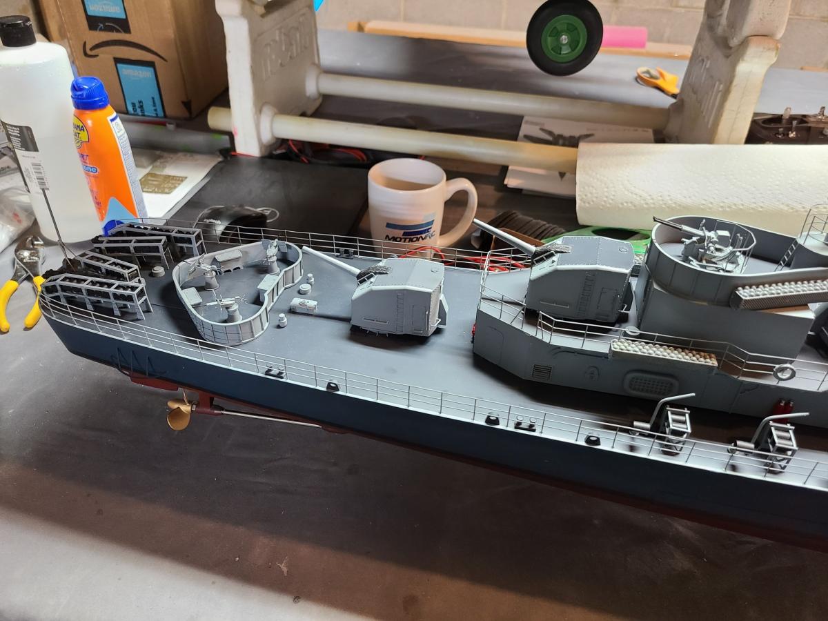

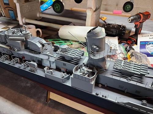

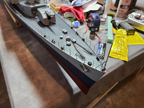

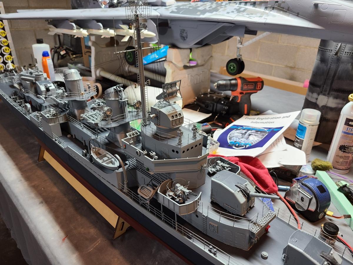

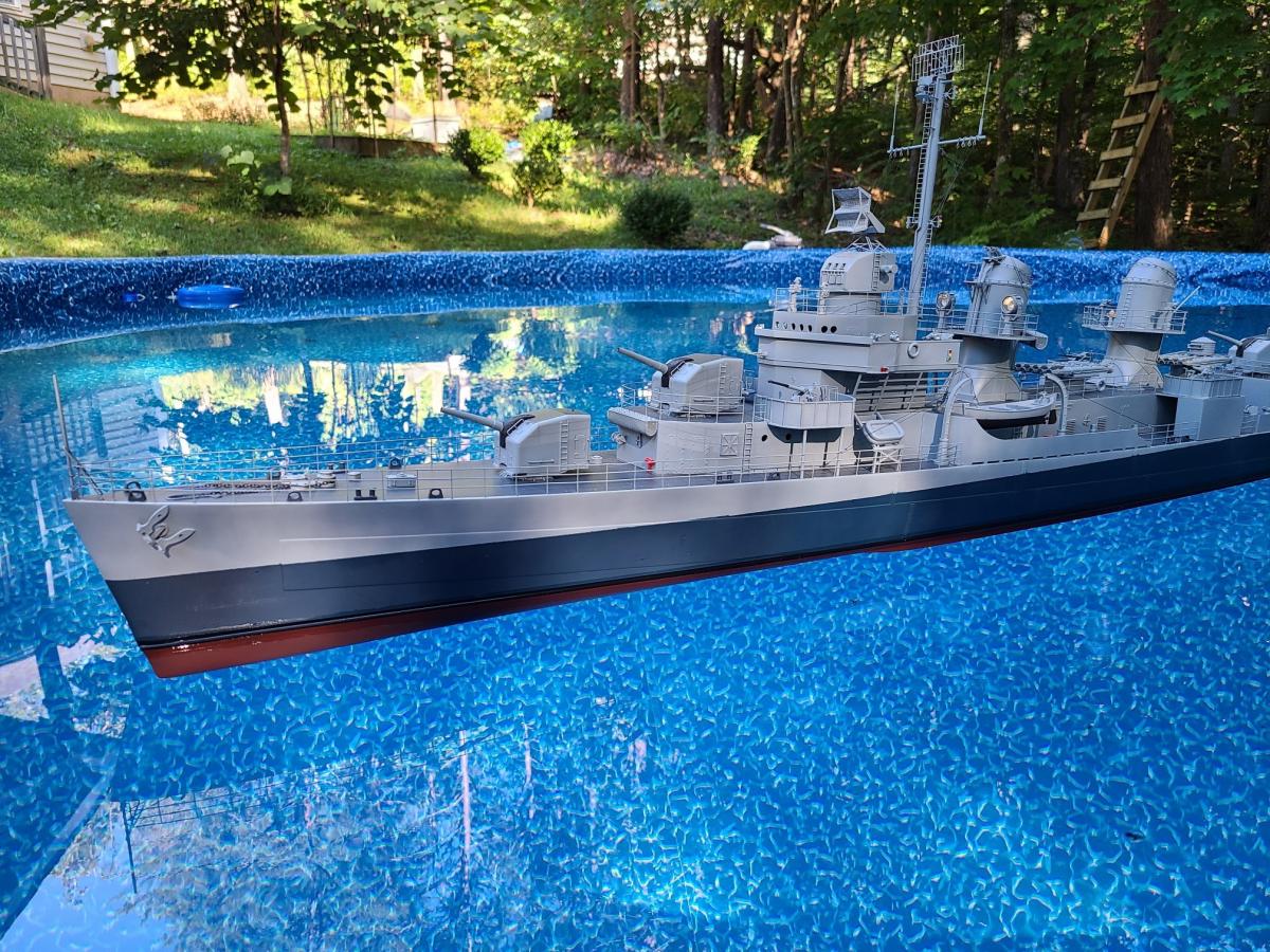

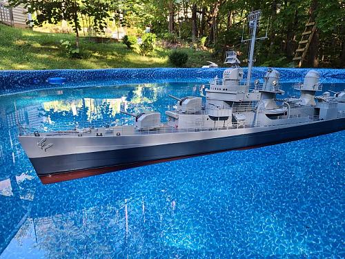

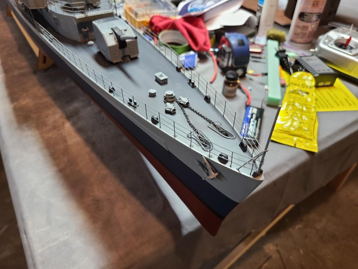

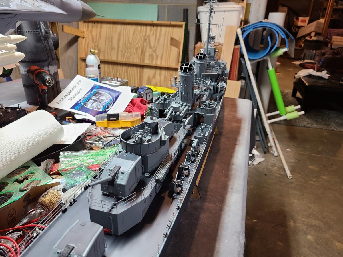

            I got mine over the weekend while I was at Subfest in Cohutta, GA. We had a great event. Wished the Fletcher could have made it in time. I too had some minor damage of bent rails and parts that fell off and one gun barrel needed the heat gun treatment to straighten it out. I checked everything thoroughly but could not locate one small ladder. No biggie as I will 3D print a new one from ASA. None of the damage was a show stopper as already mentioned and it is a gorgeous boat. I am just a boat/sub nut having never served in the Navy so I plan a simple Greyhound scheme. Here are some right out of the box after a couple hours of TLC shots. I still need to add some ballast but hope to soon have some nice shots of her at the local lake. It would have been nice to have a diagram for where things went and how the rigging was supposed to go but I figured it out. Overall very pleased. I would ultimately like to add smoke, some lights, maybe automate a few turrets and add some weathering.

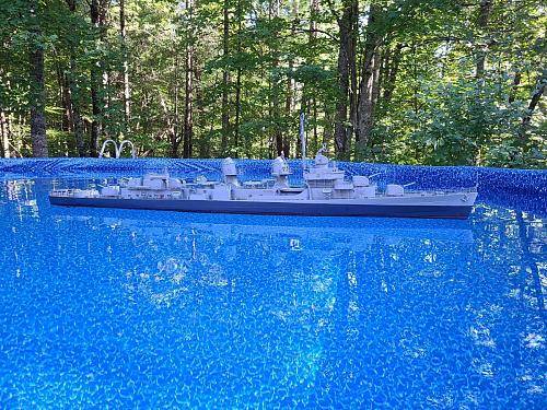

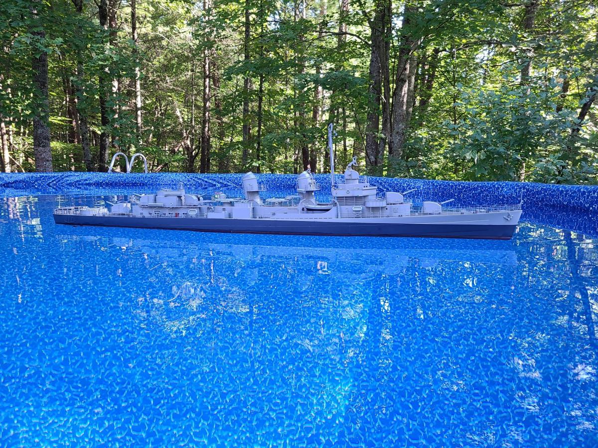

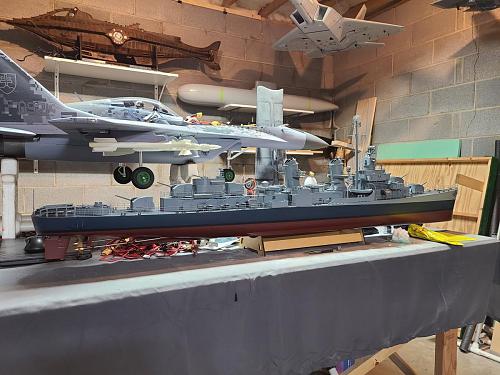

              She's ready for the lake.

                I moved the rudder pushrod one hole closer to center to give it a little more turning authority but got her to the lake this afternoon. She handles well and has what appears to be a higher than scale top end speed. Here is video of her maiden voyage.

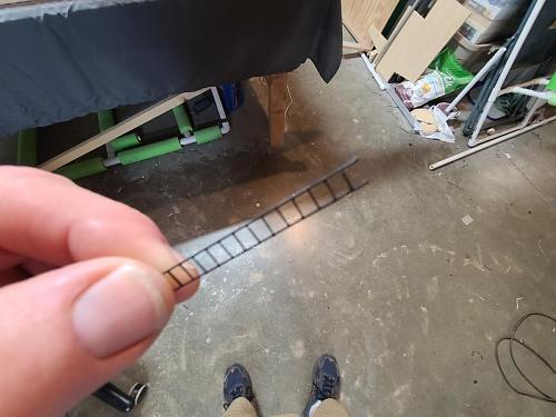

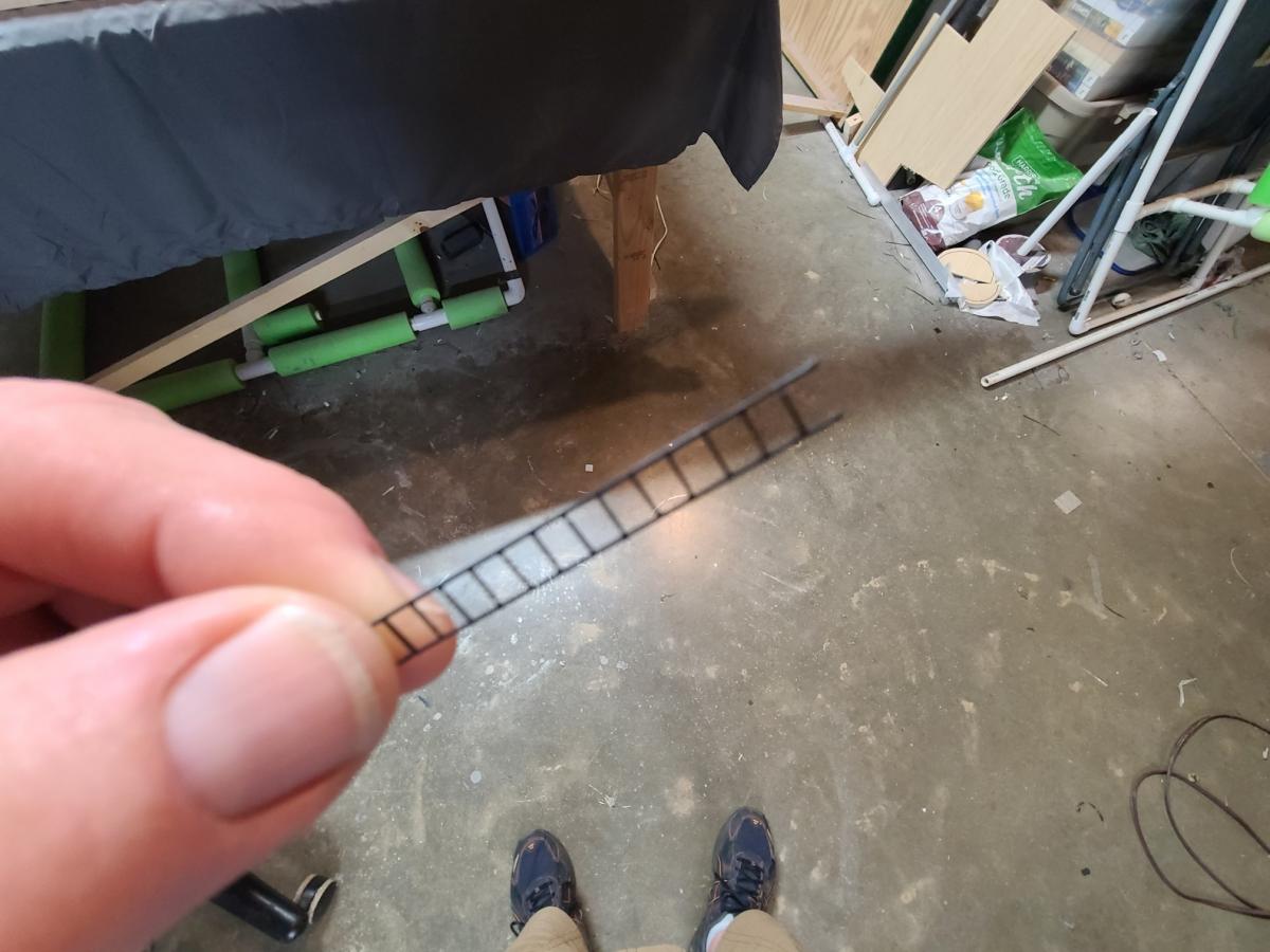

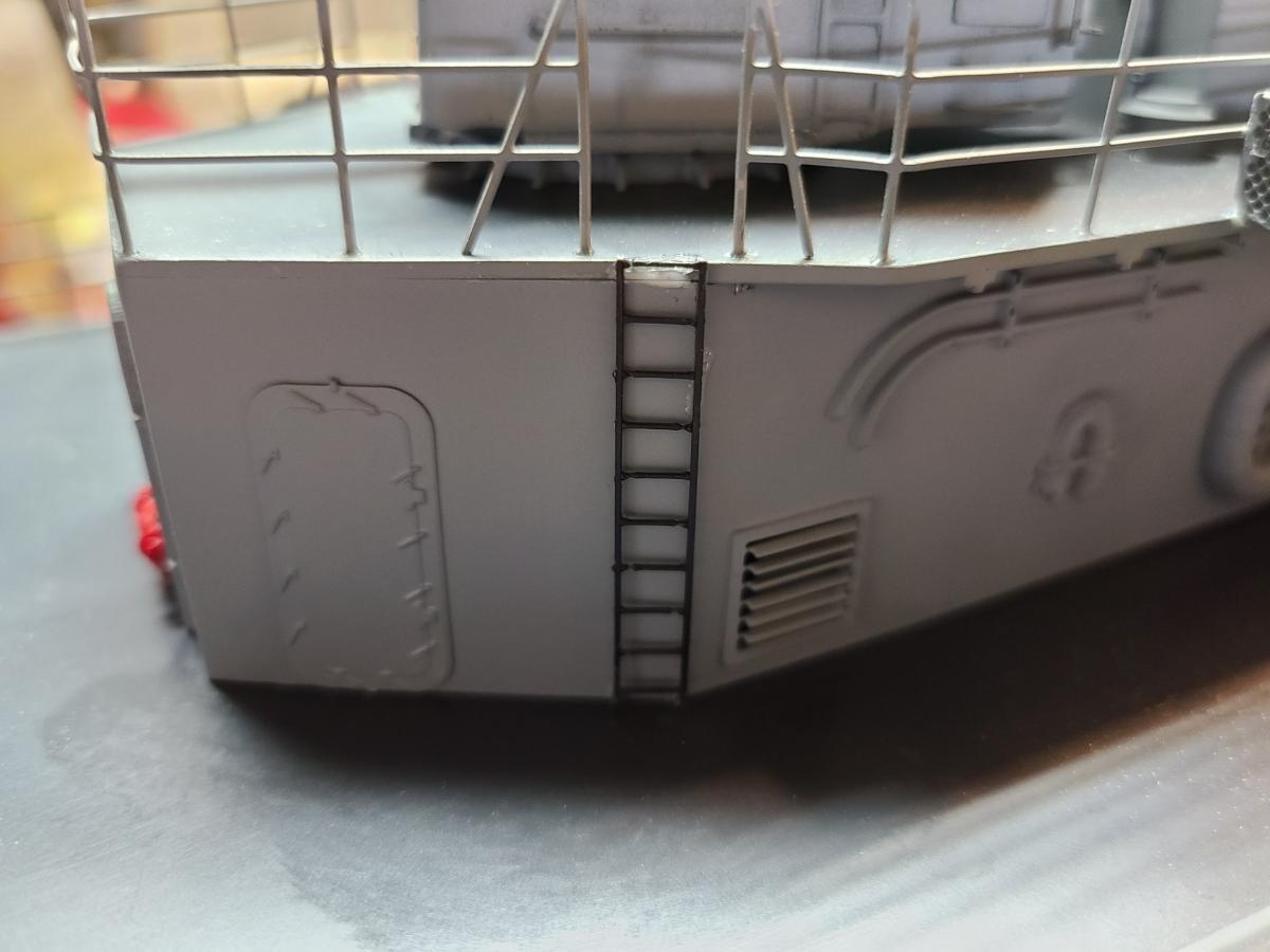

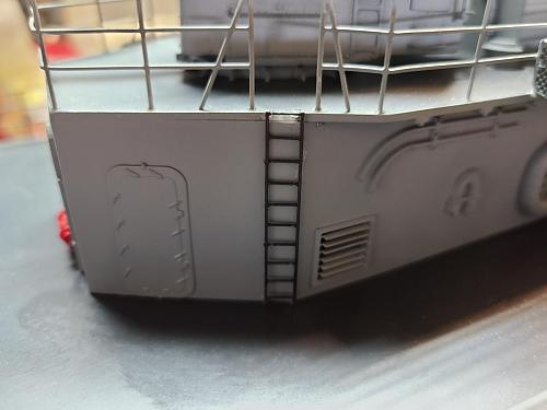

                    As I mentioned earlier, mine was missing a ladder. I copied the dimensions of other ladders present on the boat and designed a ladder in Fusion 360 then printed it with ASA. Viola! All better now.

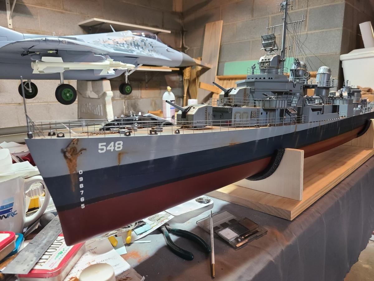

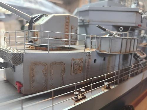

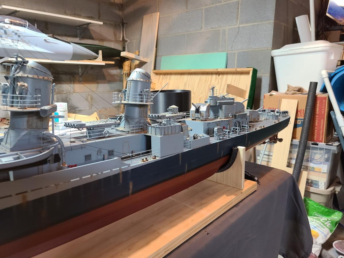

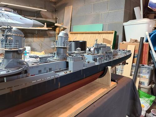

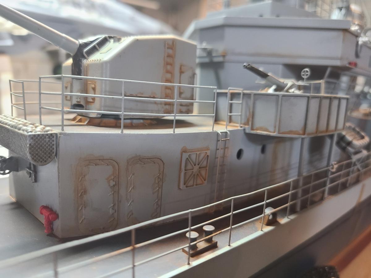

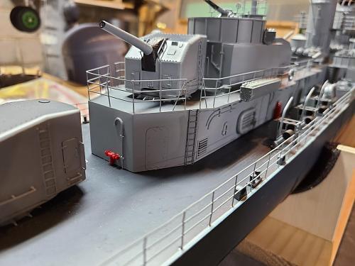

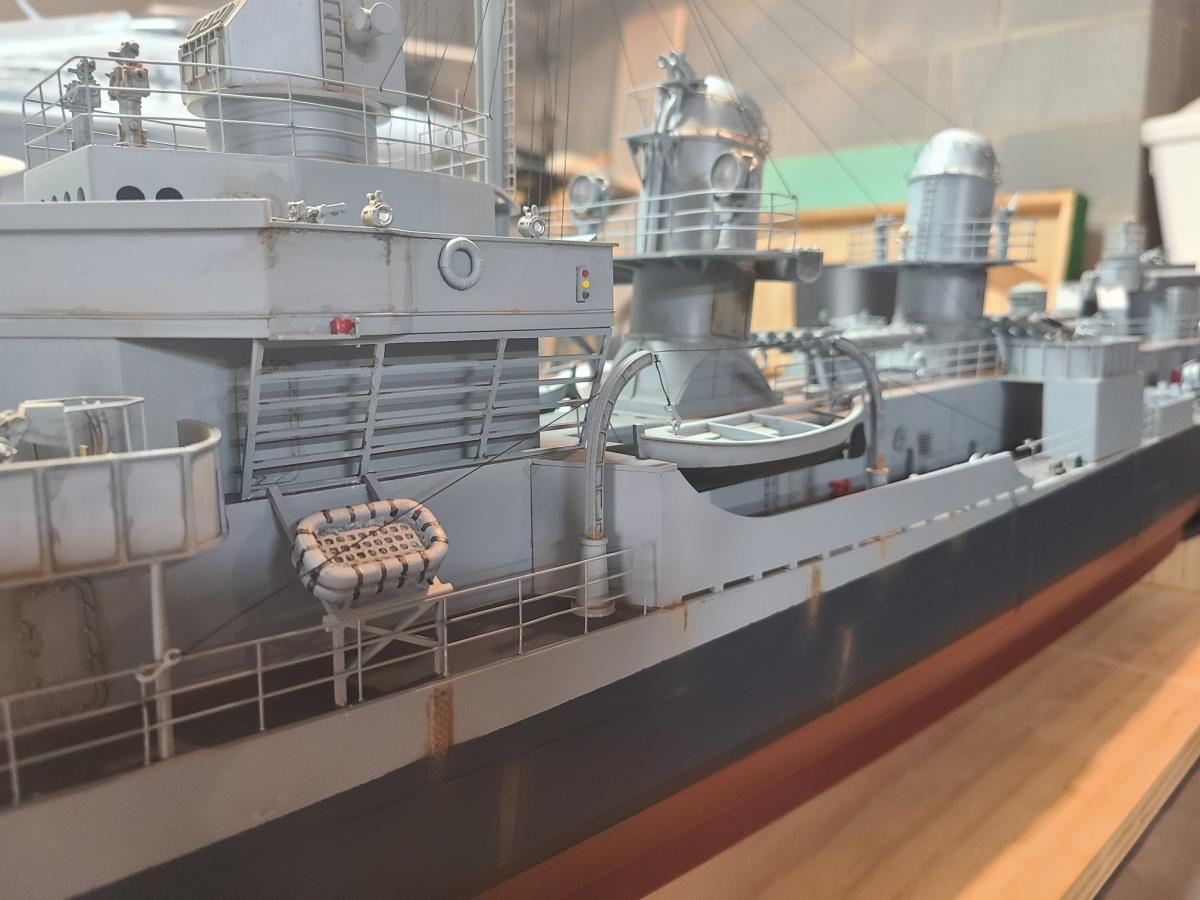

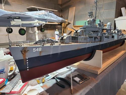

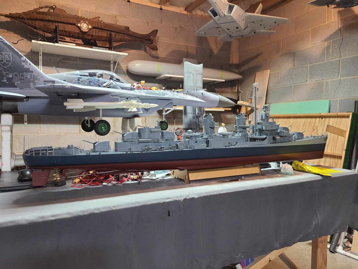

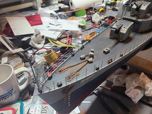

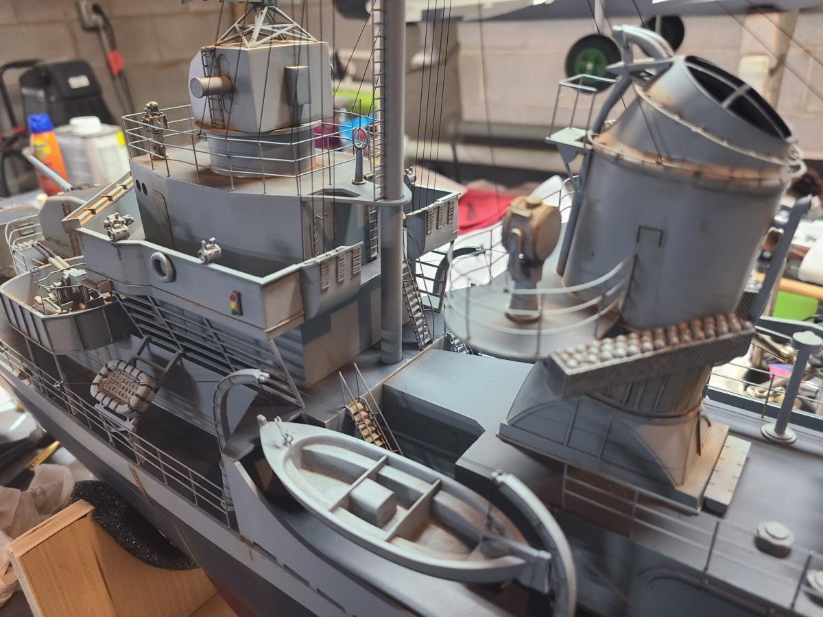

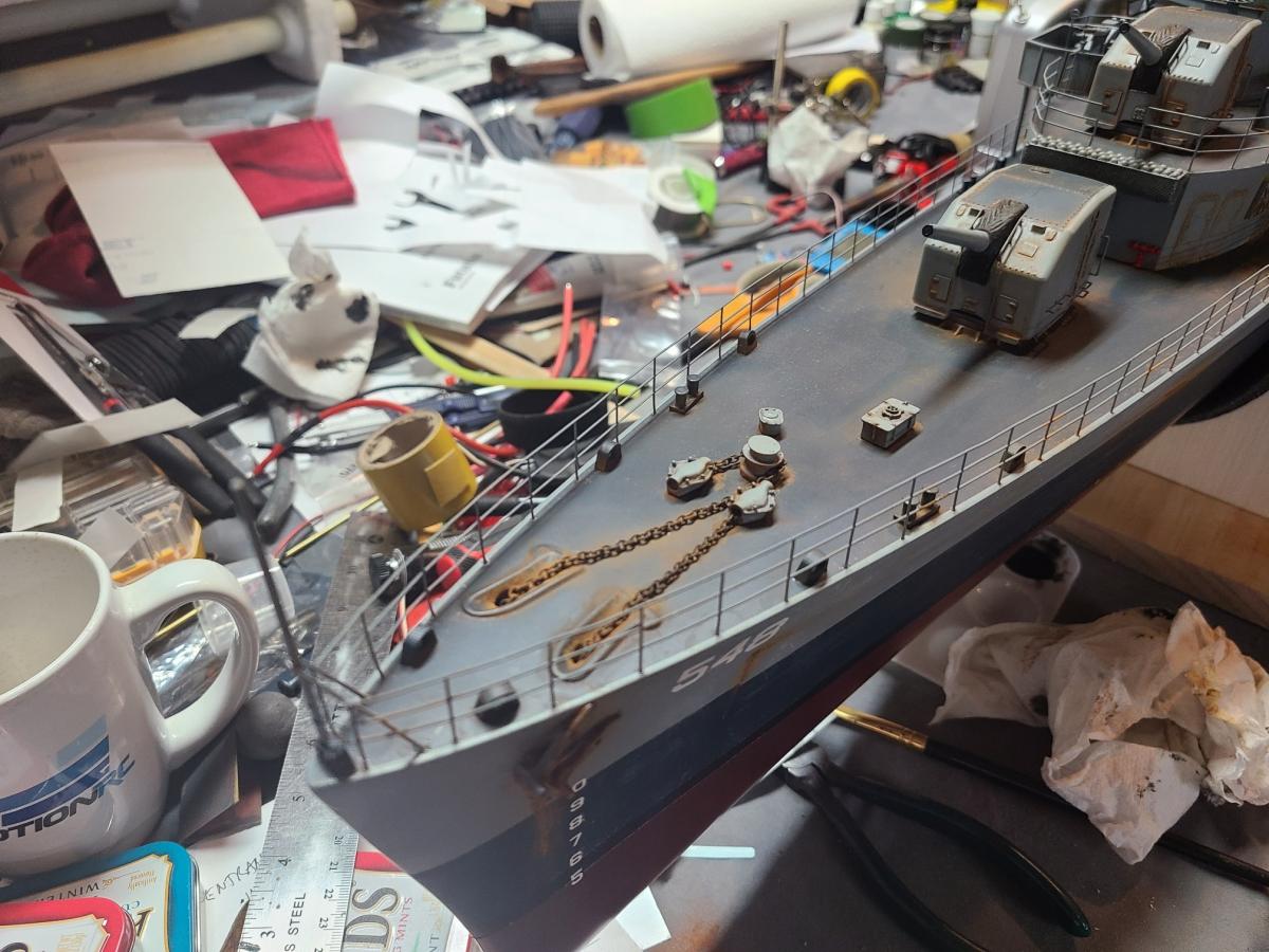

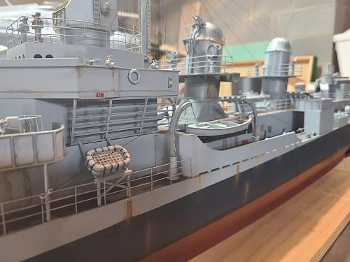

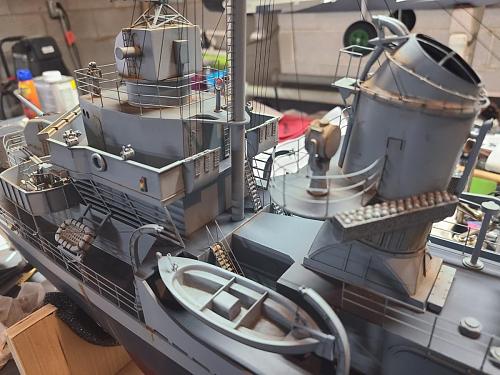

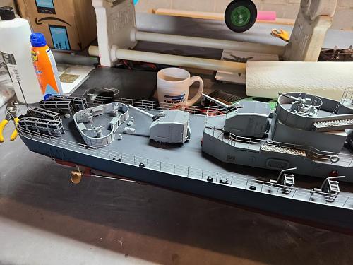

                        I've gotten a little weathering done on it. My first time applying a pin wash. I have also applied some Modern Masters Metal Effects Oxidizing Iron paint, old rust powder pigment and some white pigment.

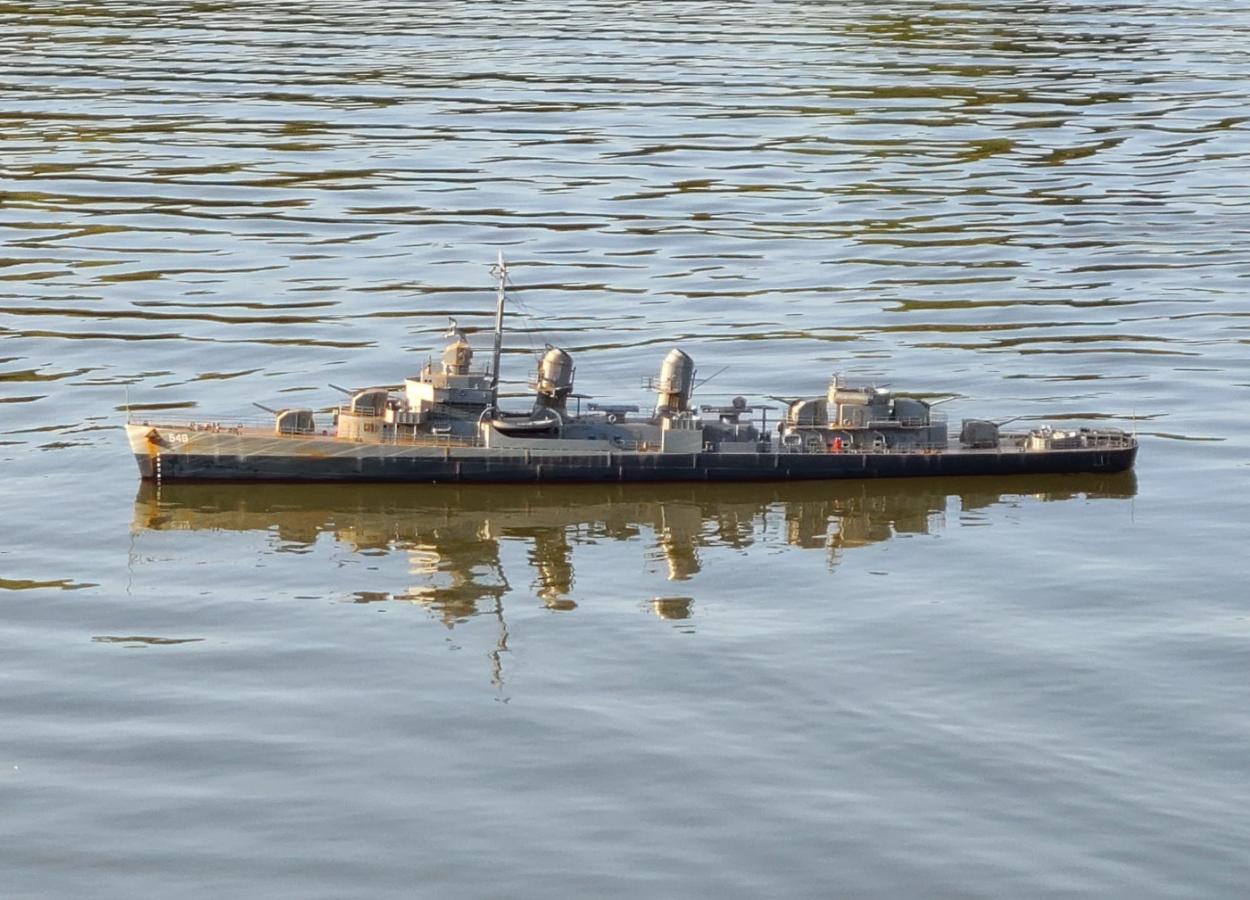

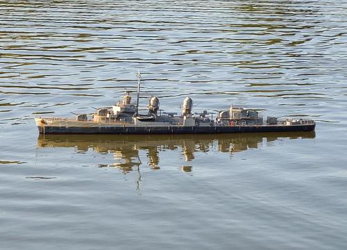

                                Ran mine again tonight. Still no issues other than wrapping a blade of grass around the port propeller. It needs smoke.

                                    Great job! What kind of software and hardware needed to do this? What is the set up cost? Thanks Dai
                                      #58
                                      I am using an Ender 3 Pro with an upgraded control board and touch screen display, mirror glass instead of the magnetic build surface and a third party hot end with titanium heat break. My printer is in a heated enclosure (it's actually a kitchen corner wall cabinet). Using Simplify 3D for my slicer and learning Fusion 360 for CAD. I use Magigoo on the build plate to keep the ASA parts from warping on the bed. So far it has worked great! When cool they just pop right off. I have less than $700 in my whole setup including the one time licensing fee of $150 for S3D.
