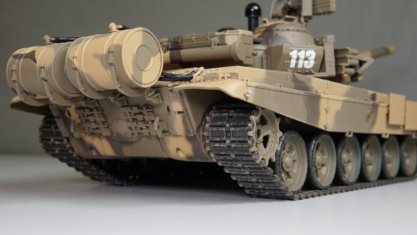

    Like all of Heng Long's 1/16 tanks, the T-90 is primarily composed of ABS plastic, which is nicely molded. Overall the parts are molded nicely, although there are noticeable sink marks on some of the ERA panels along the turret. The paintwork is excellent, and the various shades make an effective camo. The sheen of individual parts is uniform, and nothing stands out. I like the sharp contrast between the flowing camo paintjob and the blocky areas on the turret and along the glacis and forward lower hull, seen below.

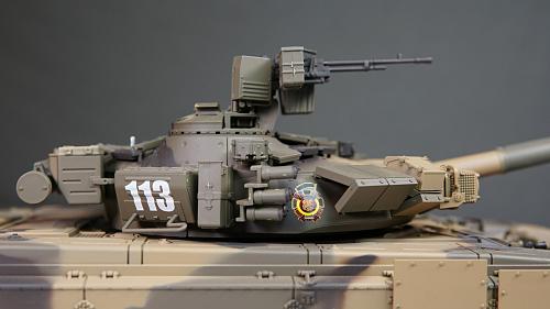

    The T-90 includes more than ten sprues of plastic "Cosmetic Accessory Parts" for the modeler to install on the tank. See the Video linked above for the large pile of plastic, which for a modeler like myself is always a welcome sight!
    These "Cosmetic Accessory Parts" all plug into pre-drilled holes, and are nearly "snap fit". Be careful of the rear turret bustle bin, because its arms are somewhat fragile. The rest of the parts assemble easily. Following the Video linked above and the clear diagrams in the instruction manual, I imagine most RC modelers would have no problem installing these parts in 60-90 minutes.
    I didn't glue on any of the parts, and don't expect to. I prefer being able to remove the turret mounted machine gun during transport.

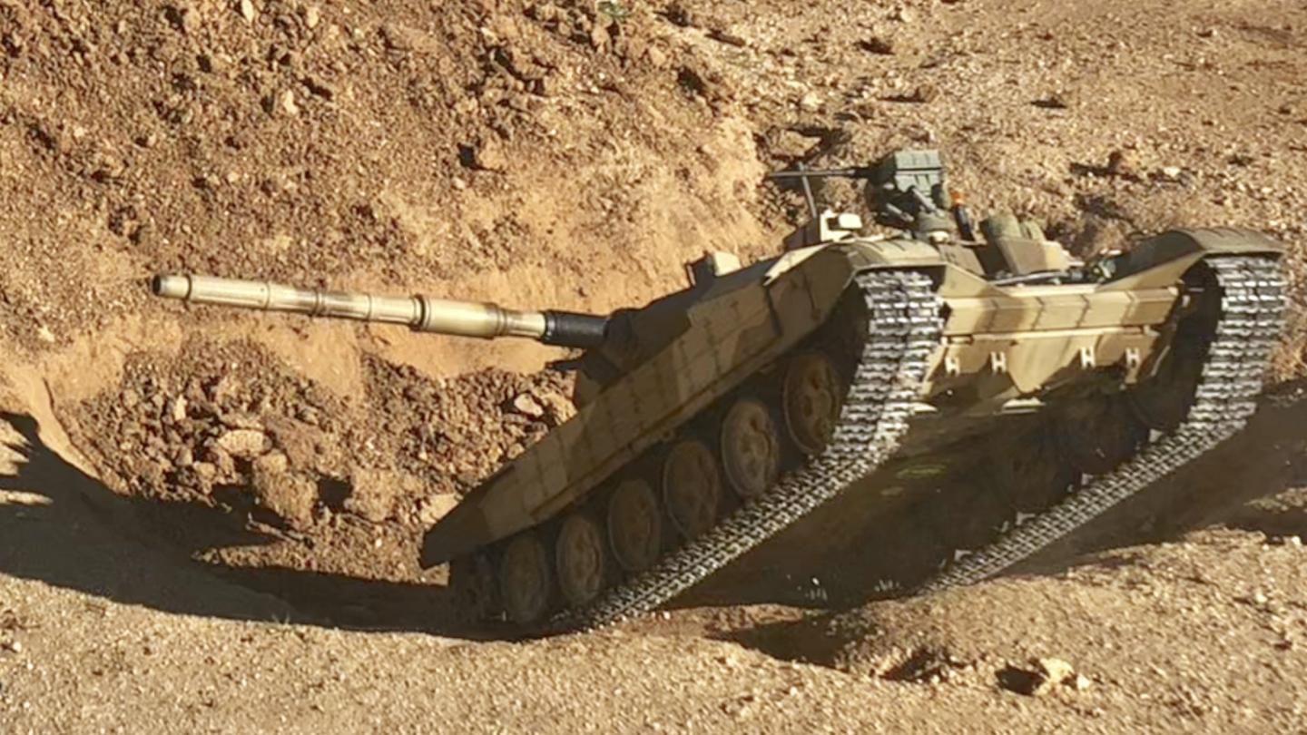

    The Upgrade version available from Motion RC does not use Zinc Alloy gears like Upgrade versions of years past. Rather, as of 11/2019, all of Motion RC's Upgrade version tanks include Steel gears, which are superior to the old Zinc Alloy gears in every way. While the remainder of the tank's running gear is ABS plastic, I prefer this Upgrade version because the steel gears in the gearbox are very durable, yet the plastic tracks keep the tank light and maneuverable. The Challenger II is already such a large tank that it has a good weight without extension metal parts. The Professional version replaces the plastic tracks, drive sprocket, and idler wheel with metal versions. This nearly doubles the weight of the tank, and increases the cost as well, so I recommend the Pro version for tankers who don't mind having a shorter drive time or having to buy a couple spare batteries. The durability and heft of the Pro version will appeal to those who want weight above all other considerations.
    The Upgrade configuration of the Challenger II can climb comfortably at 35 degrees with good traction, but begins to slip nearing 45 degrees. Like other tanks at the Upgrade level, the plastic tracks grip most surfaces well, although it tended to spin out sometimes on tile floor.

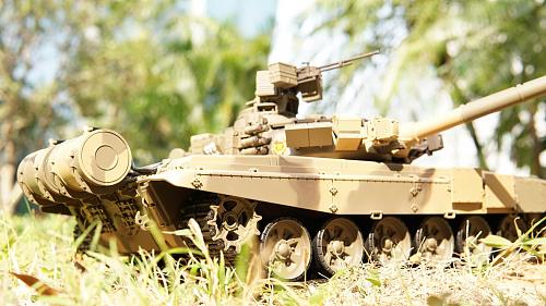

    Indoors, the sound is very loud, the LED headlight is bright, and the smoke is easily visible. Outdoors, the sound is still readily audible and the LED is also visible in daylight, but the smoke becomes difficult to see. This is just as well, since the real tanks weren't constantly venting smoke as if they were on fire, so I don't mind the reduced visible volume in daylight. The Challenger II has two exhaust ports, just like the real tank, and these are easily accessible under plastic grates. This makes refilling them with smoke oil very easy to accomplish.

      The real T-90 is a reasonably quick tank, powered by a V12 diesel engine. Heng Long's 1/16 T-90 moves at a walking pace at full throttle on the High setting and about 25% slower on Low setting. The High setting is lower than the top speed of the real tank, but in practice I don't find the stock T-90 sluggish for most users. Hold G and move the left stick up or down to select the High or Low setting, respectively. As expected, the T-90 is fastest on harder surfaces.

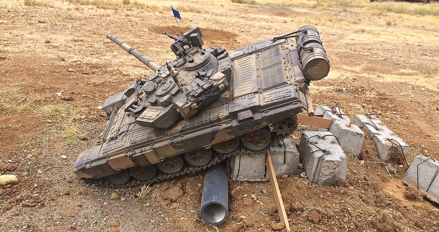

      Short grass and dirt lots are just fine, too, as long as the T-90 is on the move! The tank begins to bog down in grass that is tall enough scrape the underside of the lower hull. Use gradual turns while moving forward to minimize track shedding, and avoid spinning in place on grass.

        Metal suspension arms are a plus for durability, but the underside hull of the T-90 is highly detailed with several protrusions that are vulnerable to scrapes and dings when driving through rubble. The road wheel layout resists debris accumulation and the sprocket tooth geometry appears modified from scale but it has proven reliable so far during my ~10 hours of running the tank.
        Customers wanting the added rigidity and durability of metal tracks, metal idler wheel, metal road wheels, and metal drive sprocket should consider purchasing the more expensive "Professional" version.

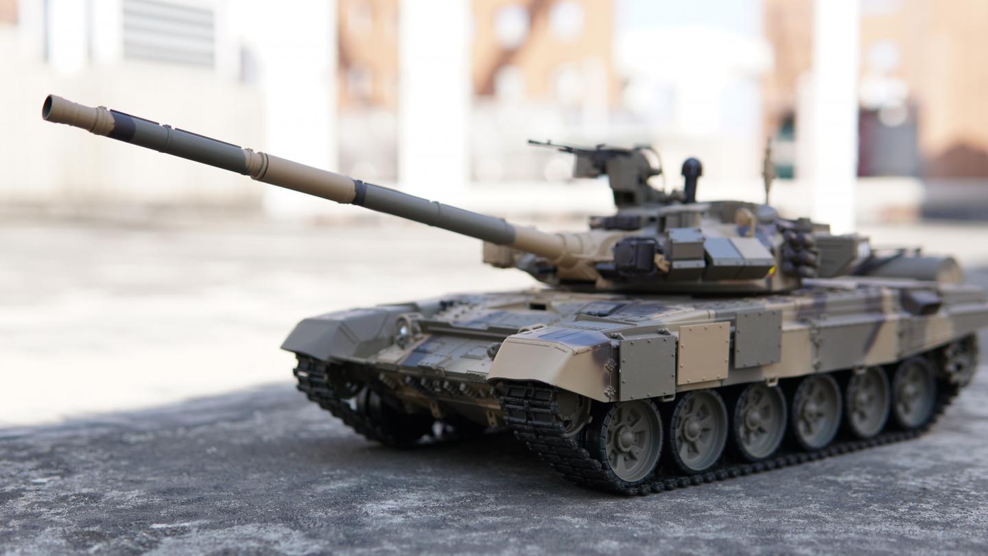

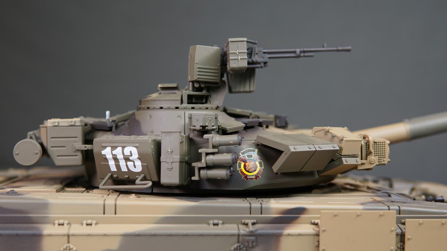

        Scale Fidelity 90/100
        Several sprues of plastic parts are provided for the modeler to install on the tank to enhance its overall scale appearance. These all plug into pre-drilled holes, and are nearly "snap fit". I prefer to keep the parts unglued so they're easy to remove or replace if needed in the future. Installing the plastic "accessory parts" took over an hour to complete because Heng Long's T-90 has the most cosmetic accessory parts of any tank in their 1/16 scale lineup. I recommend using a sharp clipper designed for removing plastic model parts from plastic sprues, as it makes cleanup much easier. The accessory parts are pre-painted and really enhance the tank's overall surface detail, especially in the way that the T-90's camo pattern undulates and flows from surface to surface.
        Click image for larger version  Name:	DSC00242.JPG Views:	1 Size:	126.0 KB ID:	221182
        Some areas of detail are necessarily softened at this price point and acceptable for a mass production RC tank, but overall this 1/16 scale T-90 looks good from almost any angle, like the Challenger II. The gun shroud is molded in plastic instead of being flexible like the real tank, but I can't see how else Heng Long could have executed this other than a plastic piece because the IR bulb is concealed in this area as well.
        Click image for larger version  Name:	DSC00237.JPG Views:	1 Size:	82.7 KB ID:	221186

            The T90 is one of my favorite R/C tanks to drive. I like to refer to is as the sports car of tanks, sits low, sleek, excellent handling and just plain cool looking racing at speed cross country.
            Here is mine playing on a tank obstacle course.

            About to jump over that ditch!!! Missed the photo of it being "airborn" it just happened to fast to catch with my phone camera.

                                Couldn’t agree more....RC tanks are fun to drive fast, hard and get “air” with, as long as they are set up correctly, it is safe to push the limits.
                                Modified and upgraded Heng Long T72 getting “air”...
                                Click image for larger version  Name:	D030F4B8-B926-448B-ADFB-5B5BAEF06447.jpeg Views:	0 Size:	200.5 KB ID:	237624

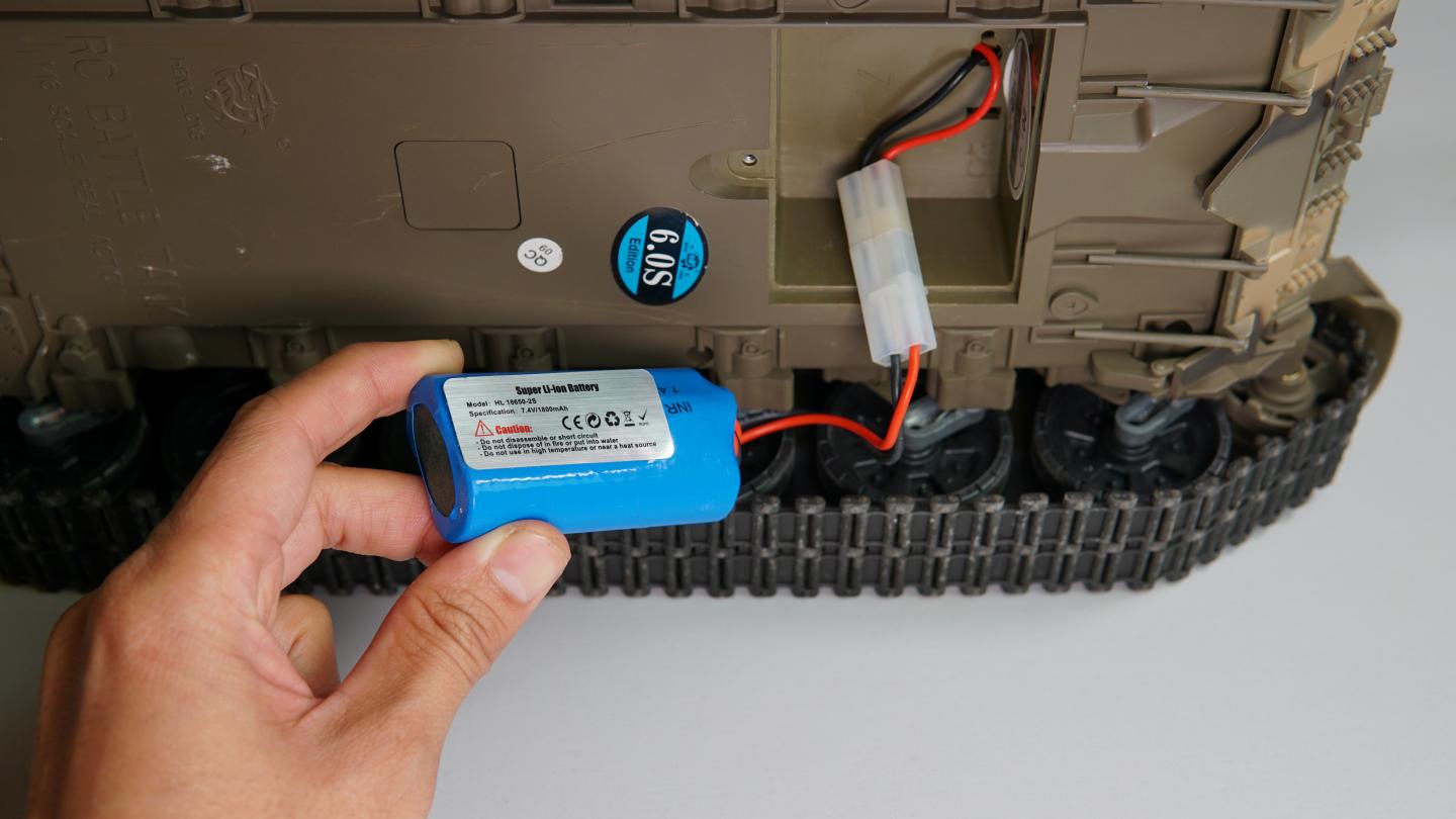

                                  Is there physical space in this tank to fit a bigger battery? If one wanted to perform surgery on the battery bay, can a bigger pack be shoe-horned in? Alternately, if the hull was fit with magnets or quick connectors is there space in the body?
                                    #18
                                    Davy101 Extensive surgery would be required to fit a physically larger battery inside the T-90 and still access it from the outside. You'd need to scratchbuild an entire length-wise battery box and externally opening battery door.
                                    As an alternative, we're selling an upgrade battery that fits in the existing stock battery bay, without any modification. This Upgrade battery doubles nearly the capacity of the stock battery, from 1800mAh to 3500mAh, and is made using Japanese Sanyo NCR cells. I'm using these in my 10+ pound T-90 Pro, and they're running great without the hassle of modifications.
                                    It is in stock and ready to ship today from the US warehouse:
                                    https://www.motionrc.com/products/ad...miya-connector
                                    • Davy101
                                      • 68
                                      • East KS, USA
                                      #19
                                      Alpha,
                                      Thanks very much! That addresses the real only down side to this model in my opinion.
                                      Edit: Tank and battery ordered! Now, get the Challenger II Pro back in stock...
                                      • Rubicon99
                                        • 3311
                                        #20
                                        Originally posted by Davy101
                                        Alpha,
                                        Yes you can. It is not hard to do. I run a 8 cel 9.6v full size NiHM 5000 mah battery in my T90 and T72s. You do have to remove the old battery box and you will lose the airsoft feature, but a large more powerful battery can fit.
