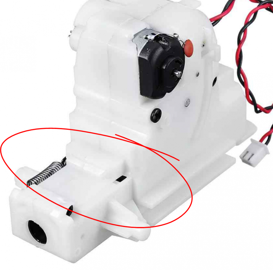

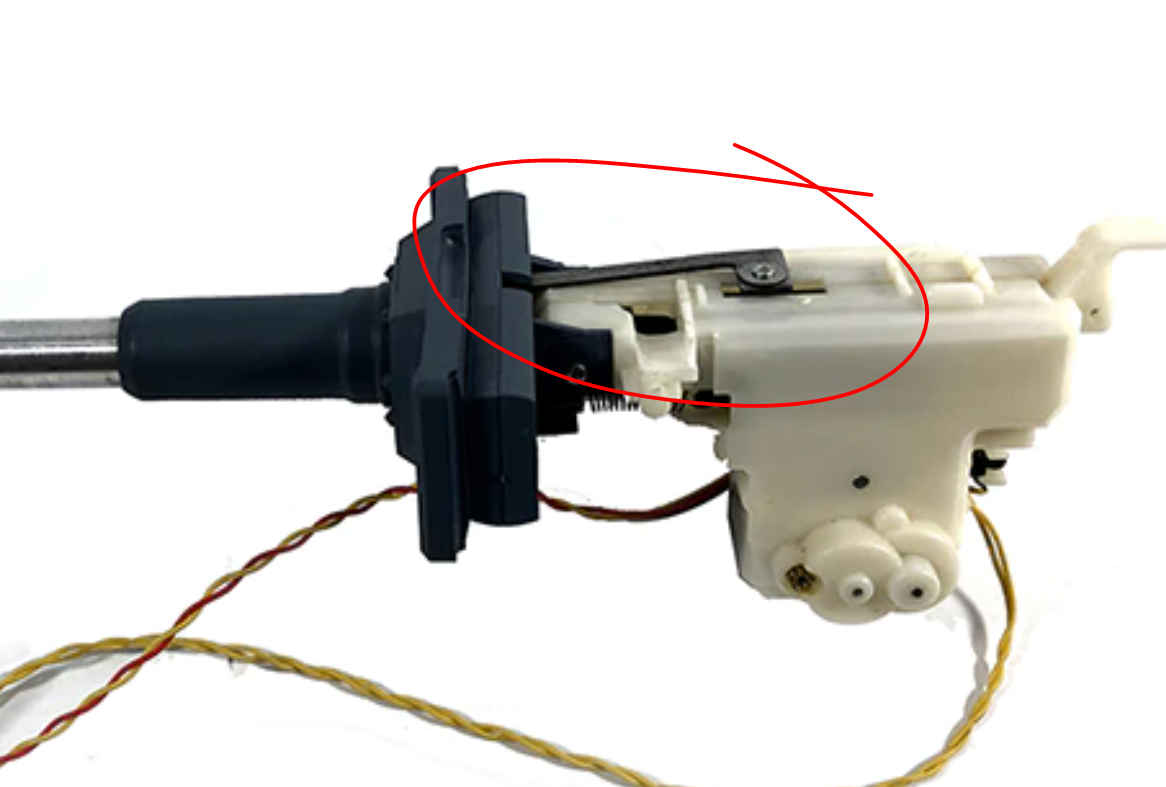

    Hmm, didn't think of that. An exterior arm that holds the barrel. Is there an gap between the base of the barrel and the hole of the airsoft unit to make the recoil possible? The fixed barrel on my Panzer III is just jammed in the hole of the unit, unable to move.
    Now that I look at some pictures of the KT barrel, and then the Leopard barrel+assembly I see there's a screw holding an arm on the underside of the barrel. Barely visible in this photo because of the dark color:
Name:	recoil leopard.PNG
    What I can't figure out is how the arm connects to the air piston. I see no place where it could connect. (I'm assuming all 6.0 airsoft units are the same):
Name:	connect where.PNG
    I did find this interesting picture, which doesn't seem official. The arm is on top of the unit. I think I could rig something like this for my Panzer III:
Name:	recoil barrel.PNG
    That said, with the timing between barrel movement and sound being off.... it might be a better idea to get a 6.1 MFU with a servo recoil unit.
    The last photo is correct that is how they work.
  • UltraVargen
    The barrel moves backwards slowly and loads the bb. The bb fires as the gun barrel returns forward. That is why the timing of the barrel and track recoil and different from the cannon firing.
    So the sequence is barrel moves backwards and loads a bb, then it returns forward rapidly and fires the bb, the tracks recoil the tank back as normal and the cannon sounds.
    The mechanism is a simple arm added to the airsoft piston that attaches to the “free floating” barrel. The arm is located on top of the airsoft gun.
    Sorry don’t have any photos but hope this helps out.
