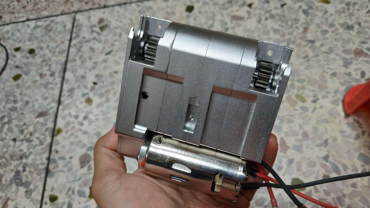

                                The base “plastic hull” Heng Long tanks are quite stout. They are built like a unibody where the upper and lower hulls work together to make a rather rigid body. In fact they are often more rigid then the thin aluminum hulls the expensive Tamiya kits use.
                                Depending on the tank many of the new 6.0 Heng Longs now come with adjustable idlers that are actually equal too or better then the ones Tamiya tanks uses in their kits.
                                Suspension wise the stock set up is also quite good and becomes even better if upgraded to the metal arms and road wheels. The suspensions are adjustable to match the weight of the tank to the performance desired, soft, medium, heavy and in between. That is not easily done with the Pro Plus or Tamiya kits.
                                Turret rotation can be made much faster and smoother with a low cost bearing turret ring and high speed turret rotation gear box. Both of which are direct fit upgrades.
                                Gearboxes? Well there are a number of aftermarket ones available including the ones used in the Pro Plus lower hulls that are outstanding in both durability and smooth performance. Personally I feel the ones used in the Pro Plus hulls (being 4:1) make the tanks too slow for the Abrams and T90/72. Though fine for the Tiger.
                                You could easily have a completely built up super tough tank ready to go for about the price of the Pro Plus hull alone. Because the Pro Plus is metal hulled does not mean it is necessarily a better starting point.
                                I have plenty of photos and videos of the stock hull Heng Long tanks get beat up and coming back for more on my Instagram @ fsttanks if you are interested.

                                  Where can we find the bearing turret ring and high speed gearbox upgrades?
                                  • Rubicon99
                                    • 3311
                                    #18
                                    Originally posted by Flanker271
                                    Thanks, I will take a look at your instagram pictures.
                                    Also did not know about the adjustable suspension based on tank weight, that's definitely a plus.
                                    There are a number of vendors for them. The easiest to start with are DKLMRC.com or on EBay Tucan Hobby. I am hoping 🤞🤞 MotionRC will be stocking them soon as well.
