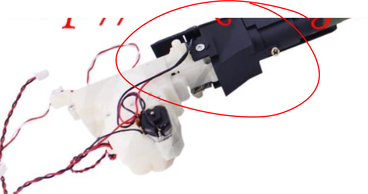

                          • #53
                            Is there a difference between the airsoft unit in 6.0 tanks that have barrel recoil and those that don't?
                            I watched a video on Youtube about this. And I opened up the airsoft unit in my Panzer III to see if it would be possible to make the barrel recoil. I found that this would probably be possible by simply widening the hole on the unit and then using a piece of brass tube to connect the barrel directly to the air outlet of the pump.
                            I would lose the airsoft function but I don't care.
                            But it does make me wonder how the barrel recoil works on tanks that have it standard, like my King Tiger. I assume there's a hole in the side of the barrel for feeding the BB balls. But I wonder how the rubber retaining ring that stops BB's from rolling out of the barrel is handled.

                              The barrel moves backwards slowly and loads the bb. The bb fires as the gun barrel returns forward. That is why the timing of the barrel and track recoil and different from the cannon firing.
                              So the sequence is barrel moves backwards and loads a bb, then it returns forward rapidly and fires the bb, the tracks recoil the tank back as normal and the cannon sounds.
                              The mechanism is a simple arm added to the airsoft piston that attaches to the “free floating” barrel. The arm is located on top of the airsoft gun.
                              Sorry don’t have any photos but hope this helps out.
                              • #55
                                Hmm, didn't think of that. An exterior arm that holds the barrel. Is there an gap between the base of the barrel and the hole of the airsoft unit to make the recoil possible? The fixed barrel on my Panzer III is just jammed in the hole of the unit, unable to move.
                                Now that I look at some pictures of the KT barrel, and then the Leopard barrel+assembly I see there's a screw holding an arm on the underside of the barrel. Barely visible in this photo because of the dark color:
Name:	recoil leopard.PNG
                                What I can't figure out is how the arm connects to the air piston. I see no place where it could connect. (I'm assuming all 6.0 airsoft units are the same):
Name:	connect where.PNG
                                I did find this interesting picture, which doesn't seem official. The arm is on top of the unit. I think I could rig something like this for my Panzer III:
Name:	recoil barrel.PNG
                                That said, with the timing between barrel movement and sound being off.... it might be a better idea to get a 6.1 MFU with a servo recoil unit.

                                  The last photo is correct that is how they work.
