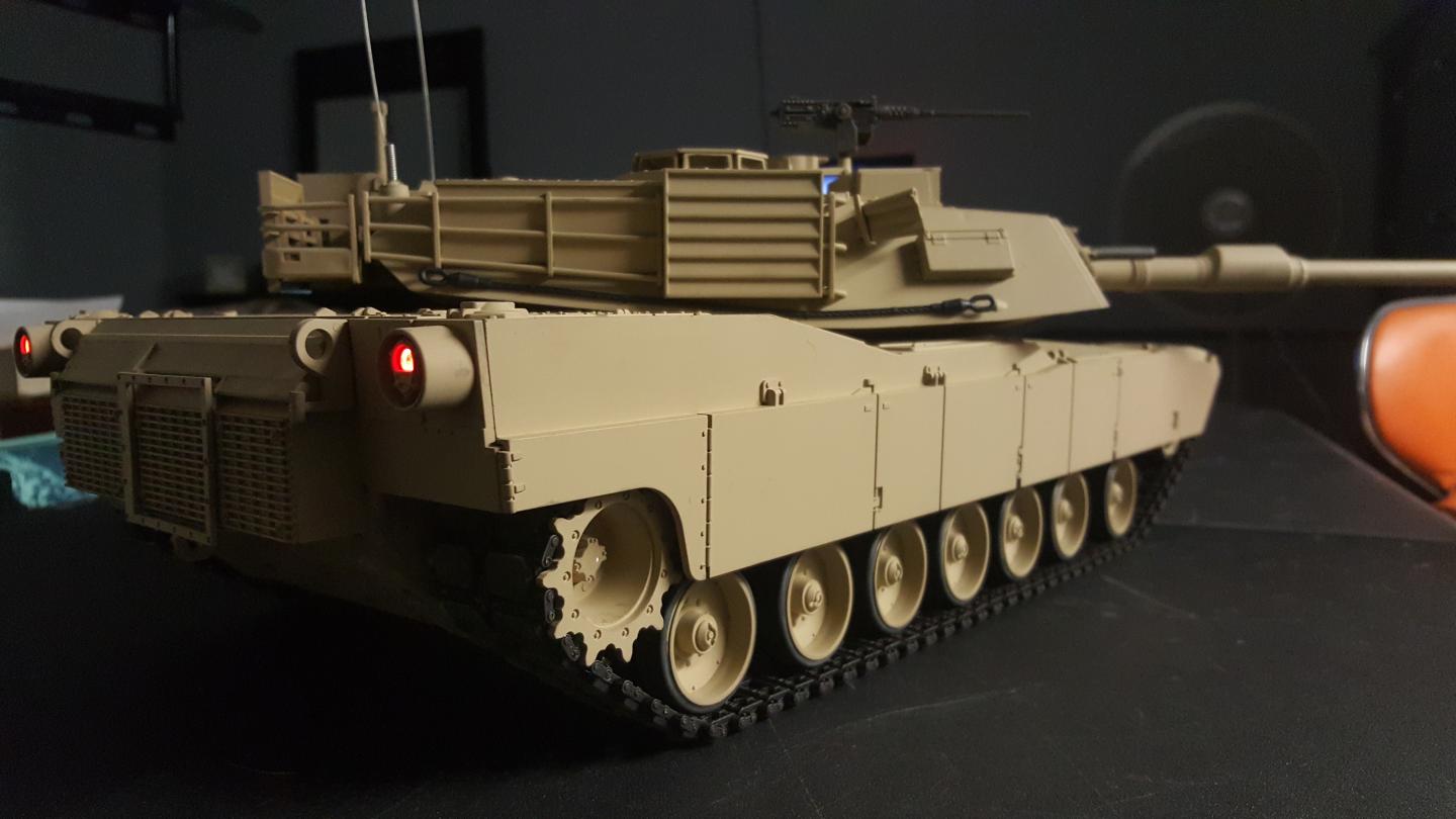

    Here is my Abrams without decals and weathering. Just bare paint. Not exactly accurate paint as the real life Abrams but $4 camo paint sand color and 30 minutes of work and it's better than the coffee brown color.
