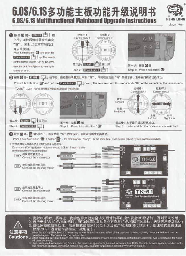

                                    New tankers be aware you CAN in fact change the control of the tank putting FWD/REV on the LEFT stick instead of the RIGHT. See the #2 step for how to do this. Keep in mind doing so in turn moves the cannon barrel raising/lowering to the RIGHT stick. You'll have to experiment and see which mode you like best. Additionally this sheet tells you how to turn the LED lights ON/OFF. Ignore the bottom #3 step for Dual-Current Driving System. Our model tanks are not setup for this.
