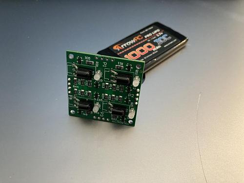

    Modular, readily available IR target that I cooked up. It is compatible across all board types, including but not limited to Tamiya, Taigen, IBU, OpenPanzer, and HengLong. Can be powered through any battery that is 3V - 5.5V.
    This allows a wide range of batteries to be used, including but not limited to: 1S (3.7V) LiPo, 1S 18650 Li-ion, CR2032/2016 coin cell, 3AA, 3NiMH.
    Depending on your application and size needed, you can choose the battery pack and capacity to fit.

    Shown here it is connected to a 3.7V 1000mah LiPo battery. The module itself measures only 1.5" x 1.5", or 40cm x 40cm.

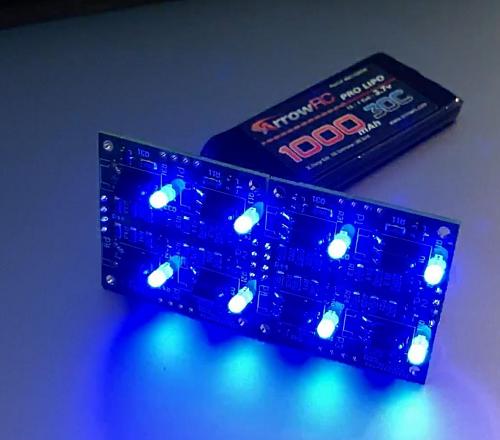

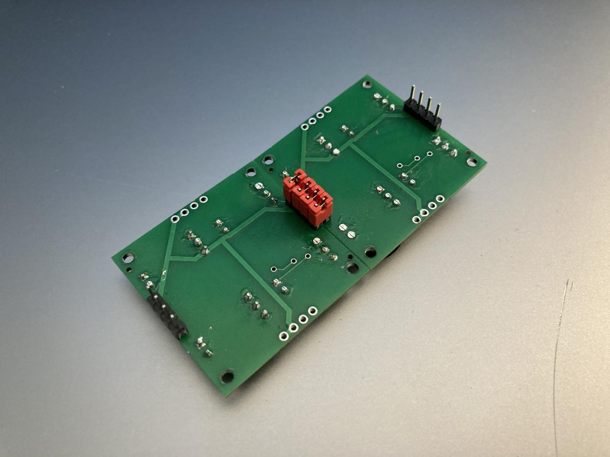

    Multiple units can be strung together, either next to each other or with long jumper wires, allowing a whole string of them to use one power source.
    Shown here we use short two pin header jumpers to create an array.

      Any of the four edges can be used, only 2 pins are needed to power (See attached). All 4 pins need to be used if powering more than 10 boards. Each board has 4 independent receiver / led circuits for redundancy. Lights flash for duration of the signal. If you buy a small lipo pack, the standard jst connector plugs in perfectly, otherwise you can make your own using a 2 pin dupont connector.

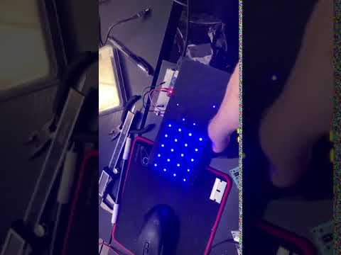

            Hi Lego, could you post a video of this thing in action? I think it would explain it better.

              So there's 4 receivers, if any one is hit, all four or more) lights flash?
              • LegoDEI
                • Mar 2020
                • 100
                Each receiver / indicator is it's own circuit. They're capable of lighting up independently of each other; allowing for some cool visual measurements to be taken regarding beam size and spread. The end effect with a single unit doesn't look any different than you're used to, but when an array of units are put together, then you can tell it is providing feedback about the IR beam that is being emitted in real time; i.e. this has no delay compared to receivers on your tank, and provides positional information about how well your cannon is aimed with minimal delay.

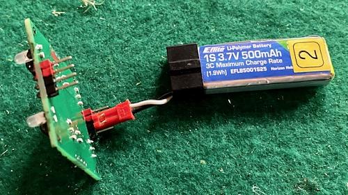

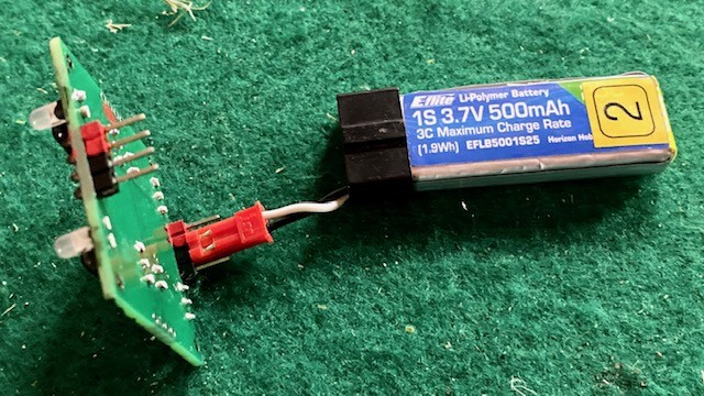

                              Hi Lego DEI, would you please post a picture of an actual electrical connection to the IR board from a battery pack or battery holder. Either with a connector plug or just wires.
                              Thanks

                                Simple connection. I used legoDEI's photo to ascertain positive and negative & painted the red connections for reference. The pins are routed in such a way to allow multiple boards to be connected side by side, as it were.
                                Click image for larger version  Name:	ir battery.jpg Views:	0 Size:	102.3 KB ID:	282102
                                LegoDEI, it'd be cool if you were to include those jumpers you showed, when folks bought more than one. oh, I agree with your not adding shades. It'll be simple to just put the board into a box if desired.
