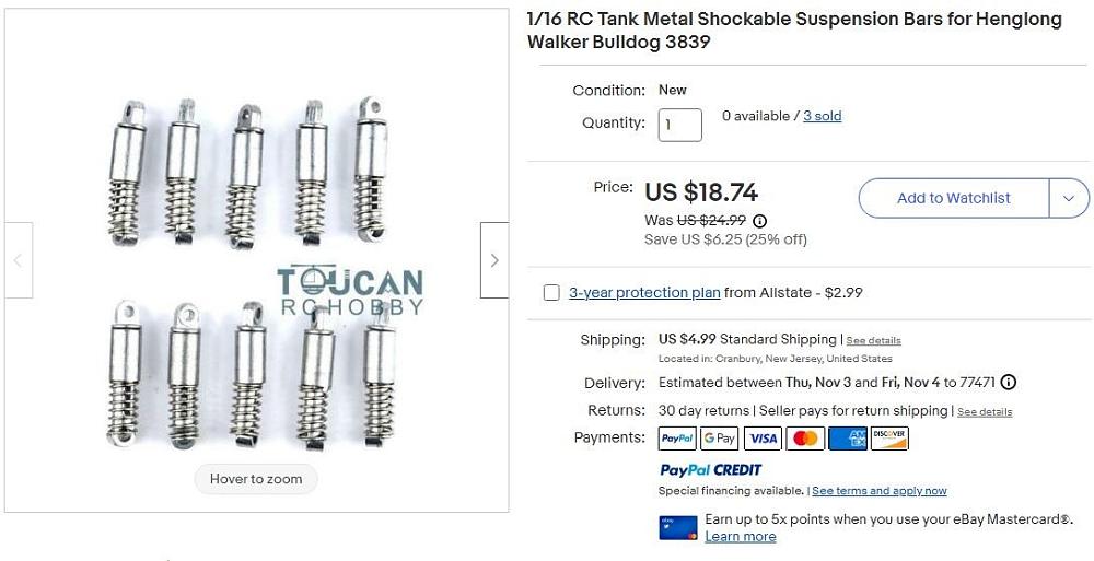

            Recently purchased the "metal" version of this Pershing. Last night while putting the road wheels on after painting the Tank, I set the Tank on my workbench and broke a shock in half. Tank has never even been ran yet. I was about to cry when I realized this Tank uses the same exact shocks as the Walker Bulldog. On my bulldog, I swapped all the plastic shocks fpr metal ones so I still had all the old palstic shocks in a spare parts box. The swap was relatively painless. I then quickly ordered more metal shocks. The moral of this story is: Anyone who has this tank, and is planning on running it hard or going into battle with it, I strongly reccommend metal shocks.

                I had the same problem with my plastic suspension bars in my M41. They broke easily. I will order the metal shocks and take those plastic out.

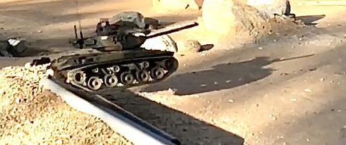

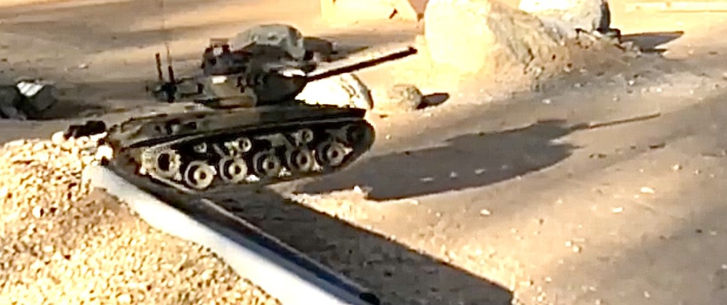

                    Metal arms and road wheels are a huge plus for durability especially when you start to abuse your M41.
                    Screen shot from my Instagram of just one of the “airborne” slow motion videos of my M41 being miss used. LOL

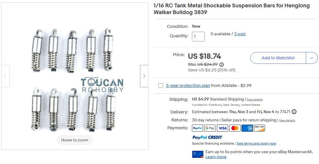

                      https://www.ebay.com/itm/28454868799...Bk9SR8q7-biFYQ
                      Be sure to get them for the Pershing & not the Bulldog....you need 12, not 10
