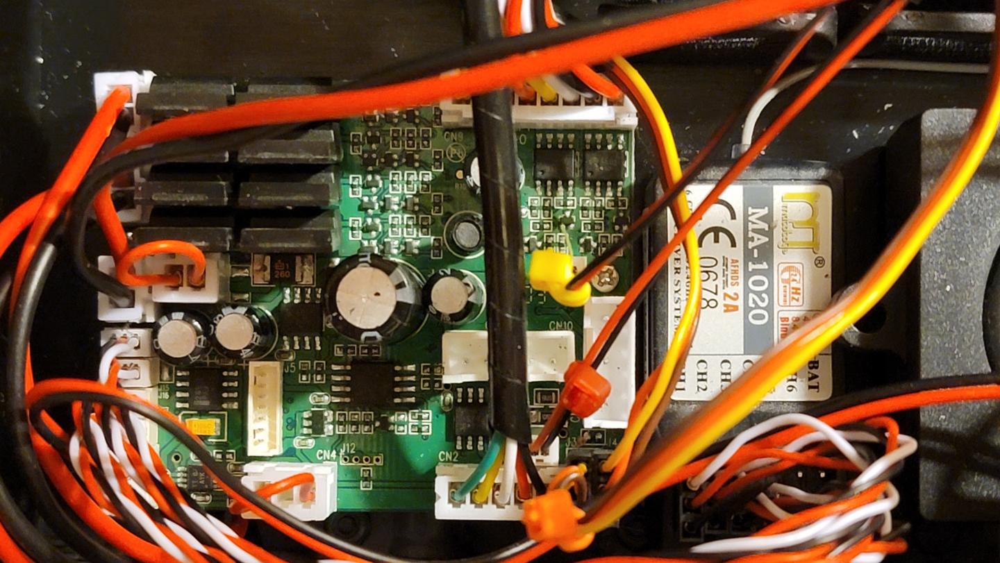

My 1st MATO tank. While I was delighted that it came with a decent electronics package, I was quickly dissapointed on the set up. Its a 4 channel radio configured for Tamiya. Which for me, sux. Its like my whole muscle memory has been reversed....and it seems anyway, there is no way to reprogram the Transmitter...although I could be wrong due to inexperience.
Another dissapointing aspect, although its 100% all metal, the metal must be aluminum, or some other non-ferrous metal-I was hoping for real steel. I ordered another Flysky 10 channel setup and a Sony remote to program the Clark TK22 receiver to get the control I'm accustomed to. The STUG III does not have a smoker, nor an easy way to plumb in some tubing...so I got to figure that out. The plus side is, its servo controlled elevation & recoil. Before even running, I gutted out all the elctronics....I also scored a Henglong 7.1 MFU, and may drop that in-who knows. The 7.1 has a vast array of servo ports and other added goodies...its pretty awesome on what it will do.....A MAJOR improvement over previous generations,although the sound package is limited.

Are you planning to take out the Clark board and replace it with the HL 7.1? I checked my Mato KT and it also had the Clark board. Now that I know about the Clark board inside, I would like to switch the receiver, bind it to my Spektrum transmitter and hopefully install the DAKRC IR battle unit. Do you think it is possible?Originally posted by Zippersnapper View PostThanx as always Rich....As you know, my learning curve is rather expensive...SoCal RC Tank Club Facebook Group

I'm thinking you should have no problem doing the swap. Im going the route of another IBU2 Ultimate in this tank as I want barrel & engine smoke & other functions but will use the Clark along with a Flysky Radio in another project. I did however purchase the "sony" remote to program the TK22...you may need to do the same. The TK22 does not have the ability to play with sounds, so that sux. The HG 7.1 is pretty awesome actually....the servo recoil works well along with servo elevation AS LONG AS YOU PUT A JUMPER in port CN6. This trick it seems is not advertised, or I simply cant find it in the HG instructions........Im the last person to ask about IR Battle......I dont do it, and gut all IR stuff out of my tanks.Originally posted by DavidN View Post

Oh my goodness. I plugged the IR bulb into slot J1, the IR receiver into slot CN2. I turned my Mato King Tiger on. I fired; it scored a hit. I got another tank to fire at it, and it flashed. I fired 9 shots at it.After it received shot #9, it flashed multiple times and shut down. Wow, I have myself a Tamiya battle protocol tank all this time (1 year) and I did not even know about it. Everything else is functioning accordingly. The only thing I think I need help in adjusting is the time interval between shot fired. This board took 13 seconds to reload before I could fire the next shot.
I also have changed my mind about the transmitter. I will keep the Mato's receiver and transmitter in this tank for my daughter to play. I already have about 30 tanks stored in my Spektrum DX9.
Many thanks Mr. Zippersnapper

So is it correct to say that all Mato tanks come with this Clarb board TK22 inside?SoCal RC Tank Club Facebook Group
