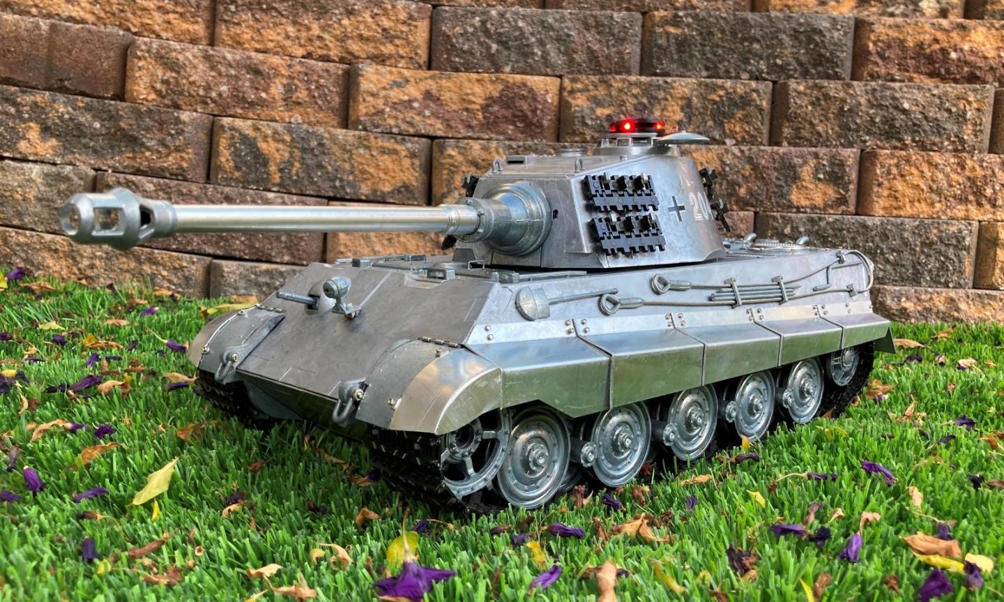

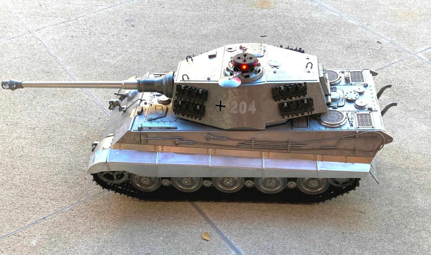

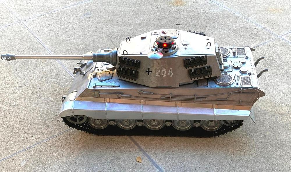

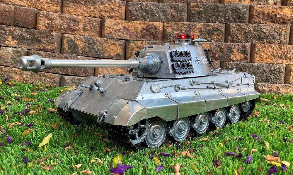

            I got home from work and jumped right into finishing my KT. I got the IR bulb inside the barrel. The IR receiver was slid up to the commander hatch. Re-tested it again and it is all ready to battle. It is supper heavy :-)

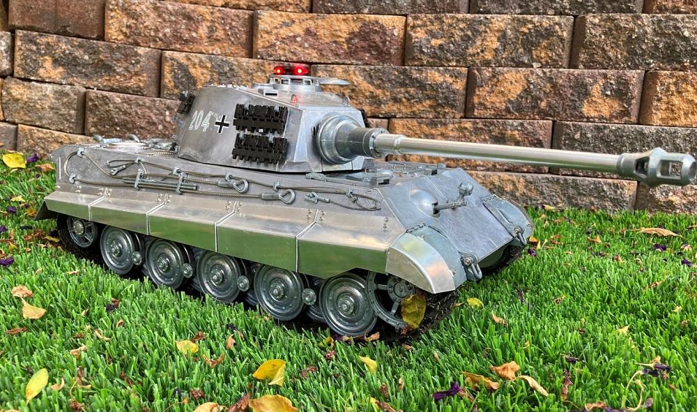

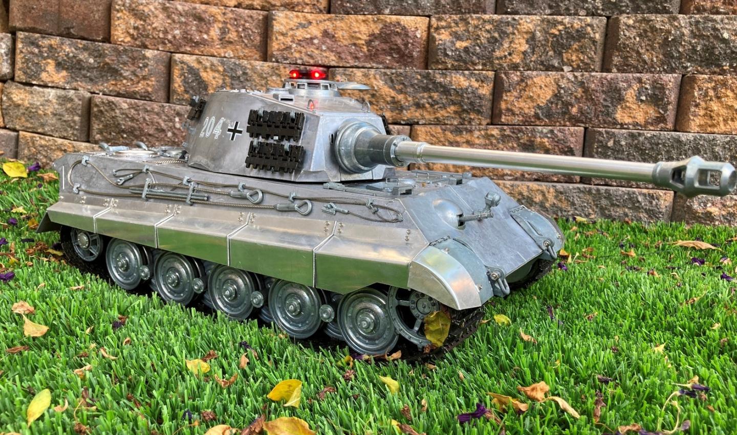

            • #26
              Looks like a beast!!
              • #27
                18 pounds without the battery .
                • #28
                  Thats pretty Bad Ass. !
                  • #29
                    David, looks good. Do the turret and barrel bounce like the Torro? Got to fix that on mine.
                    • #30
