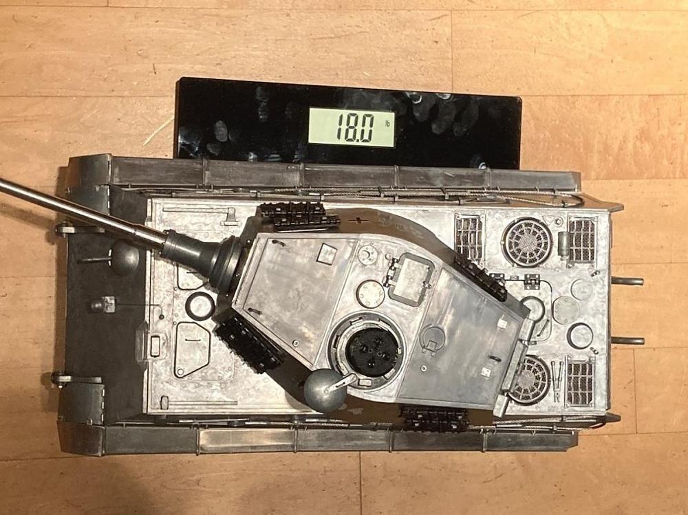

    David, Im assuming your KT is a MATO? If so, will he metal hold a magnet? Or is it non ferrous like mine? 18lbs without a Batt has me curious.

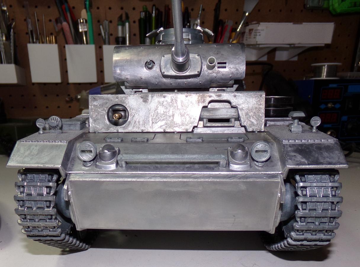

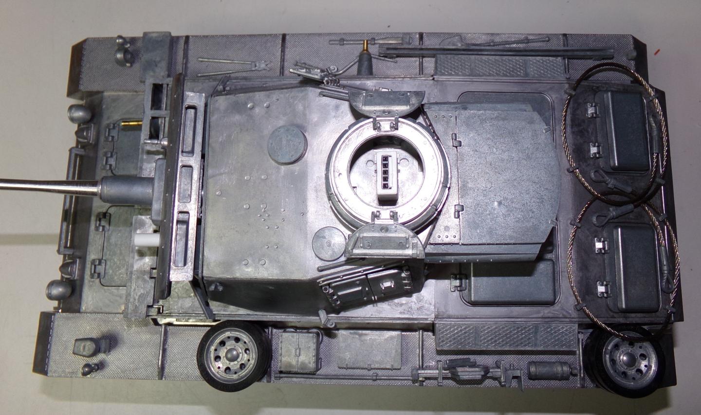

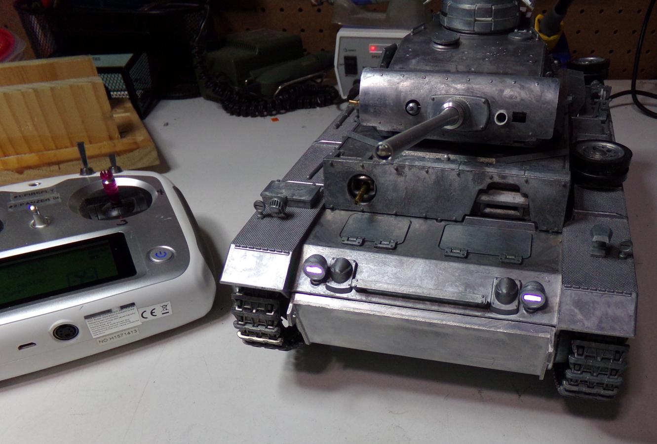

    My KT Mato was the BB version. And since you began this thread informing us that Mato's MFU was the Clark's board, I know it would be compatible with the DAK IR battle unit. I was excited. My tank was just seating there for over a year. A few other members were saying that Mato has numerous issues that I was quite afraid to run it often. I did not realize about the board inside. After getting the good news from you, I converted it to the Tamiya battle protocol setting with the LegoDEI IR receiver and install the IR bulb into the barrel.
    And you are also correct that the metal on this tank is not steel metal. It does not magnetized. I ran my magnet rod all over the turret and it did not stick anywhere. Maybe bc mine is the BB version.

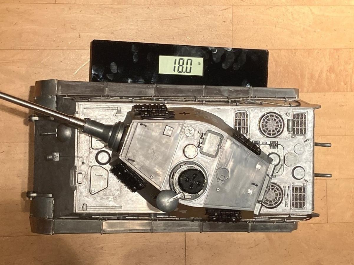

      And yes it is a 18 pound monster.

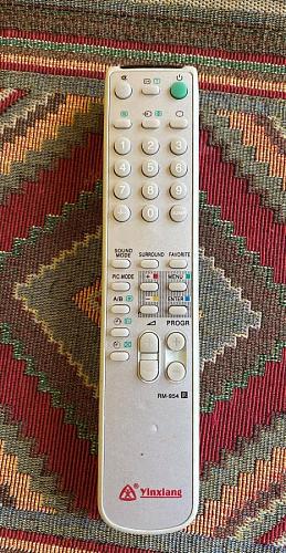

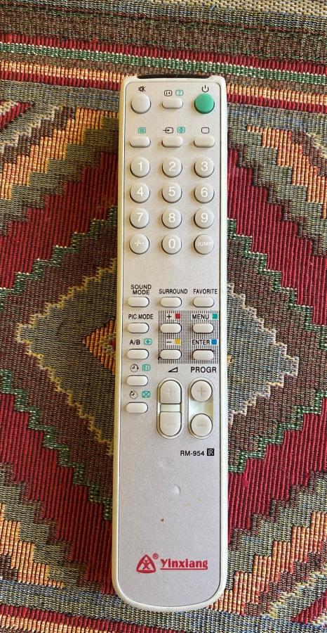

        David, Correct me but, the tank has to have IR to use the remote? Also, is this a standard Sony remote? In other words is the same model remote compatible? Thanks.
        Yes, for my understanding, it programs thru the IR set up tank.
        I am not sure on the remote. You can try. DAKRC.com is the main source for the Clark's boards. They sell the that specific SONY remote for programing their boards. I bought it from them. I am also lucky to live near a LA RC tank club member who is quite an expert in Clark's board. He uses a different remote and it works too.

          Mato tanks are Zamac, similar to older “pot metal” but a better amalgamation. But they are brittle, if you drop it it will crack or shatter.

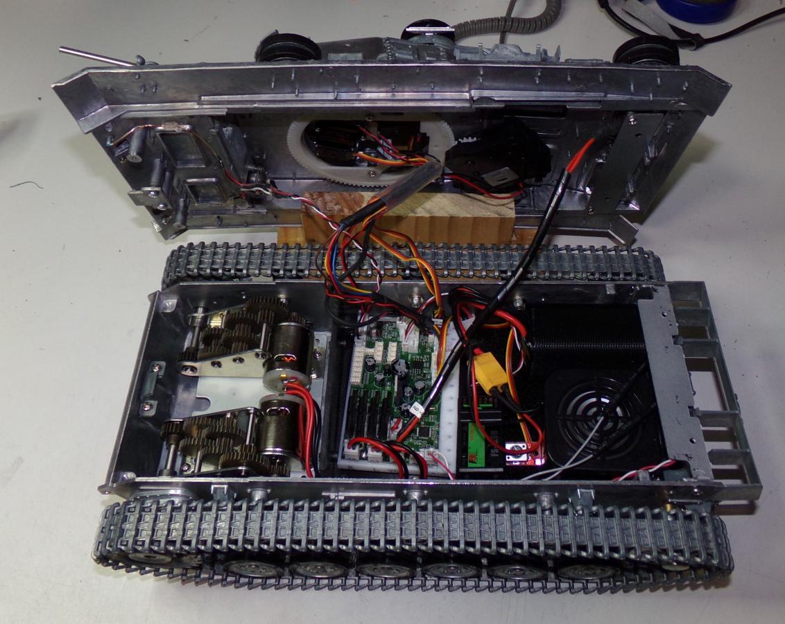

            I got a good deal on an all metal Mato PZ3 and new PZ3 Clark TK-80 ($175 off Ebay). The PZ3 was $350 shipped and it was all in pieces (as in never assembled). I was able to get it assembled and tested all in one weekend. It's actually been a really good runner so far, but I haven't painted/detailed it yet as I wanted to make sure it all worked well before doing that. Had to drill some holes where there were none and do some voodoo screw work, but it works nice so far.

              Mine is the IR version, so the Zamac as Rich pointed out, must be be used on all MATO metal tanks regardless of IR or BB versions. Thanx for clarifying that.

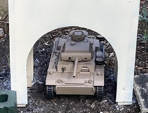

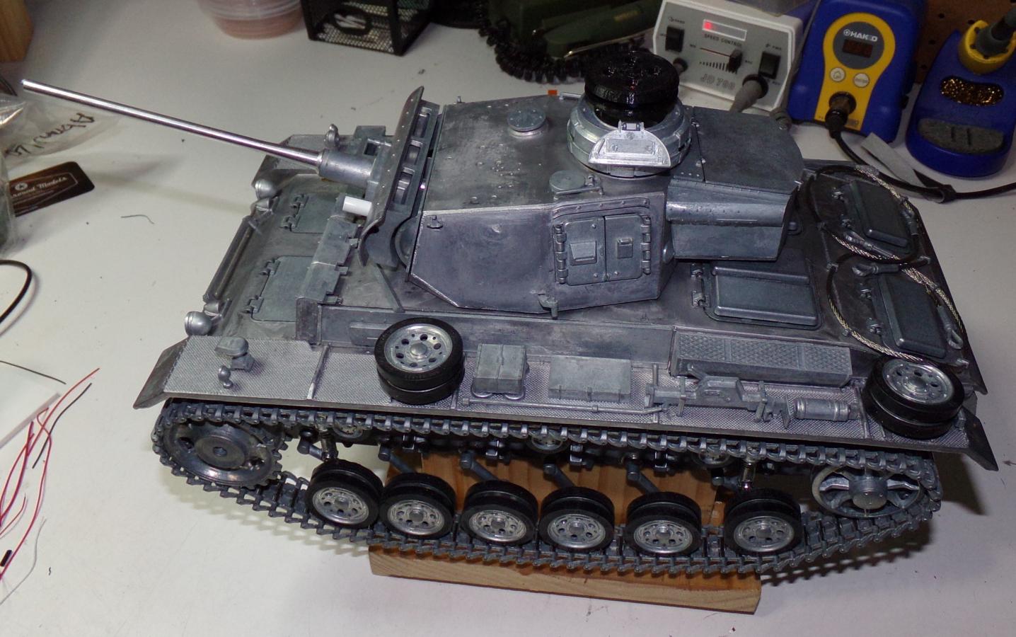

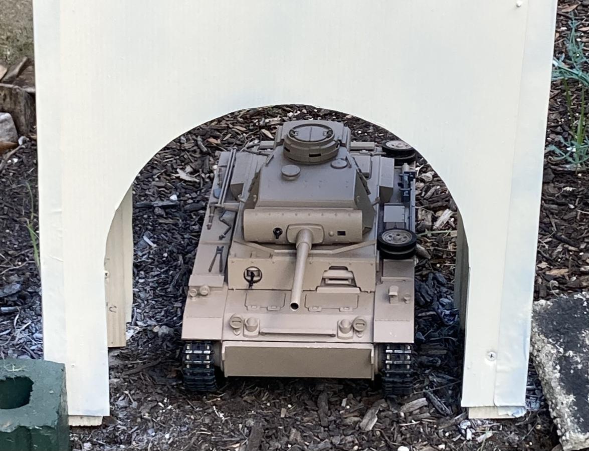

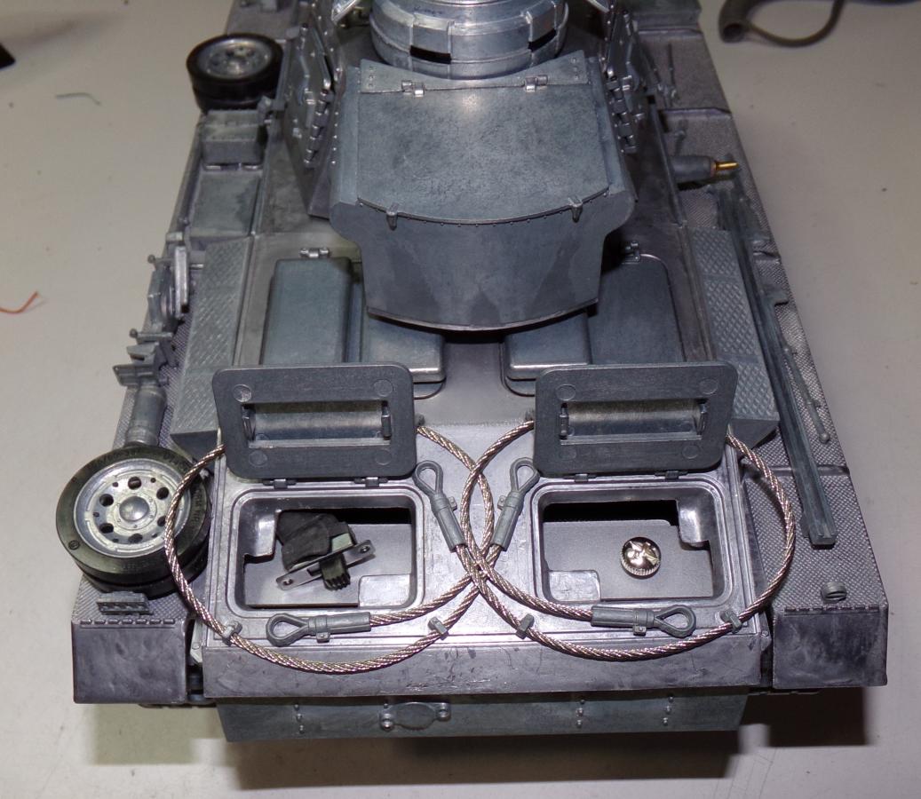

                Looks good. My Pz III is work in progress and a learning curve. And it's going to be a nice project.

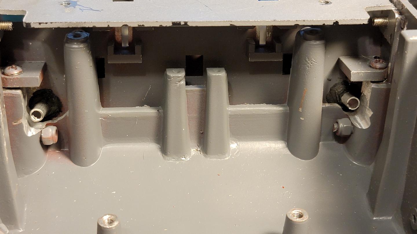

                              I have read where gear box covers aren't necessarily needed. I have been doing some trouble shooting on the Mato Tiger 1. TC left gear box does not engage immediately and when it does the rpm is much slower. While trying to figure it out, I removed the gear box covers for better diagnoses. Well, you can't leave them off. On the next test run the gear shafts starting working themselves loose. Apparently the cover is designed as a retainer for the gear shafts.

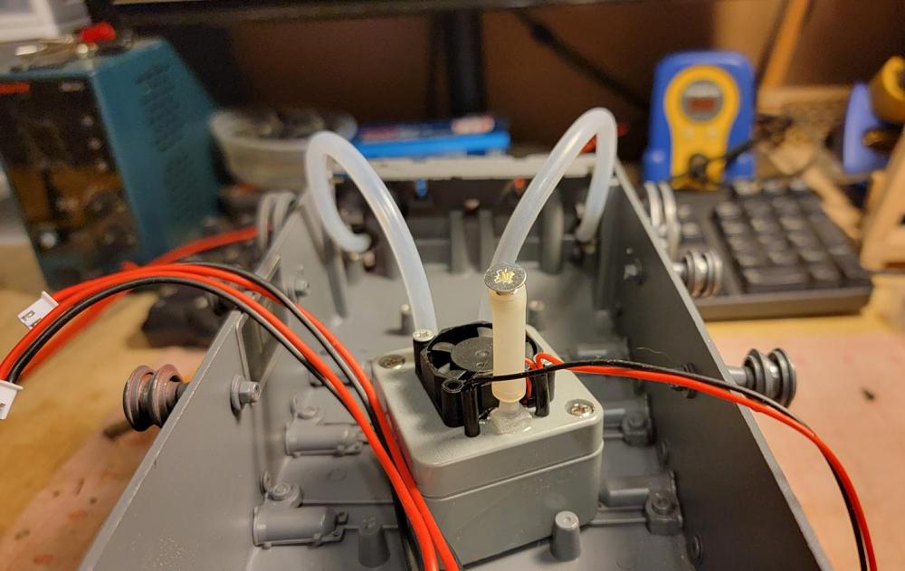

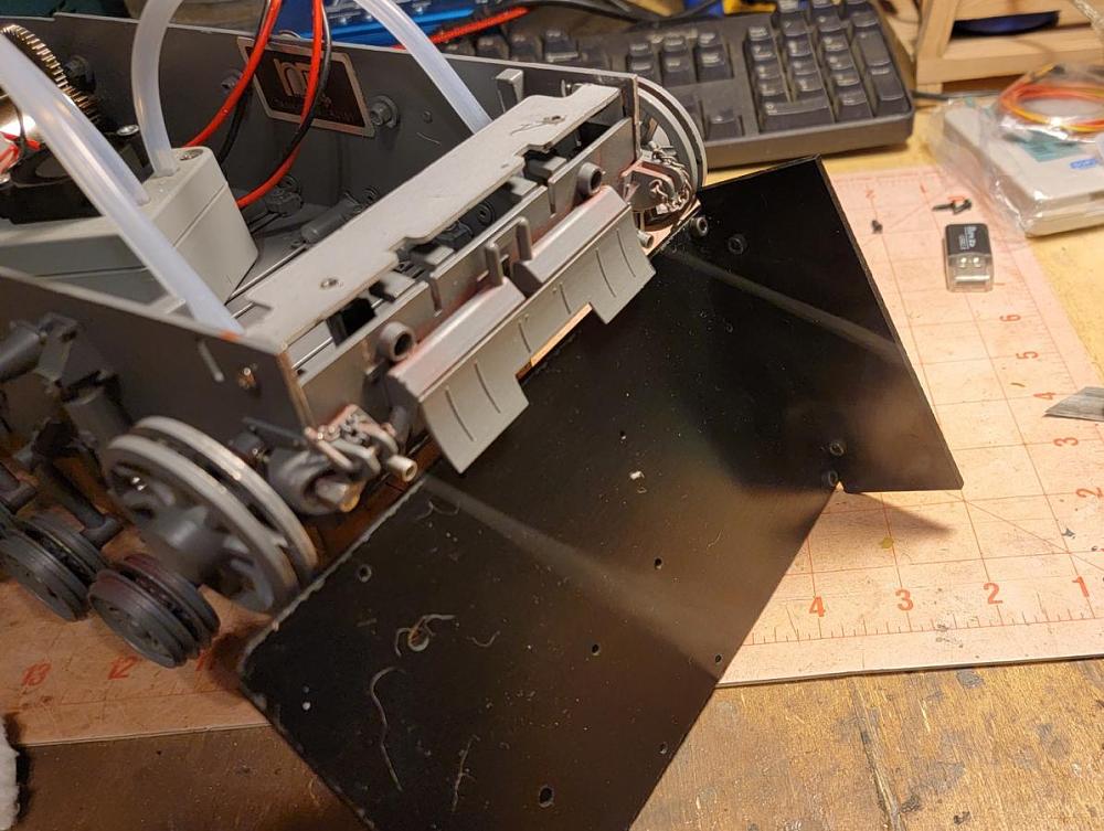

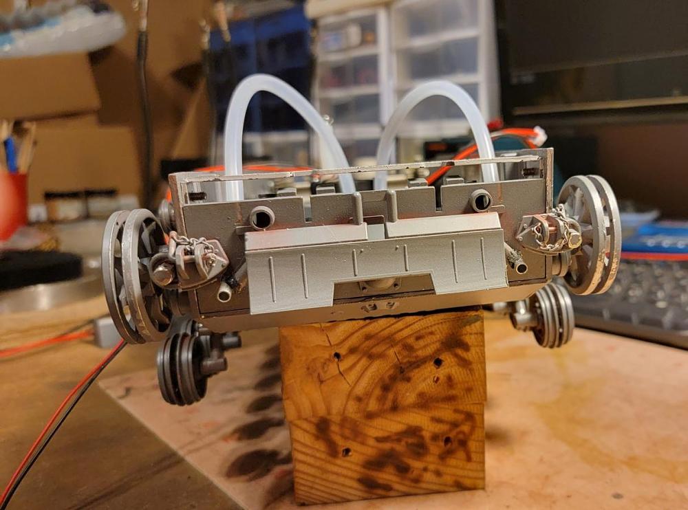

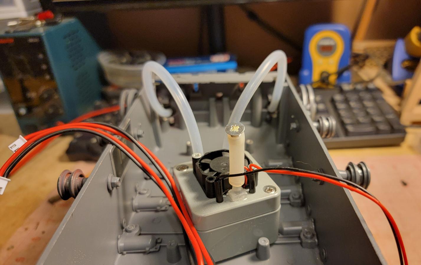

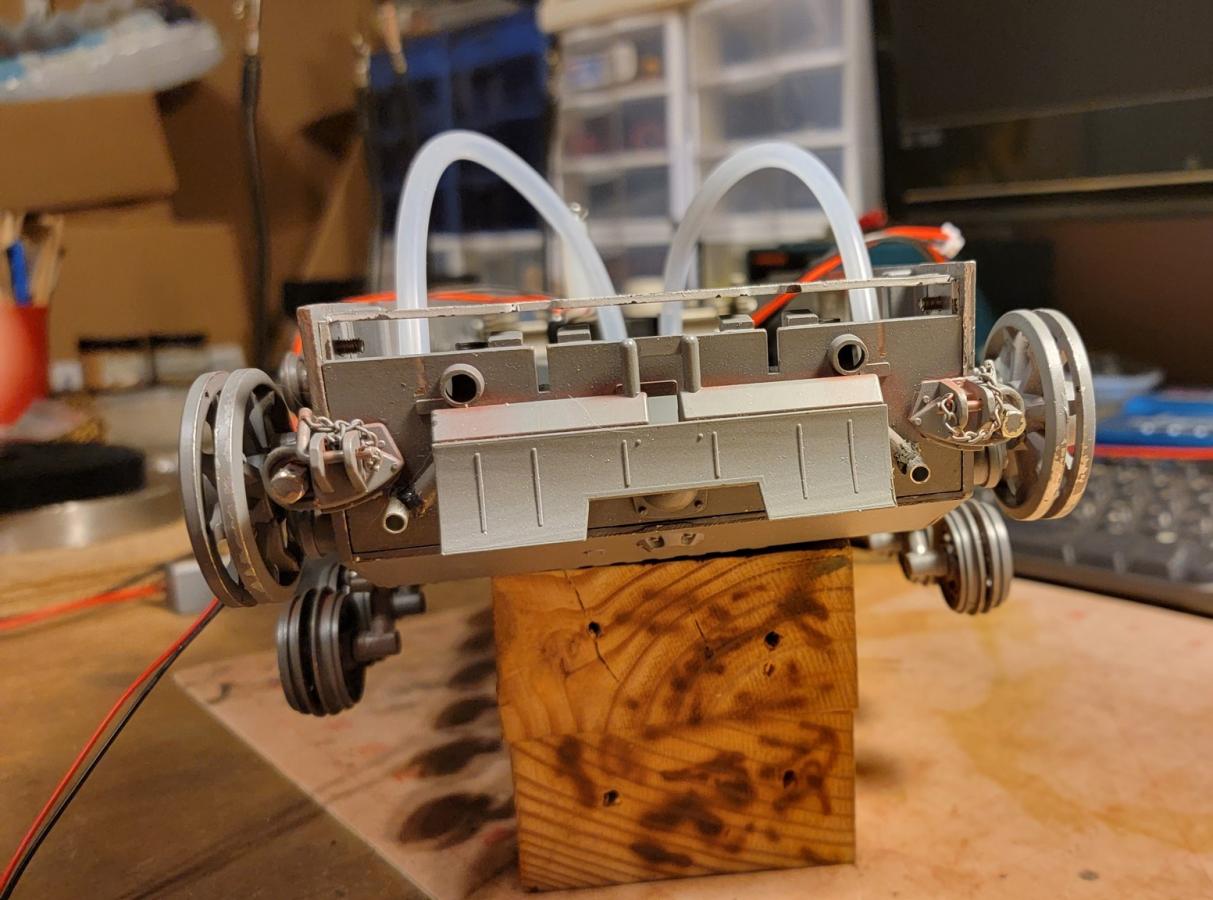

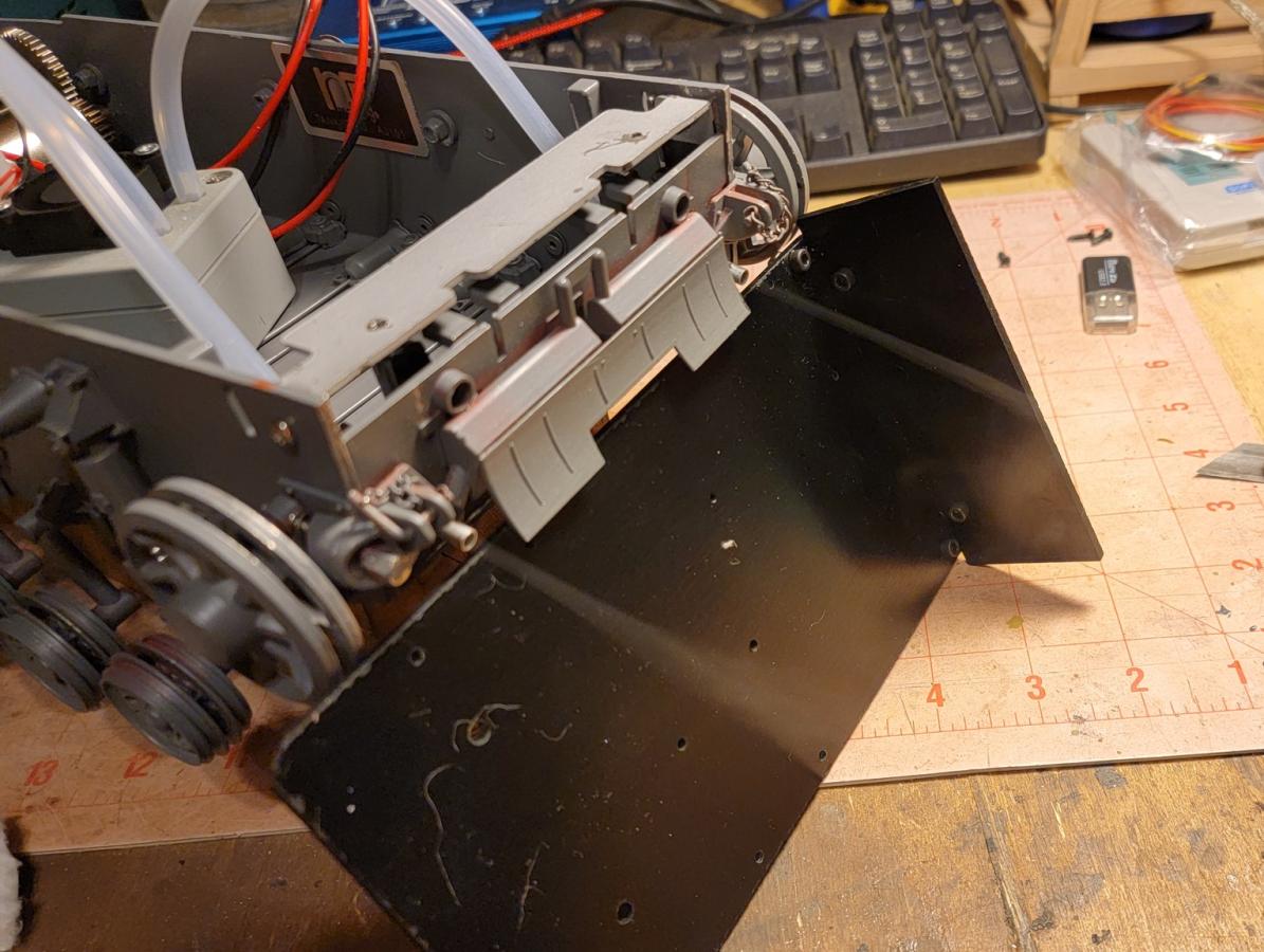

                                Anyone with a Stug III, much less a all metal MATO Stug III will know what a PITA it is to add a smoking exhaust...where there is a will, there is a way.
