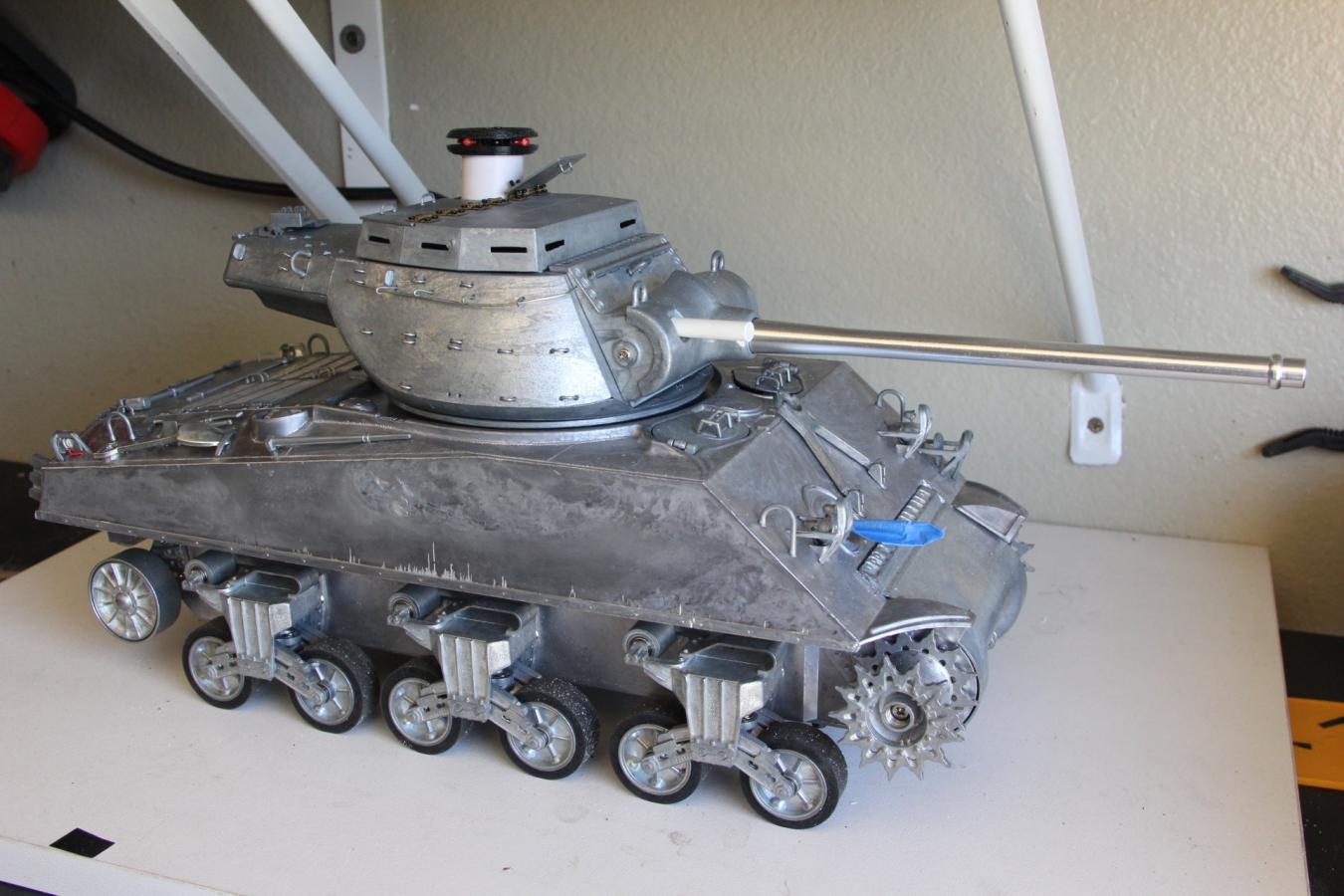

                                      #38
                                      Well, I replaced the Mato IR set with the LegoDEI set. I left the Mato flash LED inside the barrel and installed the IR bulb at the right side. I will probably paint it after the LA tank battle event.

                                        #39
                                        I just tested the power of the Mato IR Emitter. Not surprisingly, it's much weaker than our aftermarket bulbs. In a shady evening, it only worked at about 30 feet, whereas the tank with the "good" bulb was at the expected range. It worked reliably at where it tested, at 100 feet. To make the tank competitive the bulb has to be replaced, either in the barrel or as you did alongside it.
                                        We think the manufacturers skimped on the bulbs and receivers, but maybe they optimized them for indoor use. Once I fired the good bulbs in my workshop, and it registered hits at over a 60 degree spread just by reflecting off nearby surfaces!
                                        • Rubicon99
                                          • 3316
                                          #40
                                          Looking good. But I would caution about using such an exposed long styrene plastic tube for the IR bulb “barrel” The IR energy tends to “bleed” through the white plastic and hit tanks next to it even when the tube is painted. Make sure you prime the tube with a few extra coats of black primer prior to your primary paint coat color being applied to minimize IR “bleeding” occurring.
                                          For IR tubes it is best to use a metal tubing of some sort. This eliminates the “bleeding” effect completely.
