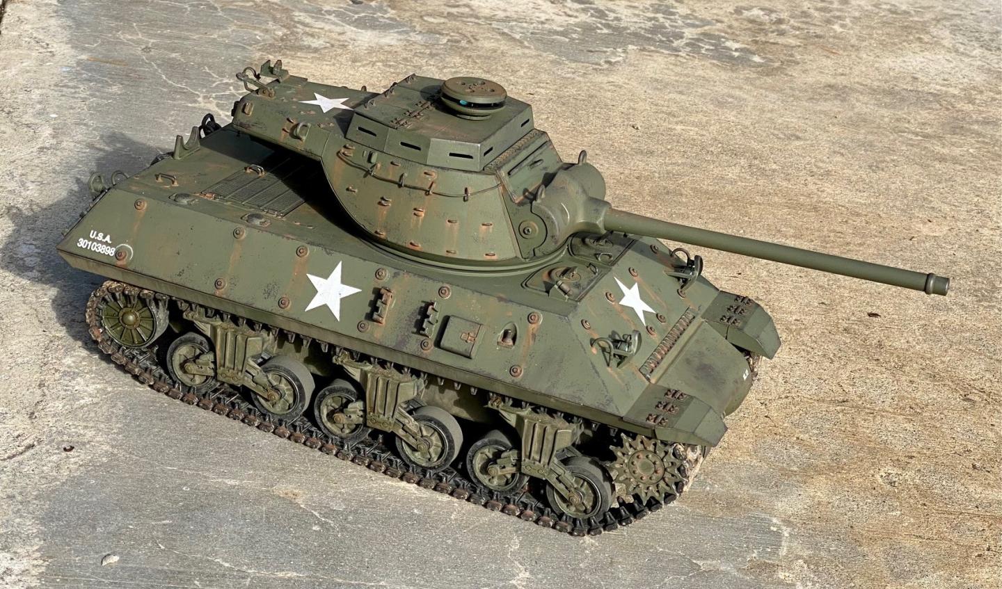

                    On its way...more rust, some dust and external stores are next. The canopy acts as the mount for the IR receiver.
                    Some observations to share. Space is very limited inside. A full length battery sits too high up forward for the top hull to fit. There is a brace it interferes with. I may be able to cut away enough brace to allow the battery to fit. Regarding the track; the teeth are farther apart side to side than the width of the road wheels. The double pin links are flexible side to side. These two things can combine to jam the track in the sprocket. I'm working on fine-tuning the alignment.
