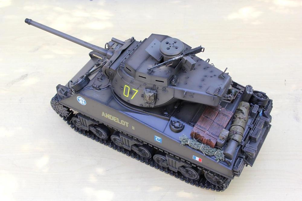

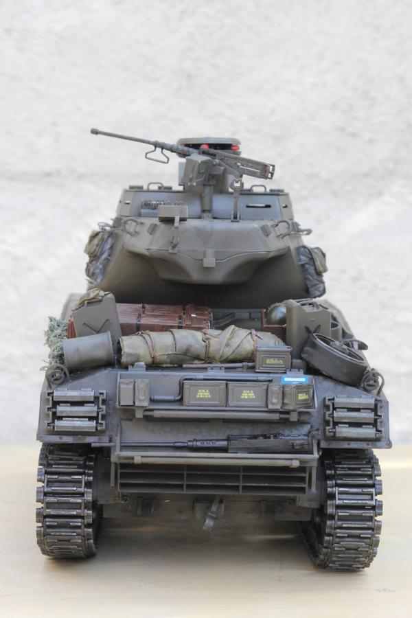

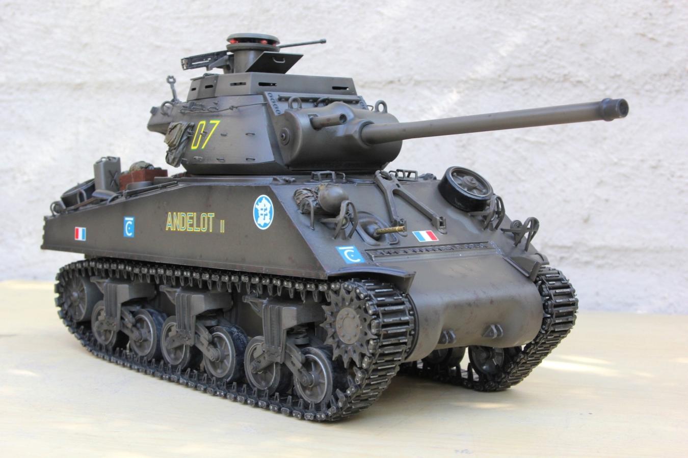

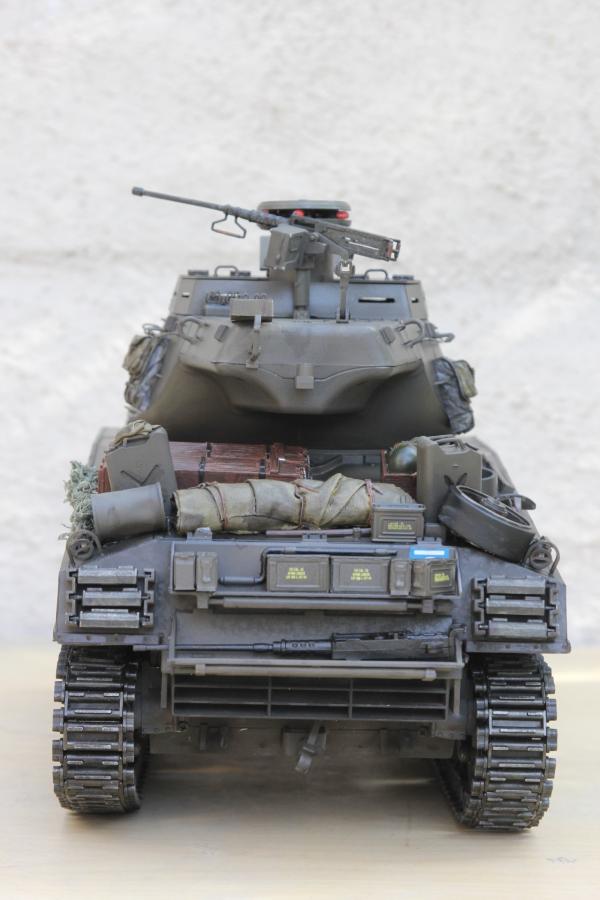

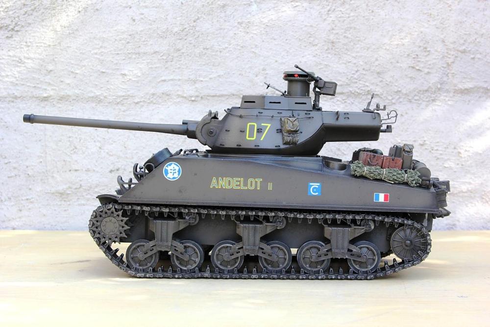

            Mine is done. It's French :-)

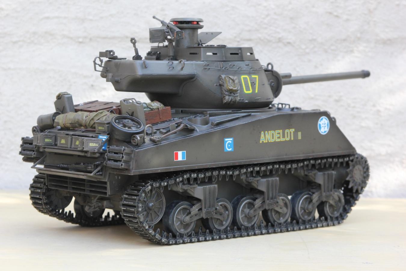

              #46

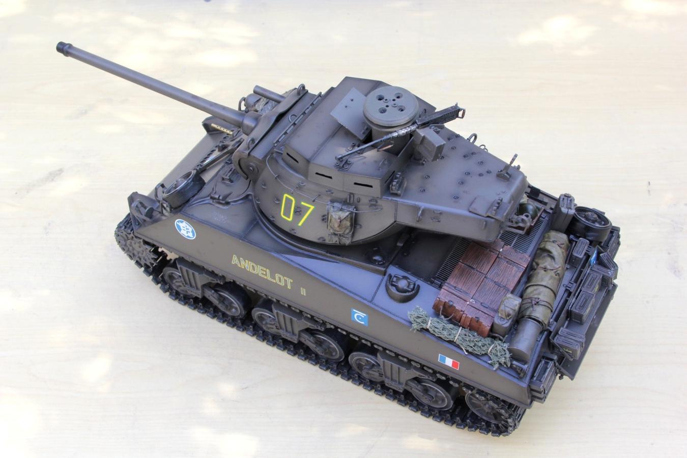

                #47

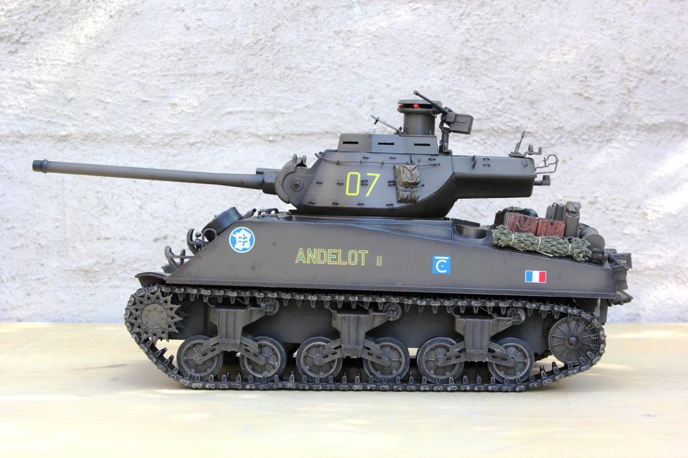

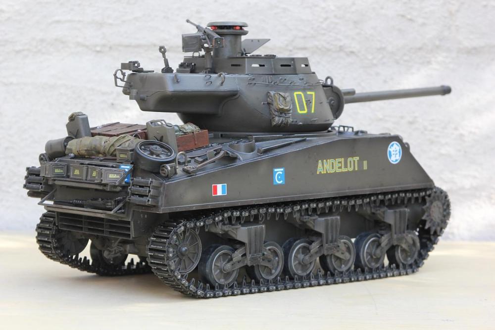

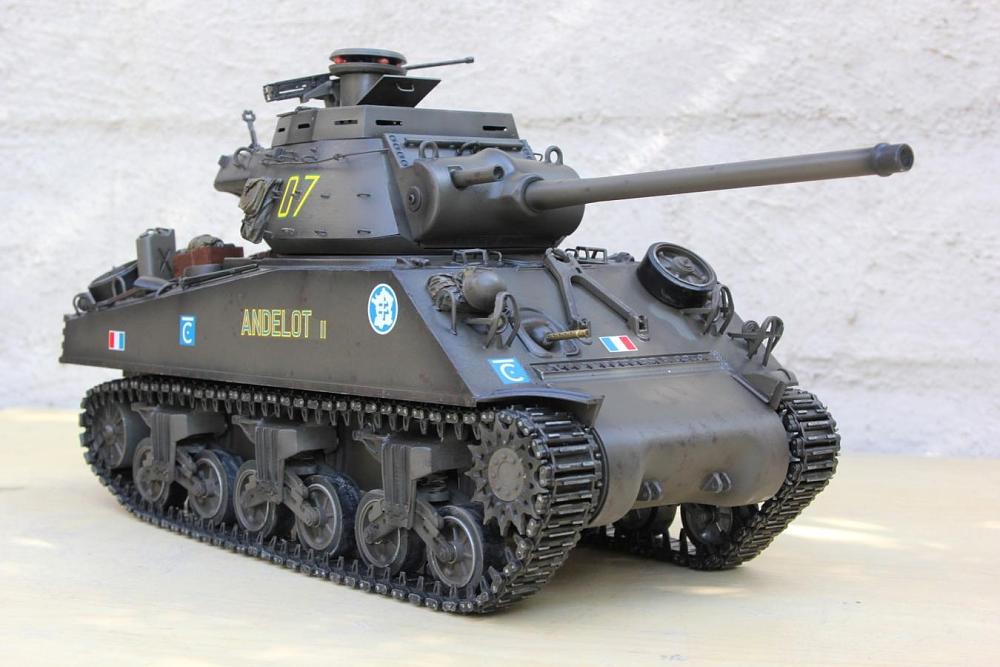

                  Very nice. How did you manage painting the wheels and not the tires?
                  • DavidN
                    • May 2021
                    • 3189
                    • Los Angeles, CA
                    #49
                    Sorry for the late response. I have just gotten home from work. I used Tamiya acrylic paint for the tank. Then I took the Q-tips, dipped them in lacquer thinner and rubbed the paint off. With one finger from 1 hand, I rotated the wheel while the other hand pressed and twisted the Q-tip onto rubber tires. The paint came off quite easily.

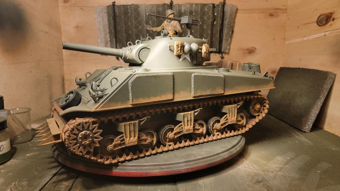

                              Thats excatly how I did mine. Couldnt figure out how to remove the wheels/bogie's to save my life. Henglong really threw a curve ball on this one.

                                Them Shermans are a pain! I actually had to drill a tiny hole in each (plastic) plug, insert a tiny screw and pull them out to get to the bogie screws. This leaves that hole. If you're doing a fine scale tank, you could putty the holes, but I've left the small holes in case I gotta get in there again!

                                  The henglong wheels unscrew from the back side on the plastic version. I don’t know on the metal bogies. Popping the plug out of the center of the bogie exposes the screw so don’t glue those in and you can gently pry them out with a tiny flat screwdriver.
                                  but this is why I prefer taigen Sherman’s over henglong. Better build and serviceability.
