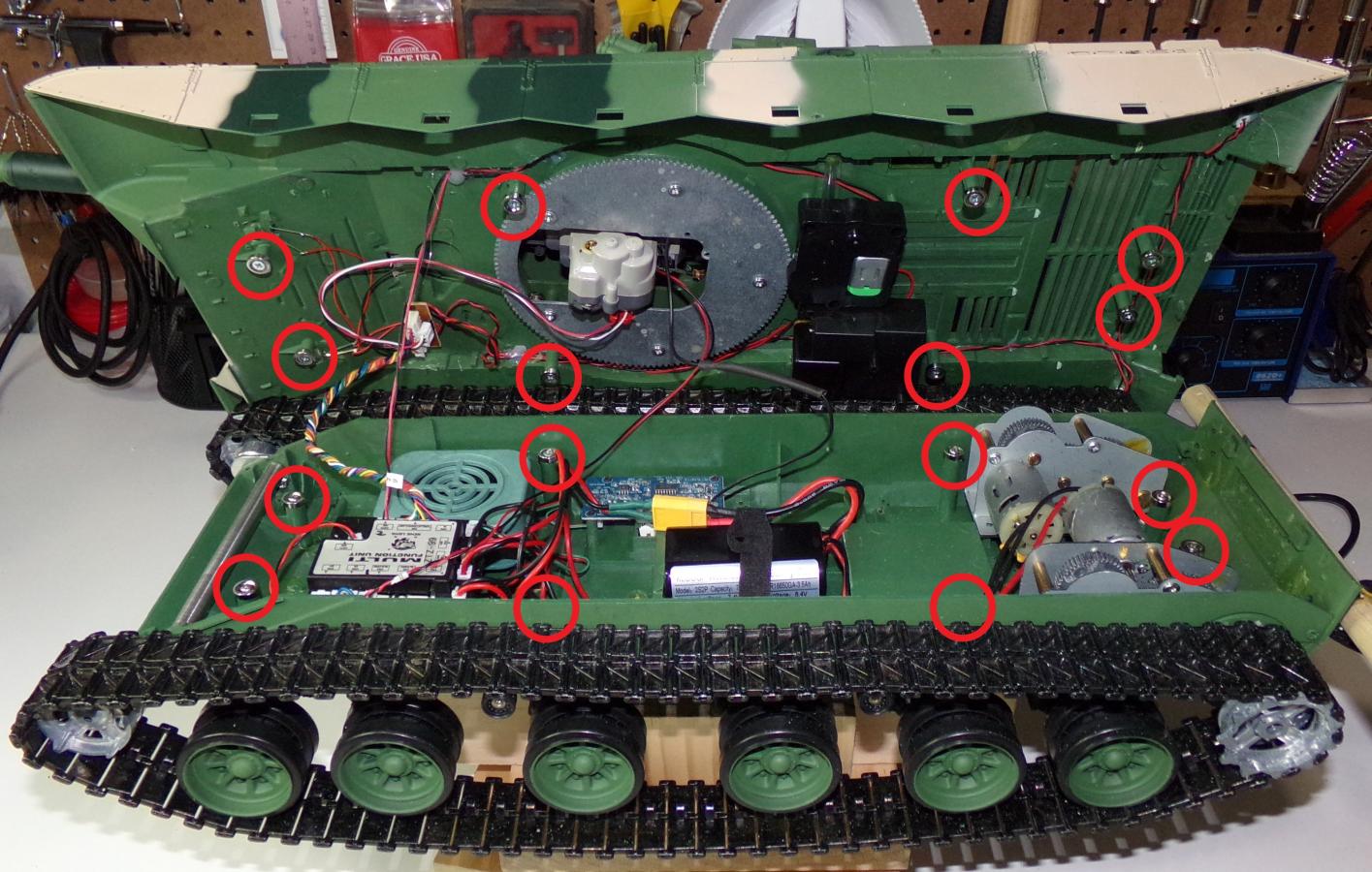

    My first magnetization project for the HL tank is a complete failure. I picked the Pershing as my first experiment because it had 7 attachment points. I choose the rear center and 2 middle forward for initial installation. Mechanically, it worked perfectly. The tank closed tight with perfect alignment. When I turned it on, I first noticed the engine sound to be strange. It fired up (RC link) ok. Then, the head light started flashing. When I ran the tank, it moved slowly and the turns were intermittent. Something is NOT right. And I have a suspect.
    Click image for larger version  Name:	magnet1.jpg Views:	0 Size:	233.4 KB ID:	363585
    The right magnet is very close to the speaker. Both magnets are too close to the 6.0S MFU.
    I removed both of these magnets (upper and lower), but left the rear center one in place. I close the tank and it runs normally. I am greatly relieved. No permanent magnetization of the MFU!
    Some of you may remember that this 2005 HL Pershing has undergone a series of upgrades. I removed the original speaker to make room for the MFU at the tank front. A new smaller speaker was put to the middle side.
    Click image for larger version  Name:	IMG_5130.jpg Views:	0 Size:	192.5 KB ID:	363586
    Now, feeling confident about installing the magnets, I plan to do it on the Leopard 2A6, T34 and Sherman where I do not expect the same problem as the Pershing.

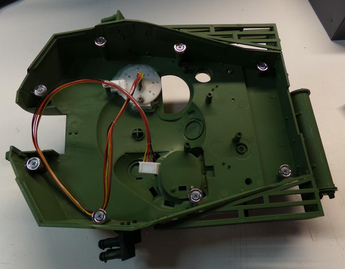

    I only removed the "rim" from the bottom post. The top post was shortened to make room for both magnets.
    I have been looking at my Pershing for 3 days and still couldn't figure out a good way to attach the magnet to the lower post except using CA glue. The hole on the magnet is for M3 screw which is too small for the pre-drilled hole on the bottom post. The long bottom post also exclude the use of machine screw and nut. Your tip on this?
  • tank_me
  • keilau
    You can see from the pic mine are completely flush fitting with each other once installed. In the second pic it shows the lip on the bottom that gets removed (says "make flat").
    It sounds like that you do not remove any material of the top post. The magnets total 6 mm can flush fit with each other when the bottom post is made flat?

    Thank you for sharing. Very, very helpful information. I assume that the counter sink part will face each other so I need half in N pole and half in S pole. 25 pieces of each kind are $30 total with free shipping. Can you confirm that. (The polarity part.)
    I found similar neodymium magnet at Amazon for much cheaper. Not knowing how good they are, I decide to get them from your supplier. I know that those magnet you got work very well.
    As others have said, yes the countersunk heads of the screws then mate up with each other. I bought mine from JC in bulk (like 50 of each pole north and south) because they get cheaper the more you buy and I knew I would use them on a bunch of tanks. That purchase has magnetized the Bulldog (body and turret), Pershing (body and turret), IS-2 (turret only), T34/85 turret, Hooben ZTZ-99A (body and turret), HL ZTZ-99 (body and turret), and the T-72 turret so far. I still have some left. Can you get away with using less magnets than I do? I'm sure you could, but I like to make sure I have solid connections. Most of my tanks are pretty heavy and I can lift the tank by the magnetized upper hull without them separating. The closer and flatter the magnets fit together, the stronger they hold. I like connecting them with screws rather than CA glue or epoxy so that I can remove them if one breaks and they don't come off during use. I have some other magnets that are epoxied or used CA and it seems there are a few of them I'm always having to reattach. I only shorten the upper screw boss and the great thing is that if you accidentally cut off too much, you can install a washer under the magnet to fix it.

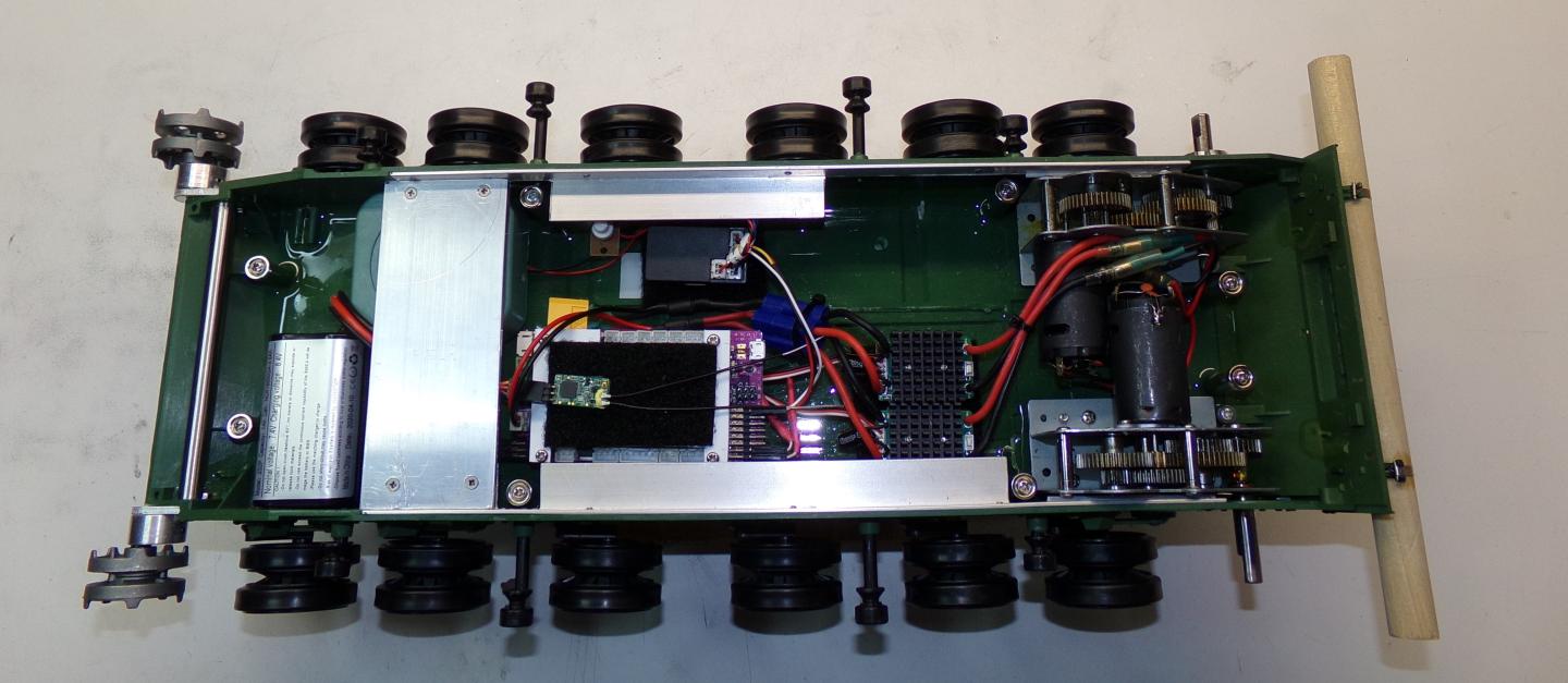

    Nope. Velcro'd to the bottom of the tank on the inside where ever I want since the battery box is gone. The tank top is connected using magnets. This is an example (my HL ZTZ-99) of a battery box removed resin poured bottom hull with magnets installed on the posts that hold the tank together and the battery mounted in the front to offset the weight in the back. The second pic shows where all the magnets were installed. I always remove batteries to recharge my tanks.

    I don't care that they don't fit in the stock battery box as I normally cut the battery box out and pour resin in the bottom of my chassis to stiffen it up after removing the battery box. I then use velcro on the battery and on the bottom of the tank to hold them in place.
