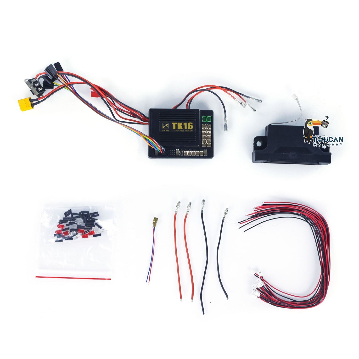

    TK16 MFU:
    Difficult to tell the sound sets this one has. I've seen some vids where the sound sets are better and others where there is no real difference. This one is supposed to match the stabilizer (per Toucan) but appears to need a separate RX in the tank, needing an entire radio system. This one also appears to not be limited to servo outputs, but can work with the original equipment in a Heng Long tank out of the box.
    The Package Includes: The package option is selected by yourself We have a wide range of 1/16 RC hobby tank parts, you almost could find most desired accessories on market from us, and we had refited a variety of rc tanks for our customers. If you have any questions, welcome to contact me.

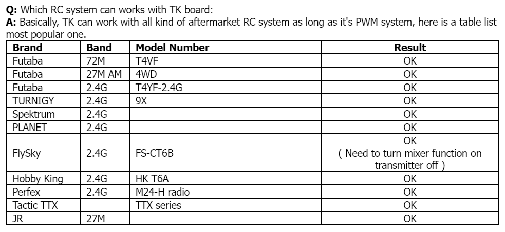

            I had issues getting my FrSky Q X7 to work with my Clark boards so I have switched over to the Flysky FS-i6S and had zero issues. Another person on the UK forum had issues with the Turnigy version of the FS-i6S because the firmware is slightly different than the Flysky version. These are known incompatibilities with Clark boards. This is a list from Clark's website that he says works.

              tank_me, so you do like that FlySky FS-i6S radio?
              It seems with the support, and knowledge, the Clark boards might be the way to go for added function and better sounds. I see on the Clark site that there is an option for the Gun Barrel Stabilizer as well. It would be awesome to have an easily searchable list of the sound sets that these boards have for each tank model they support... I am thinking my Pershing is a good candidate to go through a conversion.

                I would say it's not a high end radio, but it doesn't have a high end price either. For the price it has a nice heft and feel. Battery life is pretty good also although it is AA battery driven. I haven't used rechargeables in mine, but I may try them in the future.
