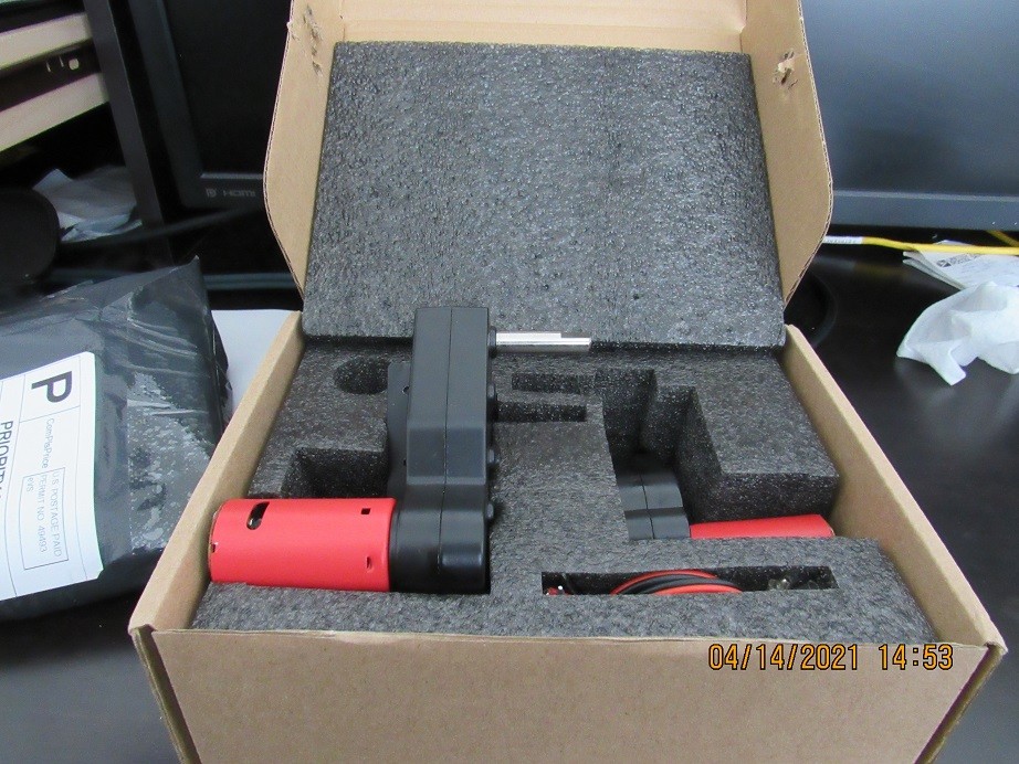

I highly recommend that you get the Heng Long red motor from Toucan Hobby to avoid complication in your upgrade. If you have the original Heng Long sleeve bearing steel gearbox, you should consider upgrading to a ball bearing gearbox.

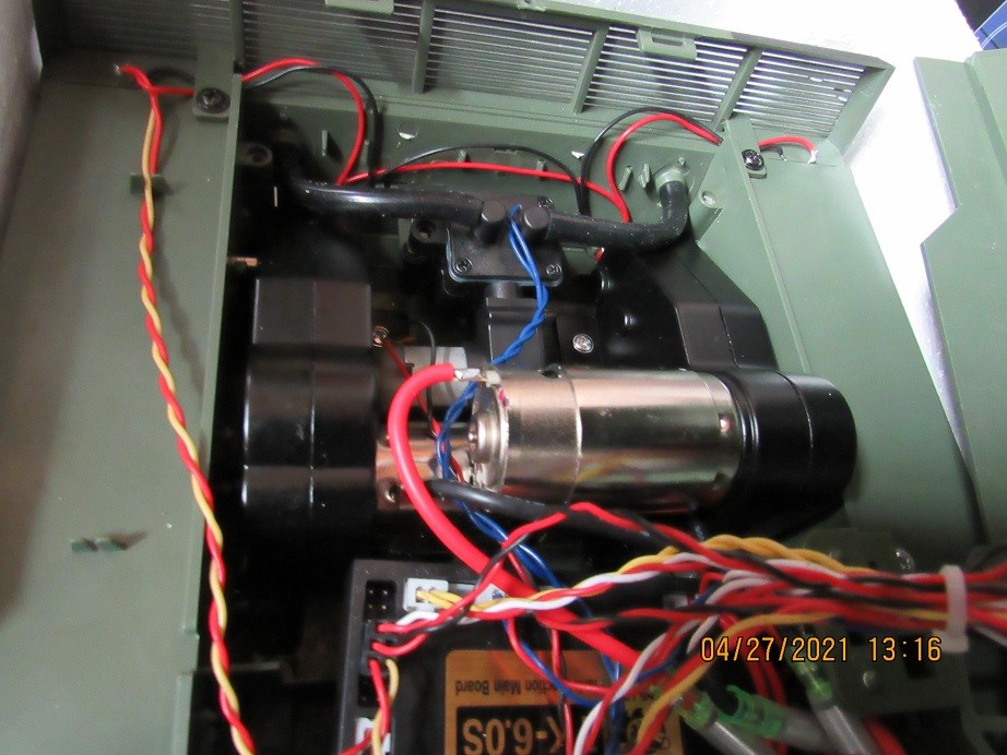

Some example of my motor, gearbox upgrade for the German Leopard 2A6

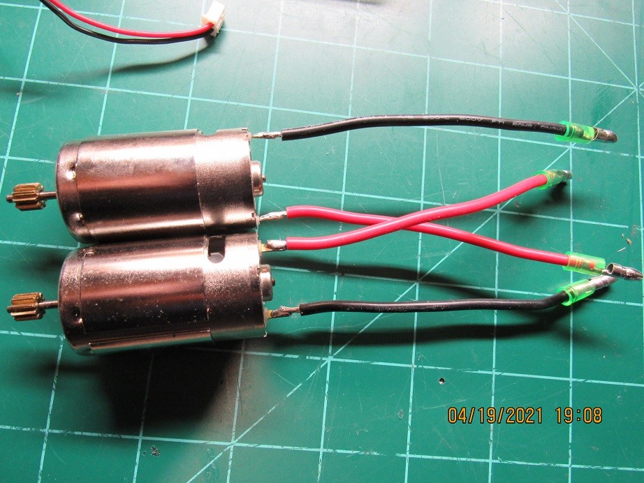

I have not done the same investigations as Keilau. I can say though that since fitting red motors, and gearboxes with bearings, my Challenger is faster, quieter, has a lot more torque, and runs cooler that it did with the 380 motors. As an aside, one set of motors came with bullet connectors, and a second set came with plugs. These were replaced with with bullet connections by soldering on the old wires.

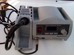

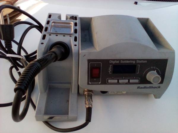

The amount of soldering required on a 1:16 scale RC tank is fairly limited. I have a Radio Shack Digital Soldering Station (Parts 64-053) that served me very well for the last 15 years. A Google search found it and many similar unit for less than $40 which is a fraction of what I paid then.
The important factor in small spot soldering is to use 60/40 rosin-core solder. Soldering is easy if the solder flows easily.
