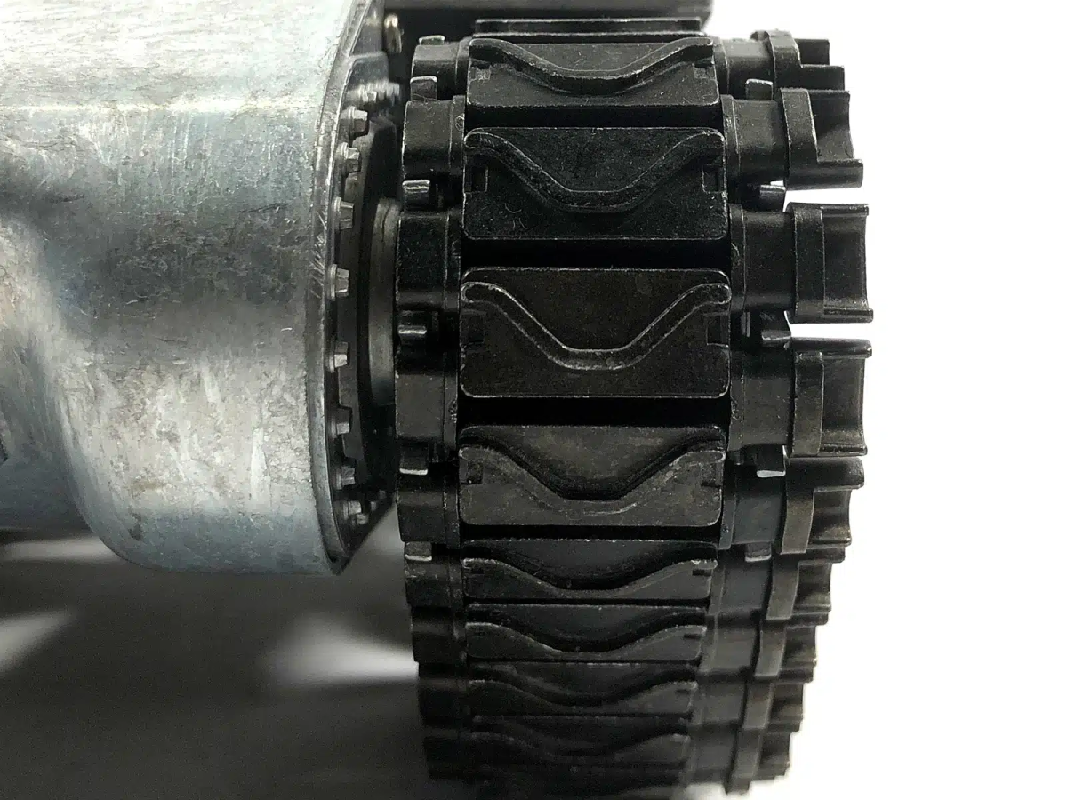

      Duckbill is the last to be added. I use the T74 with duckbills.

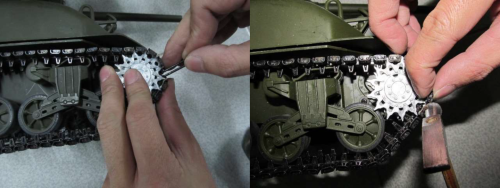

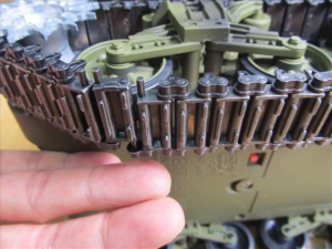

      Click image for larger version  Name:	image.png Views:	0 Size:	995.1 KB ID:	399698 Click image for larger version  Name:	image.png Views:	0 Size:	955.7 KB ID:	399699
      Pictures from older Mato picturial instructions. They may or may not be applicable to your newer T49 metal track with duckbill. PM me with your email address if you want copies of them.​​ You may be able to get more up to date support from the Mato distributor in Canada.
