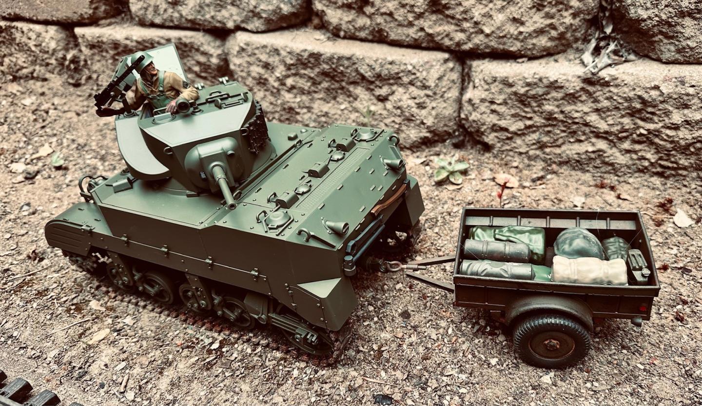

          To complicate things a bit, I added a "Willys Bantam" trailer from Cults3D (or Thingiverse, I don't remember which). No backing up, no spin turns! I inserted a music wire hook onto the real one to secure the trailer.
          No decals yet, therefore no weathering on the tank. I'm negotiating with "Company B Miniatures" to see if they'll enlarge some smaller scale M5 sets. Very expensive, but nothing's too good for baby!
