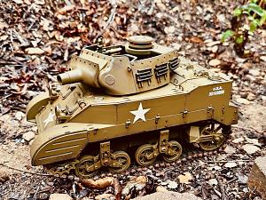

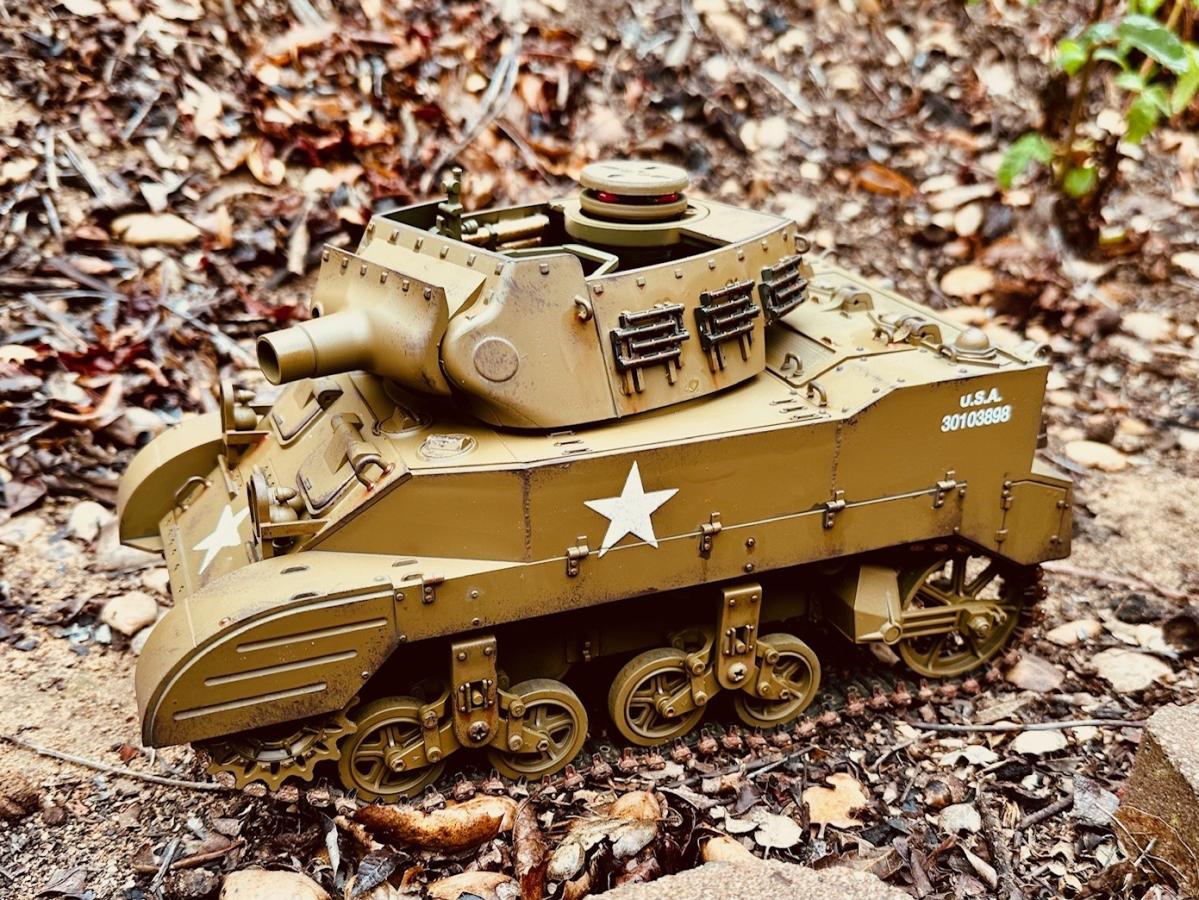

                        • The M8 was an easy conversion to a Heng Long 7.1 battler. Install new or replace the connectors to fit. IR in the barrel, IR receiver on the MG tub.
                          Click image for larger version  Name:	M8 Scott 04.jpg Views:	0 Size:	243.8 KB ID:	448744
                          The M5 will be harder in one respect. The turret is more confined, and the IR emitter location will be problematical. I put the IR receiver on the left hatch. Picture later.
