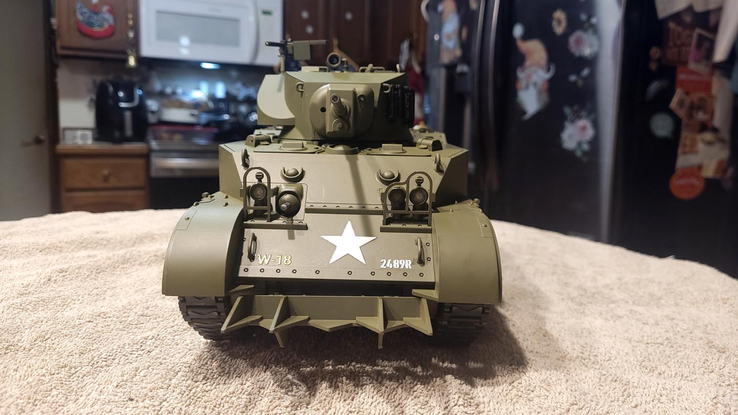

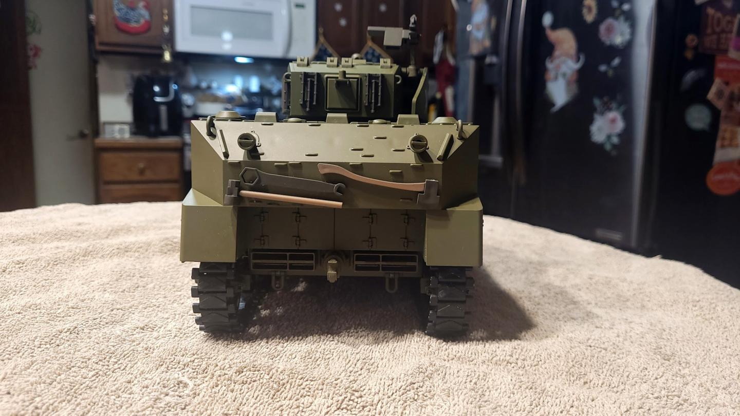

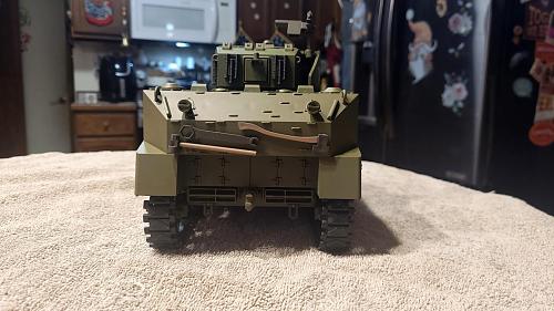

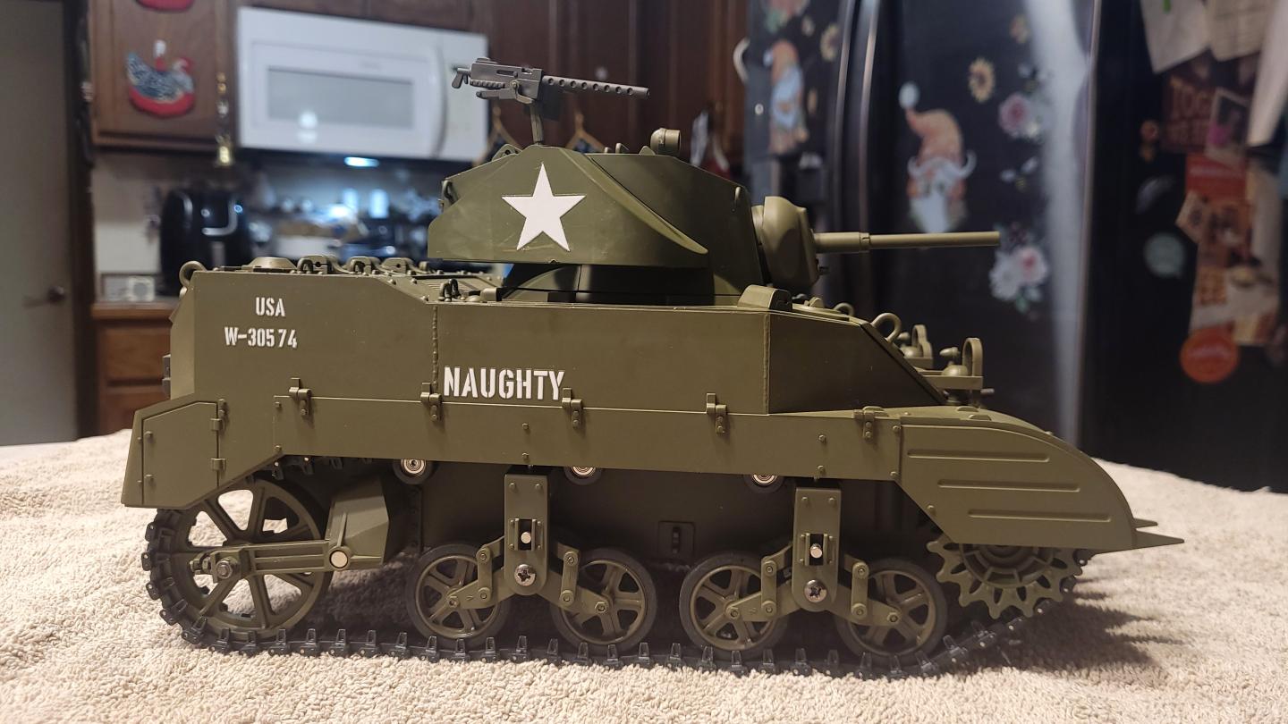

  • Came a day early, pretty much as I expected it to be, gave it quick out of box test, everything works including smoke. The speed and handling are what I was expecting from other's experience, but my overall first impressions are positive given I had a clue what t was buying thanks to others experiences. I really like the radio compared to the HL/Tongde, enough that I not keen on replacing it with the HL 7.1, guess we'll see how I like the running as is once I get used to it more than anything. The recoil is nice, seems synched better than the HL system I've seen.
    • It's great tank for the price.
      Yours is the first one I've heard of that had the smoke work out of the box.
      Nice video. Don't forget to take the tape off your headlights btw.
      Steve. 😀
      • Didn't even realize it was tape, figured it was paint like the HLs always have, thanks ")
        • yup, it's a snowmobile
          • Having ridden in an M5 during a reenactment years ago and know how fast they can go and smelling the rubber pads burning driving down the street,I have to say I never thought I would see a Stewart drifting lol
            • I'm sure it's my superior driving skills and not the fact that all the weight is up front so it spins on a dime...
              I did manage to stop playing with it long enough to get get all the detail parts installed and removed 1 link from each track, I think that actually snugged it up a bit too much, definitely preloading the front bogies a bit.
              It's also a bit annoying that the motor/transmission noise is louder than the sound.
              At some point this winter I'll pull the top off and have a look around and see what I can address. Definitely not disappointed with it, amused would be a better word ")

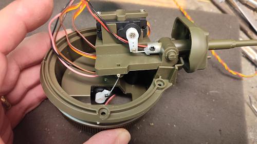

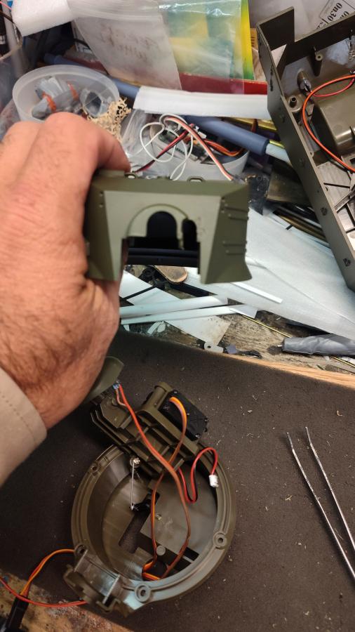

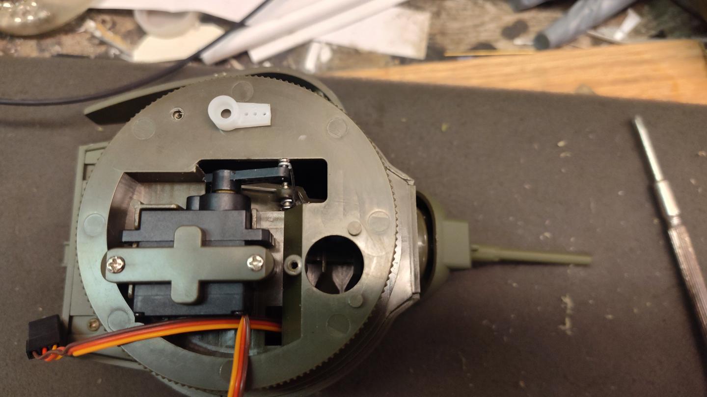

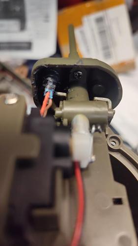

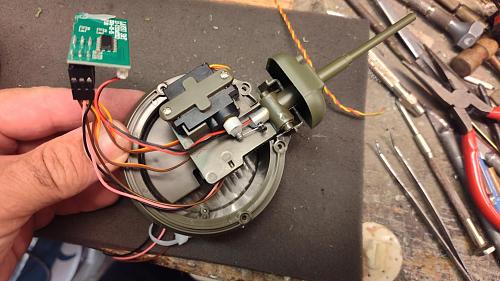

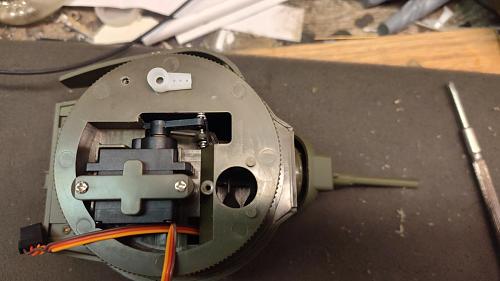

                      • Question for those who have delved into the interior of your Coolbank tank: What is the secret of the turret? Specifically, I want to get inside it, but I see what appears to be a ring of loose ball bearings where it meets the hull. Anything I should or shouldn't do to get past that point? TIA.
                        Right now I'm troubleshooting a balky recoil linkage on Coolbank's Crusader Mk III, but I imagine the design is the same.
                        For anyone who hasn't examined their Coolbank interior, I see a clever system for the turret rotation. Instead of a Heng Long ring gear on the turret and a gearbox running it, Coolbank has a servo with a rubber wheel running against a finely ridged turret cylinder. This means if you turn the turret by hand, or for instance bump it, there is no gear or gearbox to damage, it just slips.

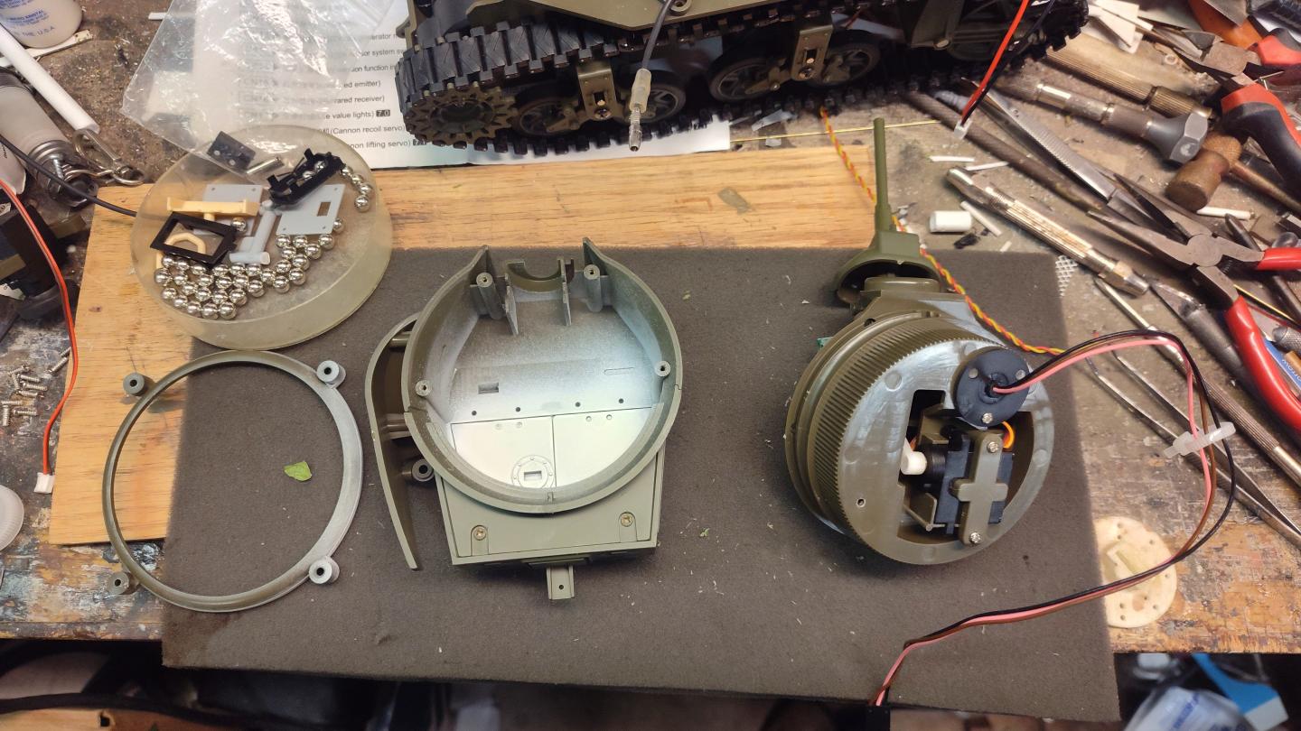

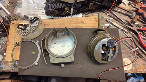

                        • One screw holds the bottom of the turret to he top of the turret. The bottom stays in the hull, unless you take apart all the stuff holding it and the ball bearings in the hull, like I did… which I can’t recommend.
                          So, take the upper hull off, find the one screw that holes the top of the turret to the bottom and remove it. You will also have to remove the servo linkage for one servo, elevation I think it was. Then the top comes out of the bottom.
                          then you can work on it but you will have to put the top and bottom back together to make a new servo linkage and hook up the arm.
                          Taking the bottom of the turret out with all those ball bearings just sucked.
                          • Thanks, I knew I could count on you! Makes so much more sense to have that one screw than removing all those ball bearings. It's actually the Crusader I need to get into.
